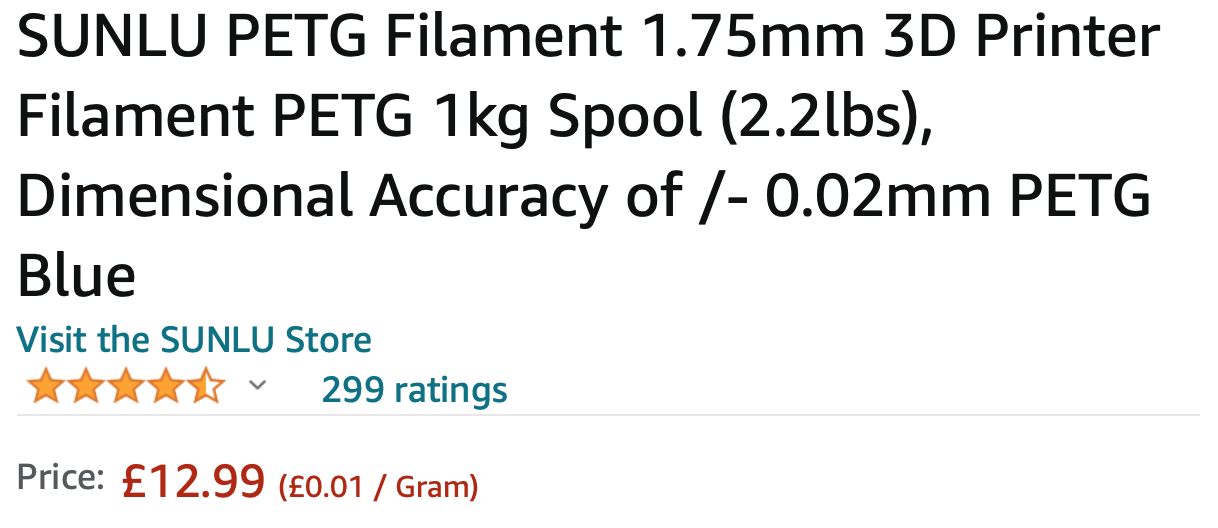

Hi guys,
I know it's been asked before by me mainly
but is PETG filament stronger than PLA and does it need higher heat settings on the extruder and bed. Amazon are at the moment doing a cheap roll of the stuff and I am in two minds on getting it. Is it worth getting or shall I just stick with PLA for which I am very happy with.

I've never used Petg myself but Rik did a lot of work on it some while back and I think he came to the conclusion that it is more hassle than its worth unless you have a very specific reason to use it ( correct me if I'm wrong). So, unless you want to get involved in the work discovering the appropriate settings, saving a couple of quid would be false economy IMO.

Thanks Phillip,
On reading Rik's thread's on working with PETG, I am going to leave it. Your'e correct about saving the few pounds against all kinds of possible trouble trying to print with it. So I am going to stay with PLA, haven't tried PLA+ though, so may have a go with that and see how it is.
I am also thinking of getting a resin printer, but not being able to do the fantastic drawings you and others produce are leaving me with doubts about one. I know they produce far better results, it's just getting the correct settings right I suppose. Do you need to change things for different builds, or do you just leave well alone.
Anyway, thanks again Phillip for your reply, it as saved me a lot of messing around.
