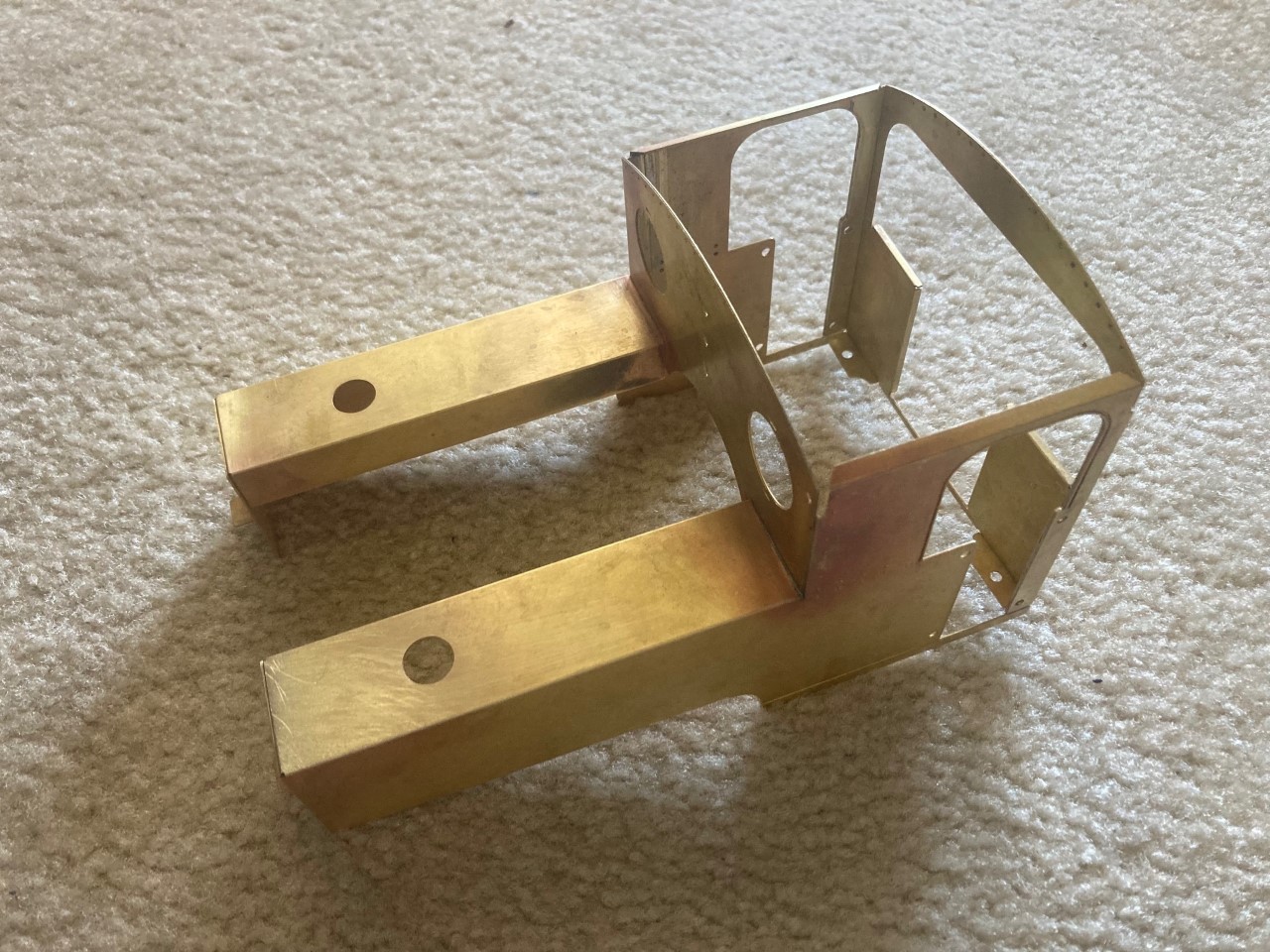

I think I’ve discovered where I went wrong, from looking at photos on internet (and you can just about see the solution on the Roundhouse photo, from the back, posted above).
It looks like the hinges aren’t supposed to be flush with the inside of the cab walls; they need to ‘float’. This will keep the ends of the hinges inside the flange that I was having problems with. When they say that these bolts should be ‘slightly loose’ they actually mean very loose.
I’m not sure I like the idea of the roof being that wobbly, but I can probably secure it a bit more by placing some packing washers between the inside of the cab wall and the outside of the hinge slots. This will hold the roof in position but will still allow the hinge ends to clear the flange.
The slight material removal really isn’t very noticeable face-to-face, but I have emailed Roundhouse to see if I can get a replacement cabin front piece so that I can re-assemble it and try again.

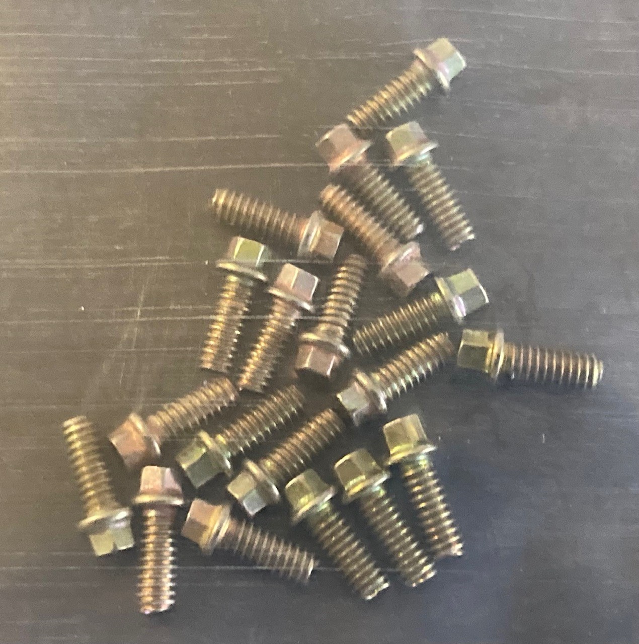

I did order some little hex head bolts (the ones in the photo are M2) which I plan to use instead of the Roundhouse cheesehead ones. And I couldn't get any cleanser without bleach locally, so I ended up ordering this 3m cleaner which has now arrived.

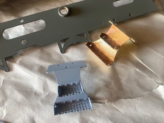

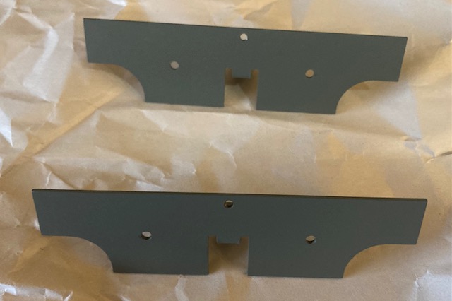

This isn't my first time spraying, but I usually paint composites so metal is all new to me!

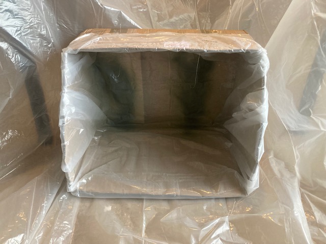

I started by making a small spray booth out of cardboard box (the one that the loco was delivered in
) with a drop sheet plastic insert.
The buffer beams were sanded with 500 grit wet and dry, then cleaned with the 3m cleanser and rinsed; these were then primed with the Rustoleum etch primer and baked at 180f for 30 mins.
I'm not sure if it makes any difference but I noticed that the Rustoleum primer doesn't mention acid etch, so I have ordered some U-POL #8 for the brass parts, but this should be fine for the chassis.
So far so good; now I just have to check that the Rustoleum primer is compatible with the Scalecoat 1 top coat (when it arrives).

Though the spraying looks good, a word of warning about using a small box as a spraying booth. As you spray inside the booth, the air inside has no easy escape, the the spray volume could then you circulate as opposed to coat the surface - difficult to explain, but the spry mist has a problem penetrating in to the booth. A larger box is the solution which front area is larger than the spray mist
siclick33
- Posts: 67
- Joined: Thu Apr 07, 2022 3:00 pm
Re: Newcomer Roundhouse Billy Build
Thanks for the reply.
It might not be clear in the photo (and it might not entirely guard against what you are saying), but I have made little hangers that poke through the top of the box and the buffers weren’t at the back/bottom when they were being sprayed. I didn’t have any problem getting the paint onto them (in fact, they were being blown around by the force of the spray!
I will certainly bear this in mind when spraying the body though.

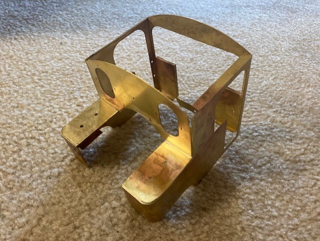

The new cab front has arrived, although the box looks a bit big. It almost looks big enough to have a Katie kit in it
I have removed the old cab front and soldered on the replacement. I'm a little disappointed as it's not as tidy as it was before, but it will do. Roundhouse confirmed that they have also experienced the 'problem' that I had with the hinge fouling on the inside of the cab front. Their solution was also to bend the end of the tabs, but the bit I missed was that this can only be a tiny amount or it will prevent the roof from lifting. I have another thought on how to make this neater and I will see how it works when I put it all together.

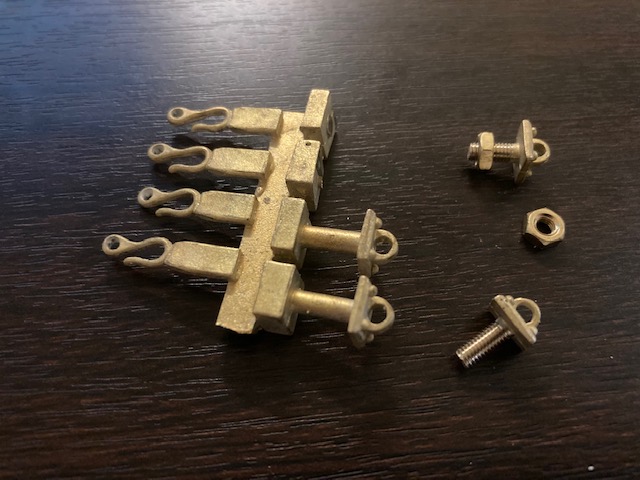

I had also purchased some decorative safety chains from SwiftSixteen. The instructions call for them to be soldered or glued in place. However. the stem of the casting looked quite close to being suitable for cutting a M3 thread, so I gave it a go and it seems to have worked. I will try to use these instead of the M3 bolts that came with the kit, to bolt the buffers and buffer beam overlays on.

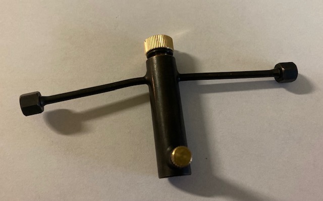

I have used the Brass Black on the lubricator. I'm not sure how durable it will be, but it looks pretty good.

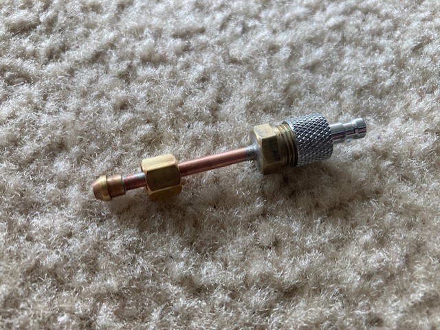

The fitting that screws to the loco and the pipe were bought from Roundhouse. The 1/8 BSP brass fitting was bought from ebay and drilled out to fit the tube, and an Iwata quick disconnect was added so that I can attach it to my compressor airline hose without having to unscrew anything.

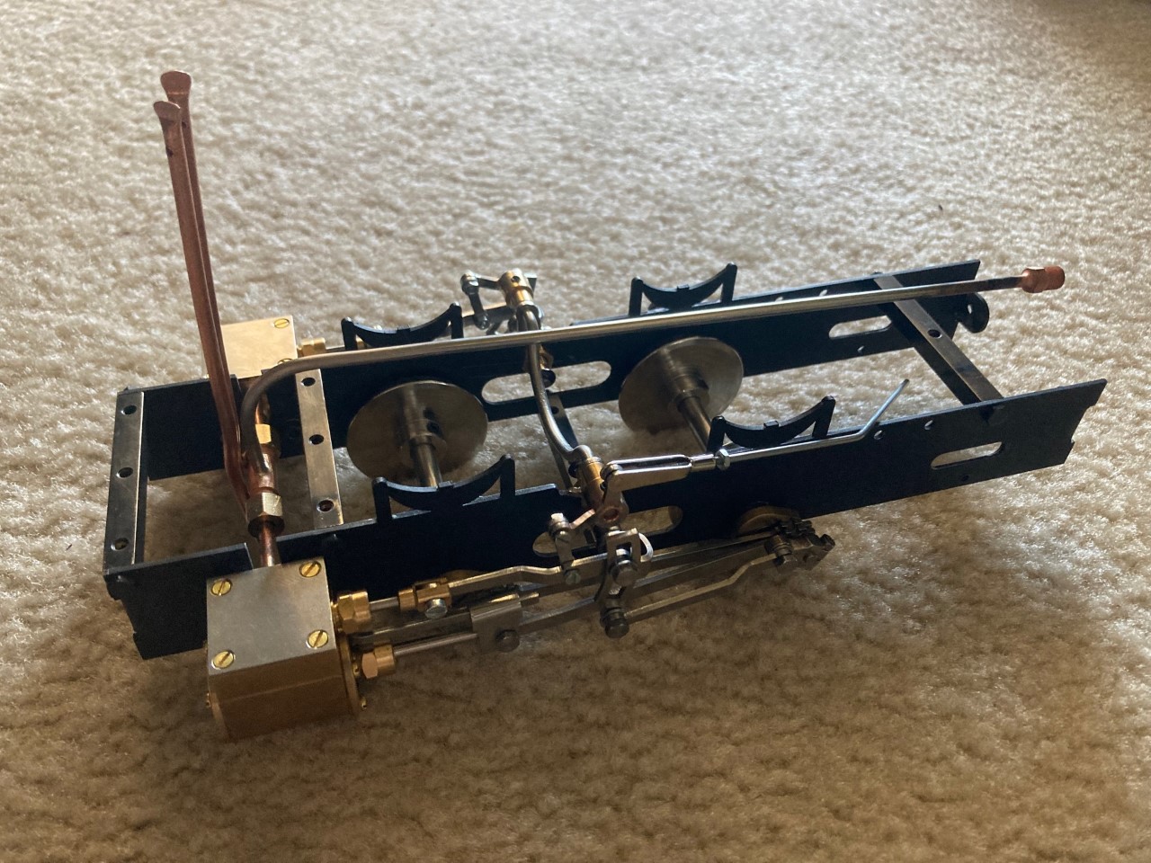

I have tested it on air and it does run, but I'm not 100% sure about the valve timing. Once I've got the boiler on and it's running on it's own steam then I'll have another look at it.

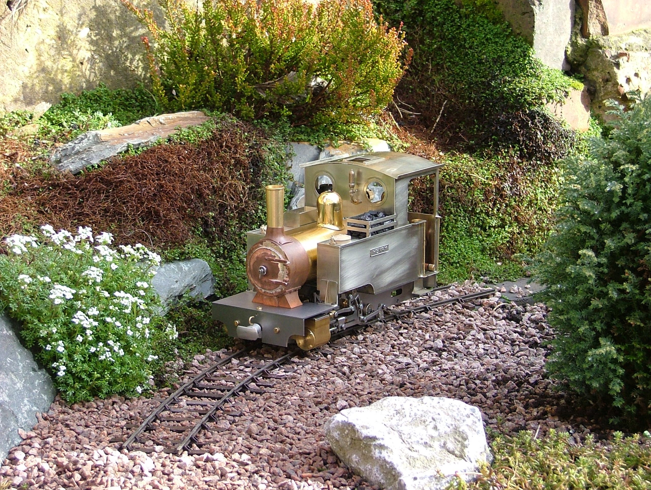

Body soldered, ready for final clean before priming

This is very interesting. Are you building a "George" AND a "Billy"? Or are you building your own version incorporating parts of each? I see you have a "George" body there, and in your picture of the assembled chassis, the weigh shaft is curved, like on a "George" or "Katie". The one on "Billy" is usually straight.

Thank you so much! I was beginning to think that nobody was reading this thread so I popped that in there to see if anyone was paying attentionKeith S wrote: Tue Jul 19, 2022 6:03 am This is very interesting. Are you building a "George" AND a "Billy"? Or are you building your own version incorporating parts of each? I see you have a "George" body there, and in your picture of the assembled chassis, the weigh shaft is curved, like on a "George" or "Katie". The one on "Billy" is usually straight.
I am indeed building a Billy and a George. I was hoping to wait for the Billy to be complete before I started the next one (so I don't get the parts mixed up) but, as the temps here in Texas are ridiculous (and way too hot to paint) I am running out of jobs to do. The George body arrived last week so I decided to get ahead and put that together. It went a lot quicker after my Billy experience; it's not perfect but it's ok.
I think it could be some time until it is cool enough for me to start painting, so I am trying to find things to keep me busy!

Ah-ha, I thought something was going on. I like "George". I have a "Billy" that I made, but have extensively modified to look a certain way. If they'd had "George" at the time, that's the one I WOULD have built.

I like all of the 0-4-0 Roundhouse models but this is possibly my favourite body available for them.
It is a 'Simply 7/8' Henry body. The one in the photo is a bit of a hybrid with a Katie/George boiler but with the Billy smokebox. I think this looks really good so I've ordered the body kit for a future build; this will be a way off yet though as I need to pause a little before I buy yet another Roundhouse chassis/boiler!
