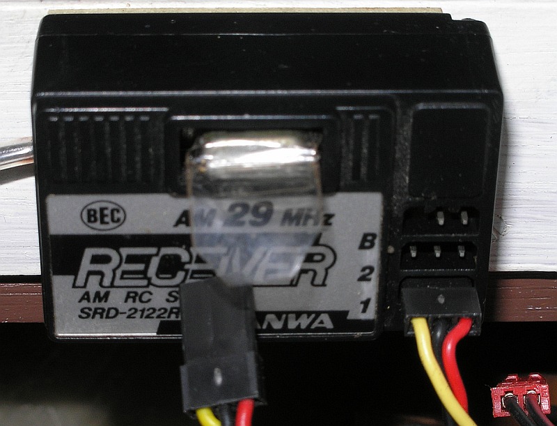

I still run an old Sanwa transmitter in one of my boats. They were always the odd man out so far as receiver wiring is concerned. As my memory is a little hazy, I think if you plugged another brand servo into a Sanwa receiver it blew the servo, but if you plugged a Sanwa servo into another brand receiver it just didn't work but no harm was done. (memory! it could be the other way around) The pic below shows Sanwa Receiver with another brand servo plugged in and you will notice the control wire (Yellow) crossed over in the plug and I think + and - may be different too.
PS this is 29mgs but 27mgs were the same.

The main brands (JR/Futaba/Hitec) and many others have the positive wire in the middle.
And those type of plugs can sometimes be inserted upside down which would put the signal (yellow) wire on the wrong pin.

siclick33 wrote: Wed Jun 01, 2022 4:03 am The main brands (JR/Futaba/Hitec) and many others have the positive wire in the middle.
Ah, it's coming back to me now. You are correct and that's why it doesn't matter because you are only mixing the control wire with the negative one.

As mentioned, these days all brands have the positive (usually red) wire in the middle, with ground (-) and signal wires to the outside. This way, reversing the plug reverses the connection between ground and signal with no harm done other than a non-functioning servo.
In the days of old Sanwa/Airtronics used to put the positive wire to the outside. Should be pretty easy to pull the pins out of the plastic connecter with the aid of an exacto blade and swap them over.
