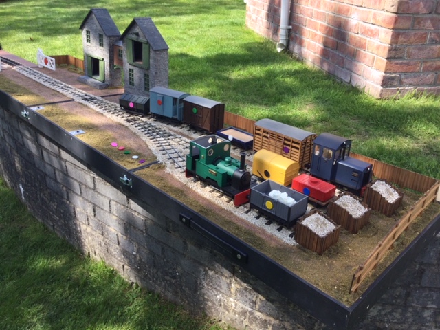

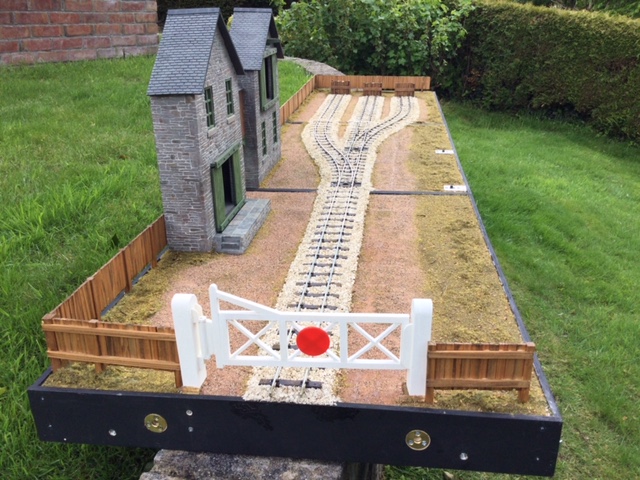

Now my article has appeared in the May 2022 issue of SMT magazine the time has arrived to open a layout thread here.
Yr Hen Felin seen above is an inglenook shunting puzzle layout, something I have thought about building for several years, and which came into existence following my first ever visit to a garden railway show (Llanfair Caerinion 2019). sm32 lends itself ideally to the format as the very tight radius curves available in Peco Set Track allow the layout to be built easily within 2400mm length. The boards are of lightweight construction being based around 50mm Celotex insulation board with 9mm ply edging and pack into a unit with ply ends bolted on. The mill buildings and crossing gate are removed for transport.
The wall on which the layout is sitting was an early building project, and has been crying out to be used to support some trains for many years.

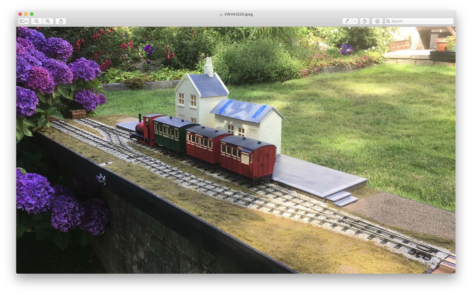

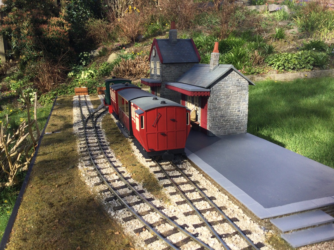

At the furthest convenient point along the wall
can now be found Yr Orsaf Newydd, here shown in an early stage of construction (this photo has also appeared elsewhere within this forum), living up to its name of 'The New Station' (for our non Welsh speakers!).
rather more finished.

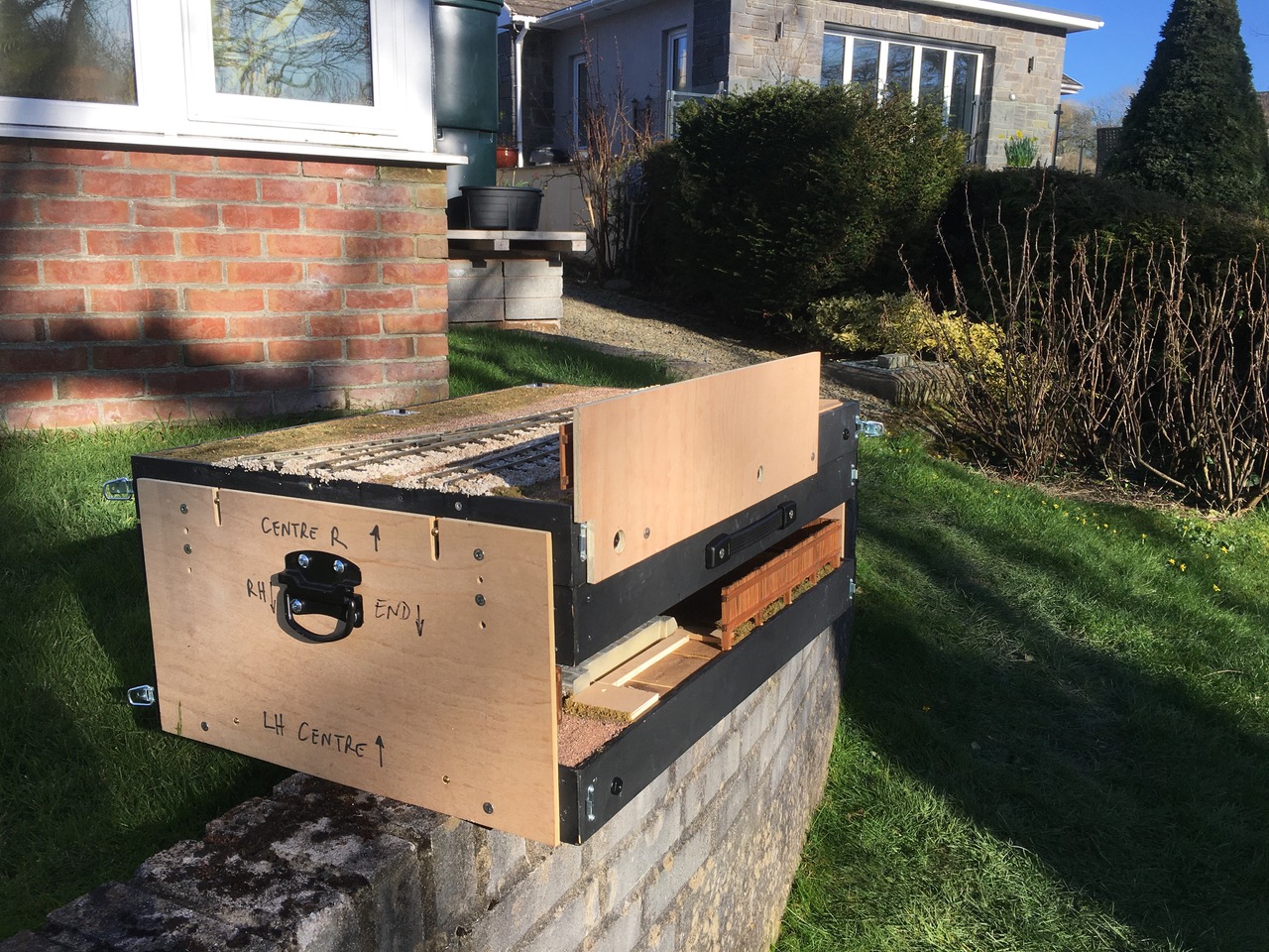

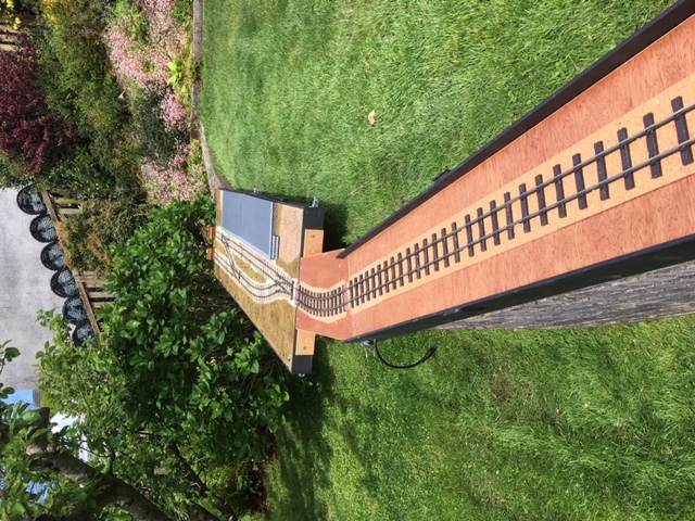

Joining the two separate ends is a simple arrangement of track fixed to 9mm ply boards. There is 16 ft of straight track with a small angle bend in the middle. These two lengths are supported by 8ft section of straight which normally form part of an O gauge portable test rack. Separate box sections with angled ends as required then bolt onto each of the sceniced parts connecting the whole together.
The whole set up amounts to about 35ft long and comes out on sunny days for play.

Though things here are in the wrong places it still shows something of how the shunting game works.
Glaslyn, the blue diesel has returned from a trip to the station at the other end of the line with the train which had been sorted out during the last game, it has run round the train whilst away.
On the centre board are the five counters, drawn at random from a bag, which show the target order to be achieved and matched in the five wagons behind Glaslyn. Whilst Glaslyn was away, Skylark (not quite finished) came from the station and is now trapped. Three wagons which were not selected are placed in the front sidings. The coloured discs are magnetically attached to the wagons which each have magnets inside the body for the purpose. The colours are deliberately varied for interest amongst the younger participants, who do not seem to be confused when one talks of the colour of the wagon in terms of its attached disc rather than body.
There are 6720 possible combinations of five from eight wagons so a repeat game is highly unlikely.

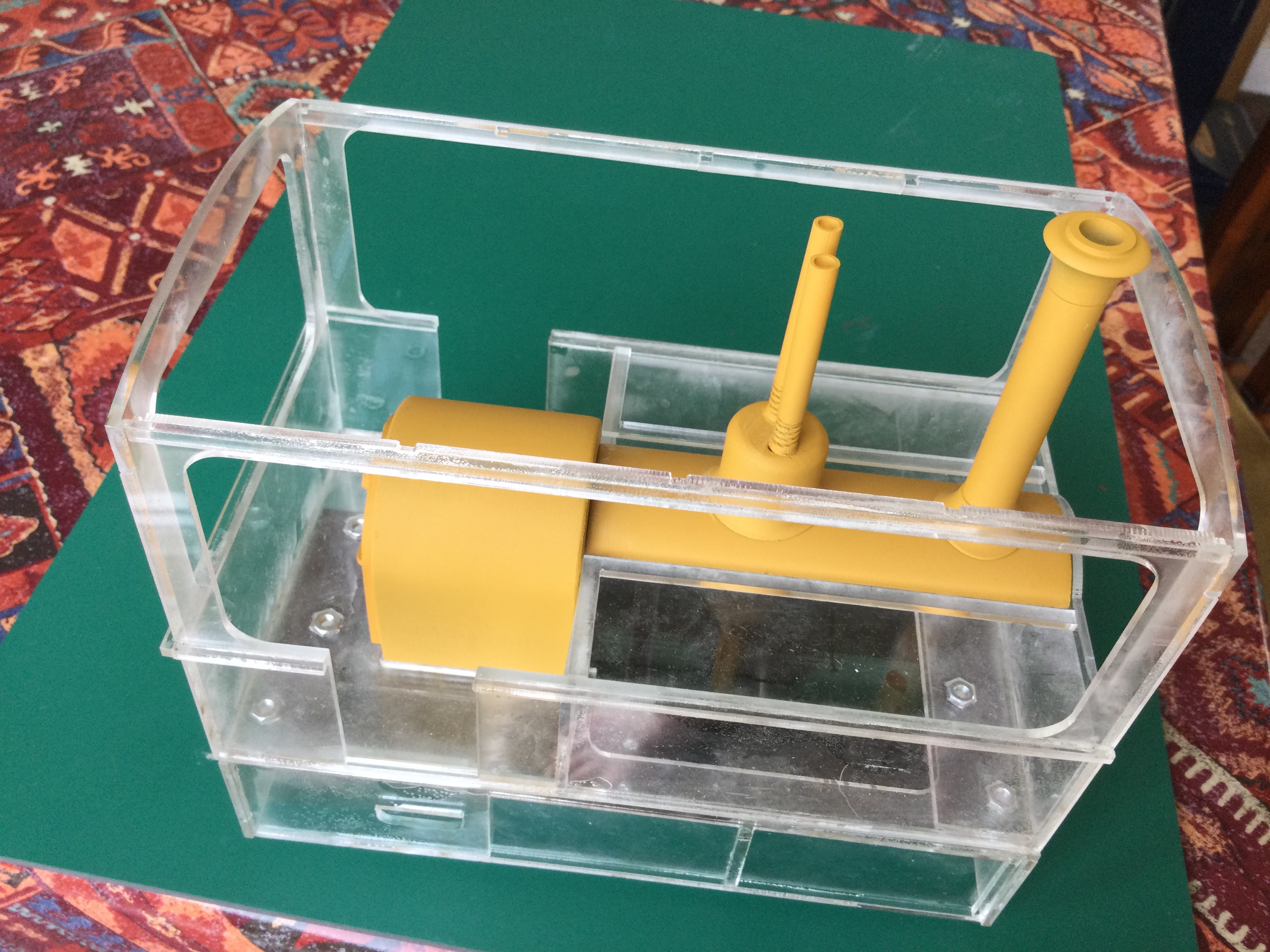

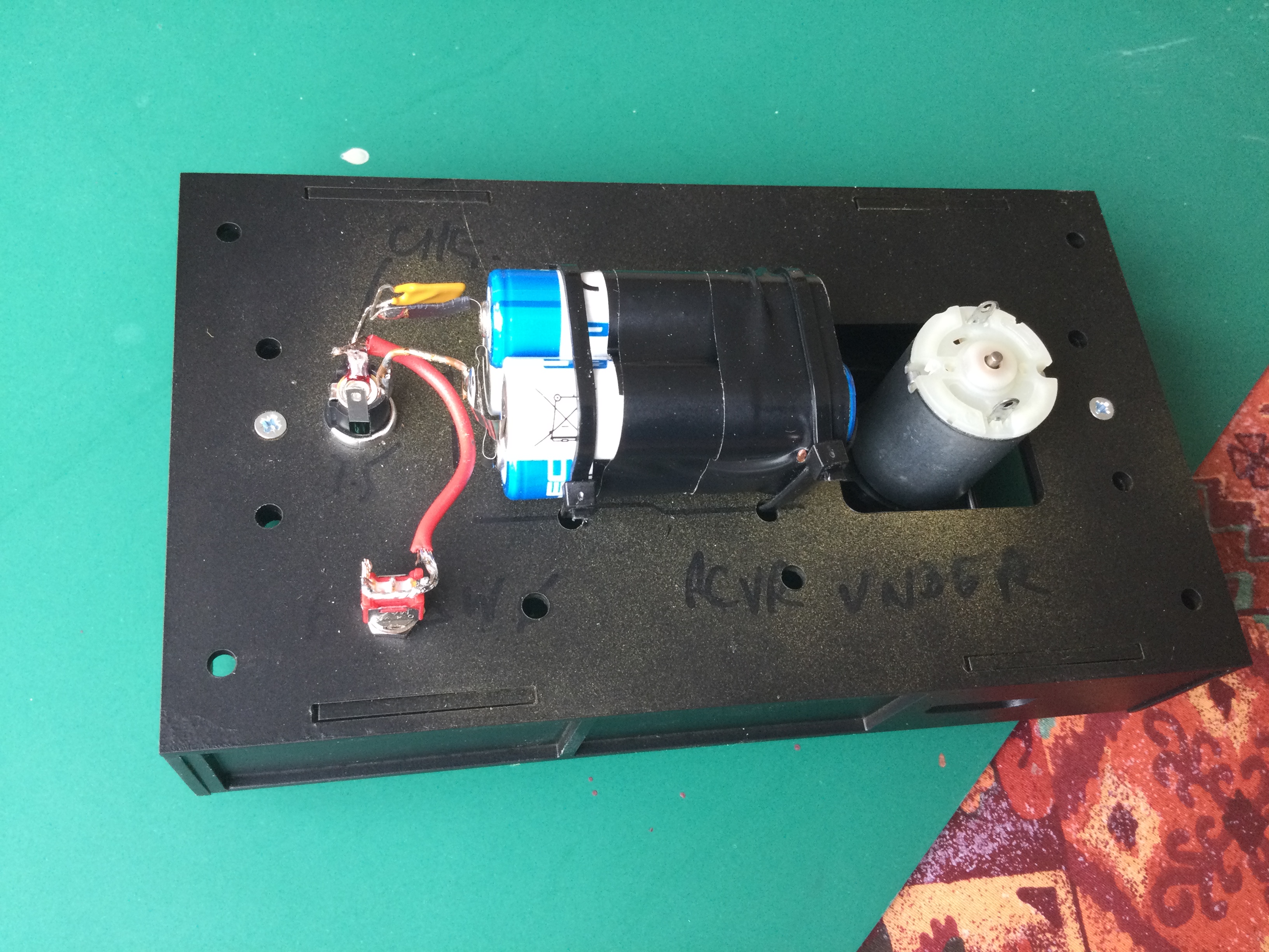

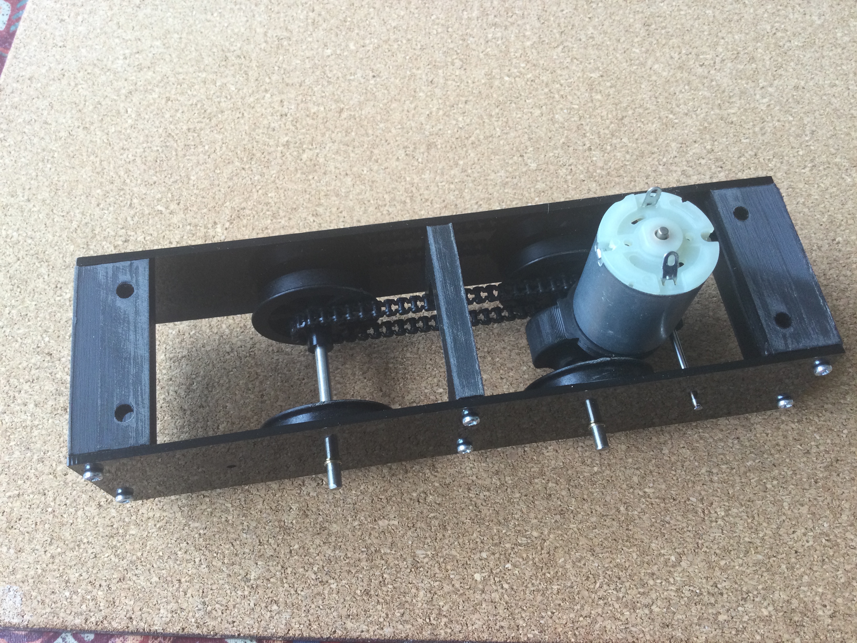

Trefor the Tram
My latest build of a PDF kit, their Arthur tram loco.
First the chassis, a fairly simple matter of screwing together. I did manage to get one of the side pieces reversed end to end so drilled another mounting hole for the motor rod, which for some forgotten reason seemed the simplest way to go.

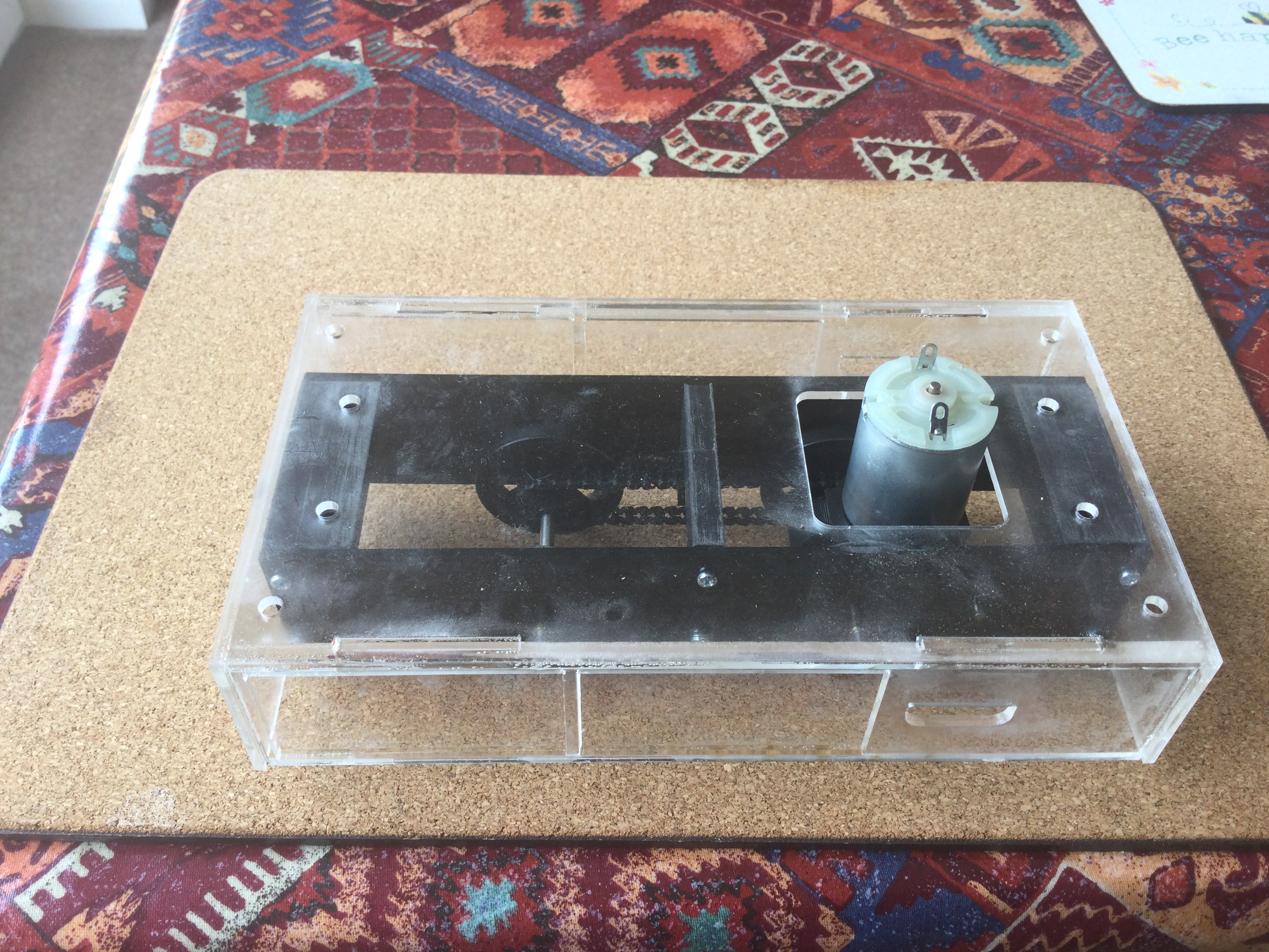

The skirt in transparent plastic placed atop the chassis. The instructions say the skirt should be fixed to the body, then the chassis added. This would mean complication in terms of the electrics so I added a hole into each end spacer so that the skirt would become a fixed part of the chassis. The next picture shows the heads of two m2.5 screws. Also shown are the battery pack, charger socket, thermal fuse and switch. Through the black paint can be seen words indicating that the receiver will be underneath. Temporary connections to the motor showed that it would run.
The switch is SPDT so that the loco will be on when switched to either side of centre. There will be a delay in getting the loco running under radio control as I am waiting for Micron RC to complete development of their replacement for the Deltang item I have used in my previous loco builds.

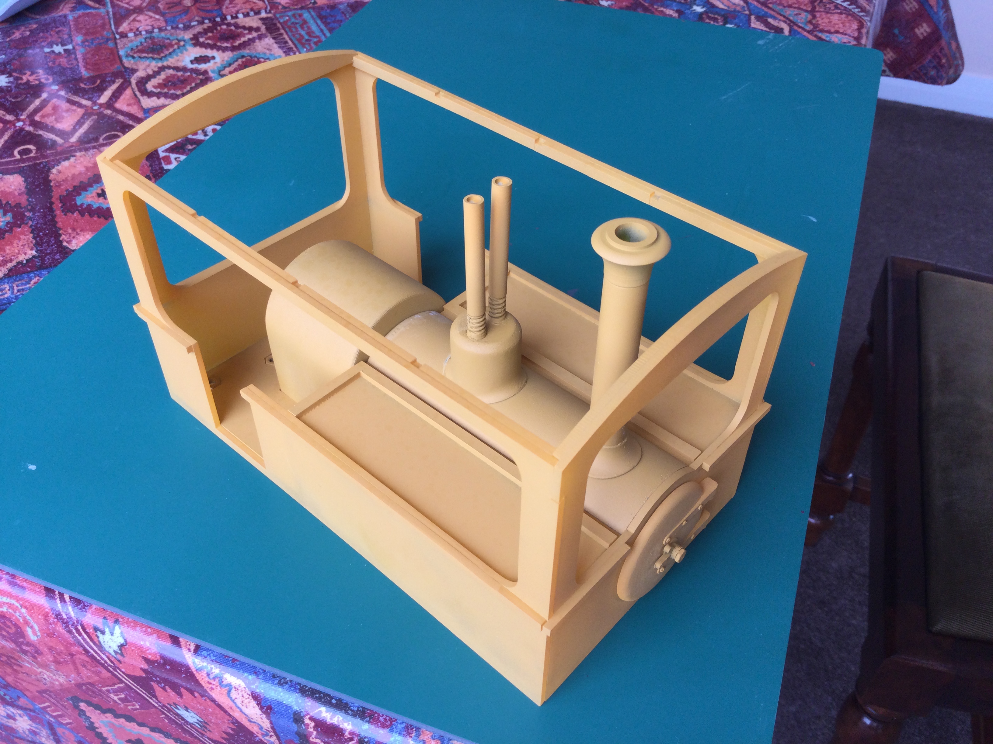

Next the body in transparent plastic with the firebox and boiler top in filler primer. These parts are 3D prints which need a fair bit of sanding to get the print ridges out.
With a coat of filler primer over the whole thing there is immediately a more solid appearance
More to come.

That's looking very good! I actually rather like it in that lemon coloured primer...
You've prompted me to look at the PDF Models website, where I notice they're offering a model of the Kerr Stuart diesel, 4415. I had planned to scratchbuild a (slightly shortened) version of that on the chassis of my RH Hercules, and wonder whether PDF would be prepared to sell me just the body parts to start me off. I don't think I've worked with acrylic before (I think "plasticard" is different stuff?), and would need to modify the kit slightly to fit the chassis - do you think it would respond OK to me attacking it with a Stanley knife?
Thanks,
Thanks,
