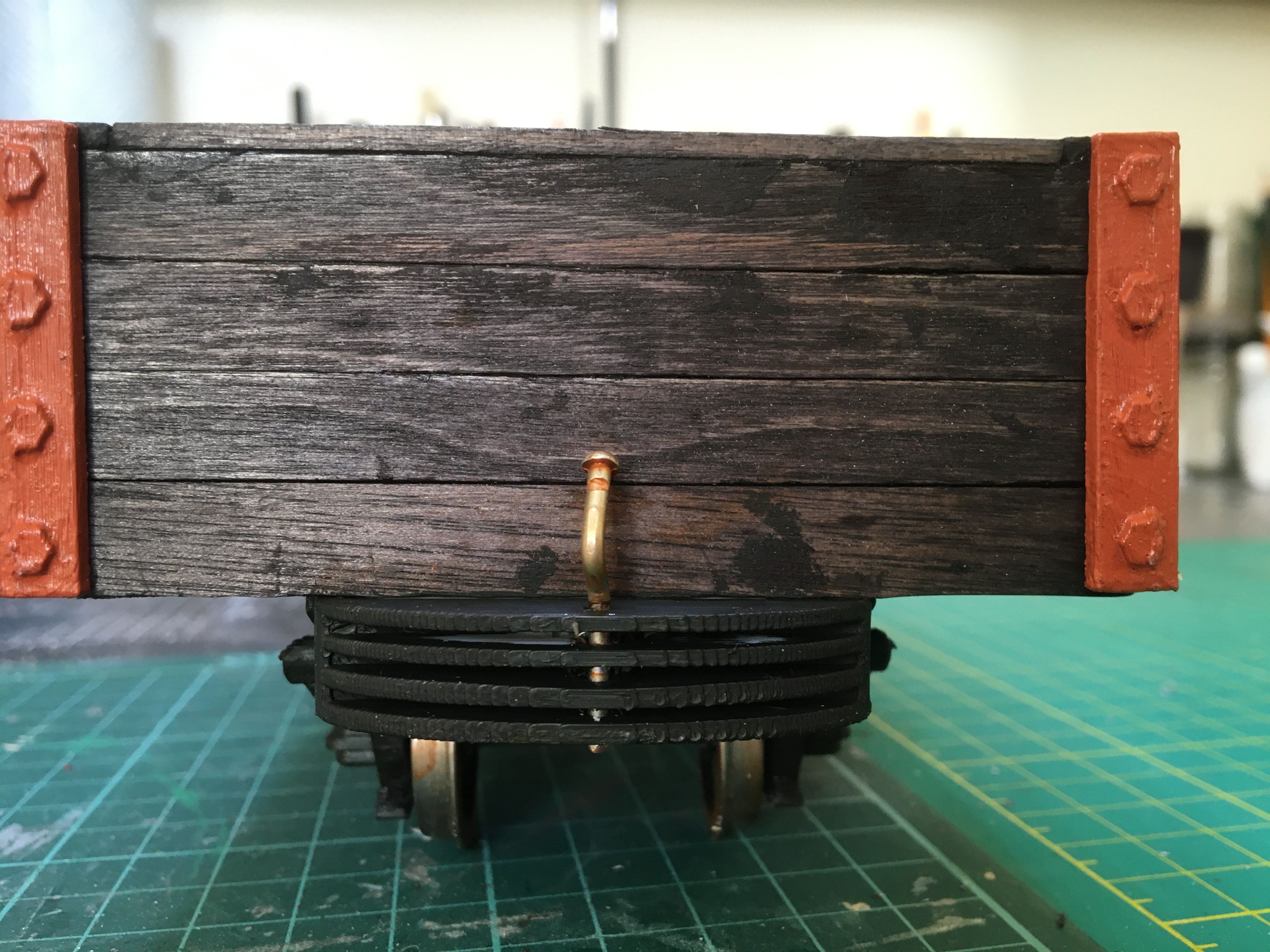

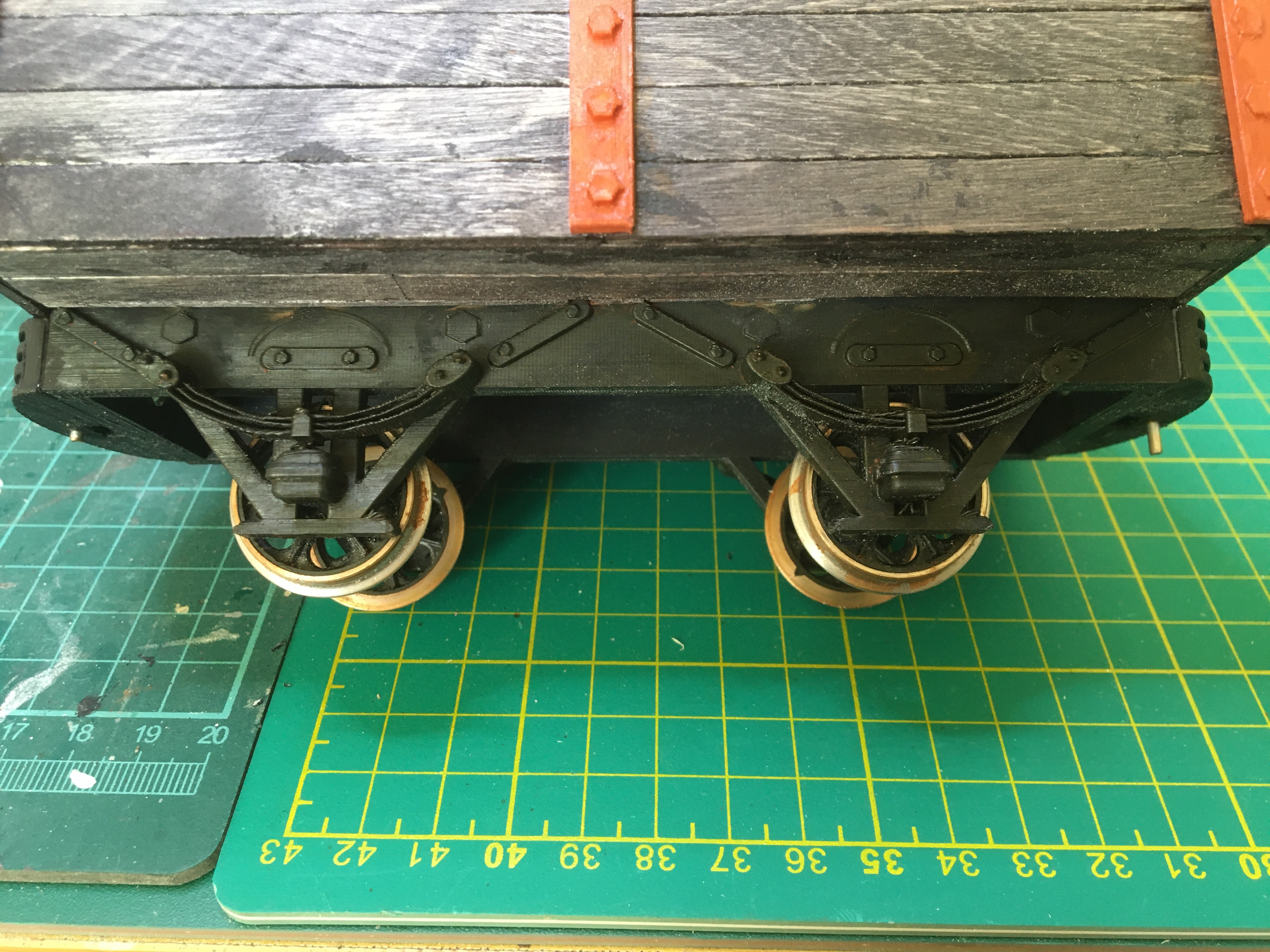

Here is a wagon I have built. The chassis is my attempt on the 3D printer, hopefully it is ok for you guys :dontknow: Then I decided to use some ply that I have and see how it turns out.
Something is wrong, I can't see the photos when I Preview the post :dontknow: :dontknow:
anyway hopefully you can see them. The wheels are some Accrucraft I had bought sometime ago and the rest is all wood or 3D printed. The corner and centre straps are 3D printed so are the buffers. I didn't like them with that amount of space between them, so I have made adjustments.

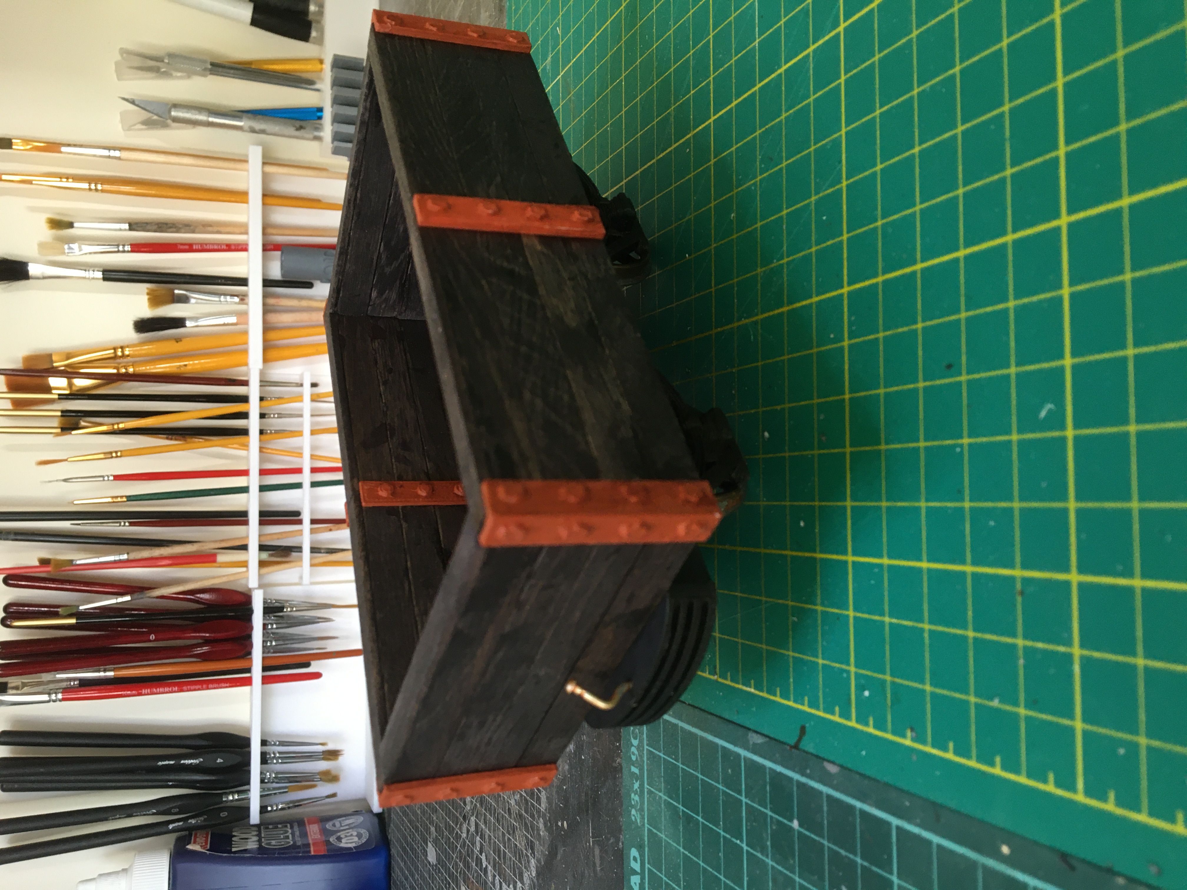

Excellent news to hear from you again Rod, I do like your wagon very much and your collection of paint-brushes puts mine to shame.... I only use cheapo ones and chuck them away when they get tired.

Soory, forgot to say how much I like the wagon - and as Peter says, your paintbrushes are top-notch. I especially like the neat and tidy way they are stored. I have to admit that mine are just shoved (hand down) in a jam jar

Welcome back Rod! Glad to hear you're on the mend.
Great wagon - I particularly like the individual planking and the bolt head detail on the strapping...
I was impressed by the paintbrush collection too! Grace keeps nicking mine for her ceramics work, the ones left in the jam jar leave a lot to be desired...

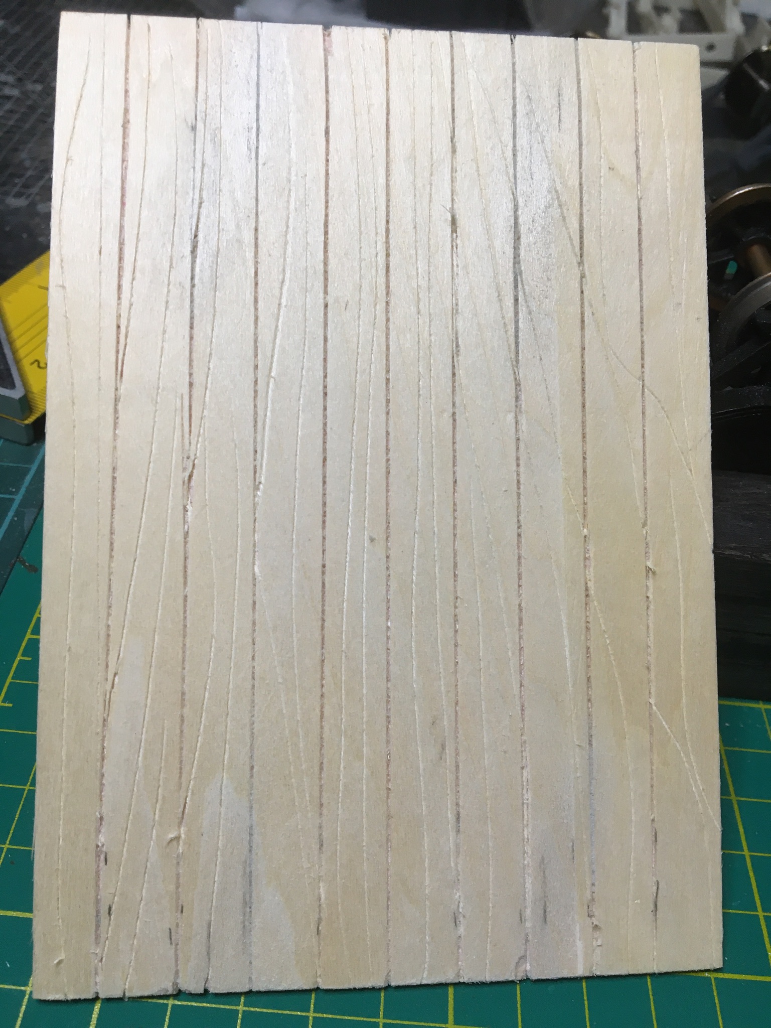

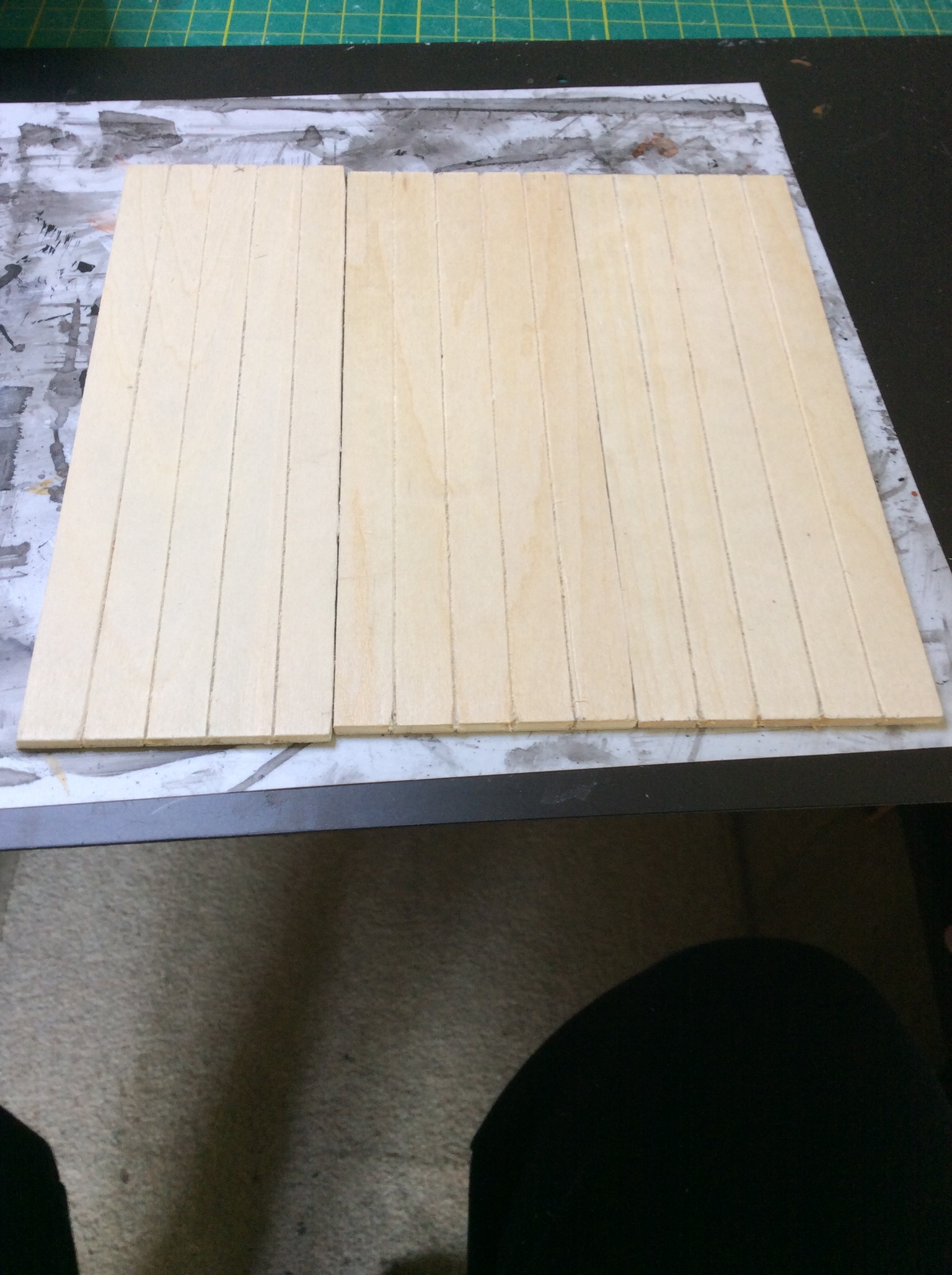

Some more on the scratch built wagons. Here are some photos showing how I made this one. The first photo is a price of ply that is marked out every 10mm and scored with a small screwdriver tip.
It was scored on both sides. Then I did the sides and front and back of the wagon. I did do the front and back as one piece and then cut it in half. It's easier to score a bigger piece.

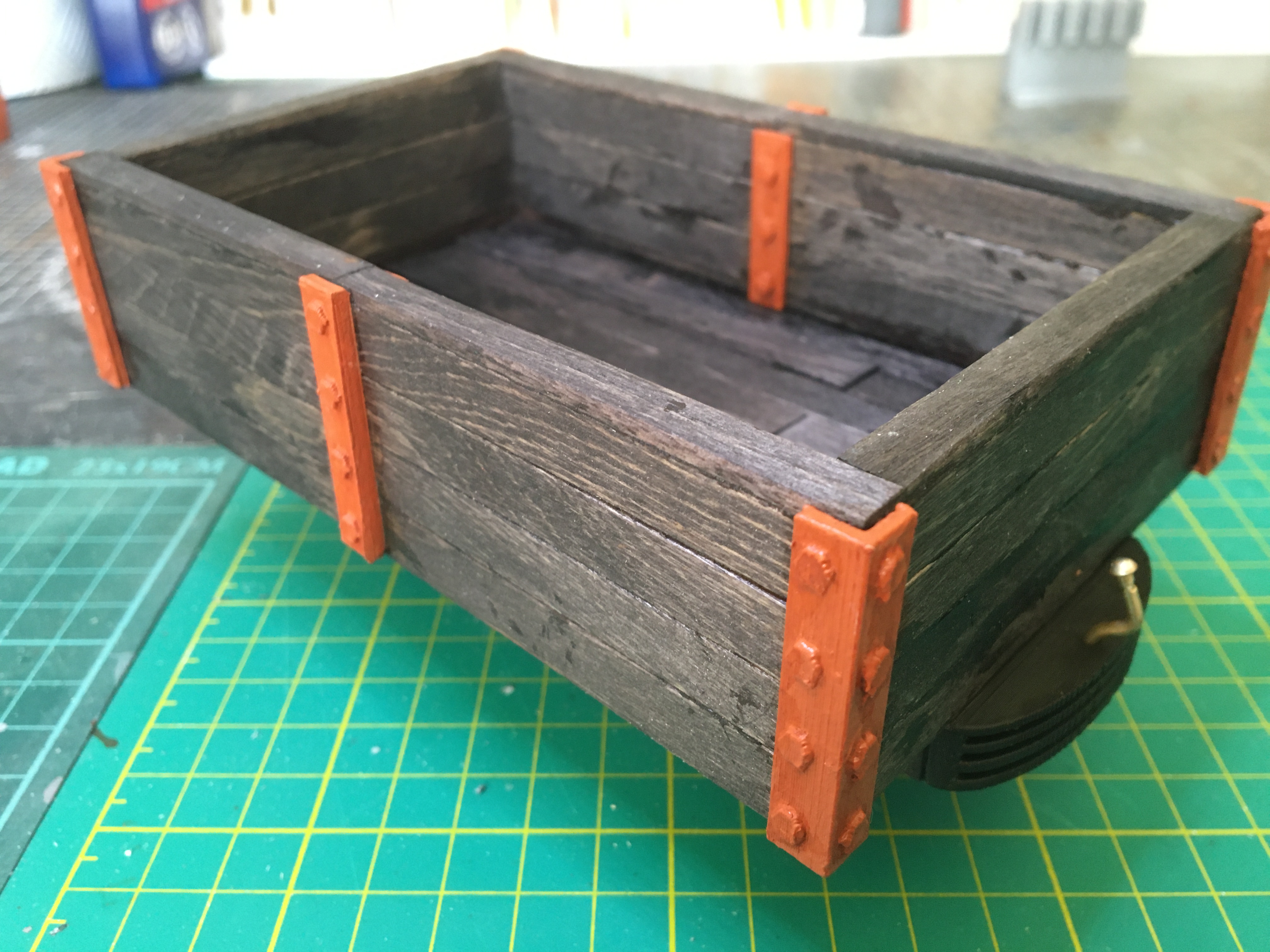

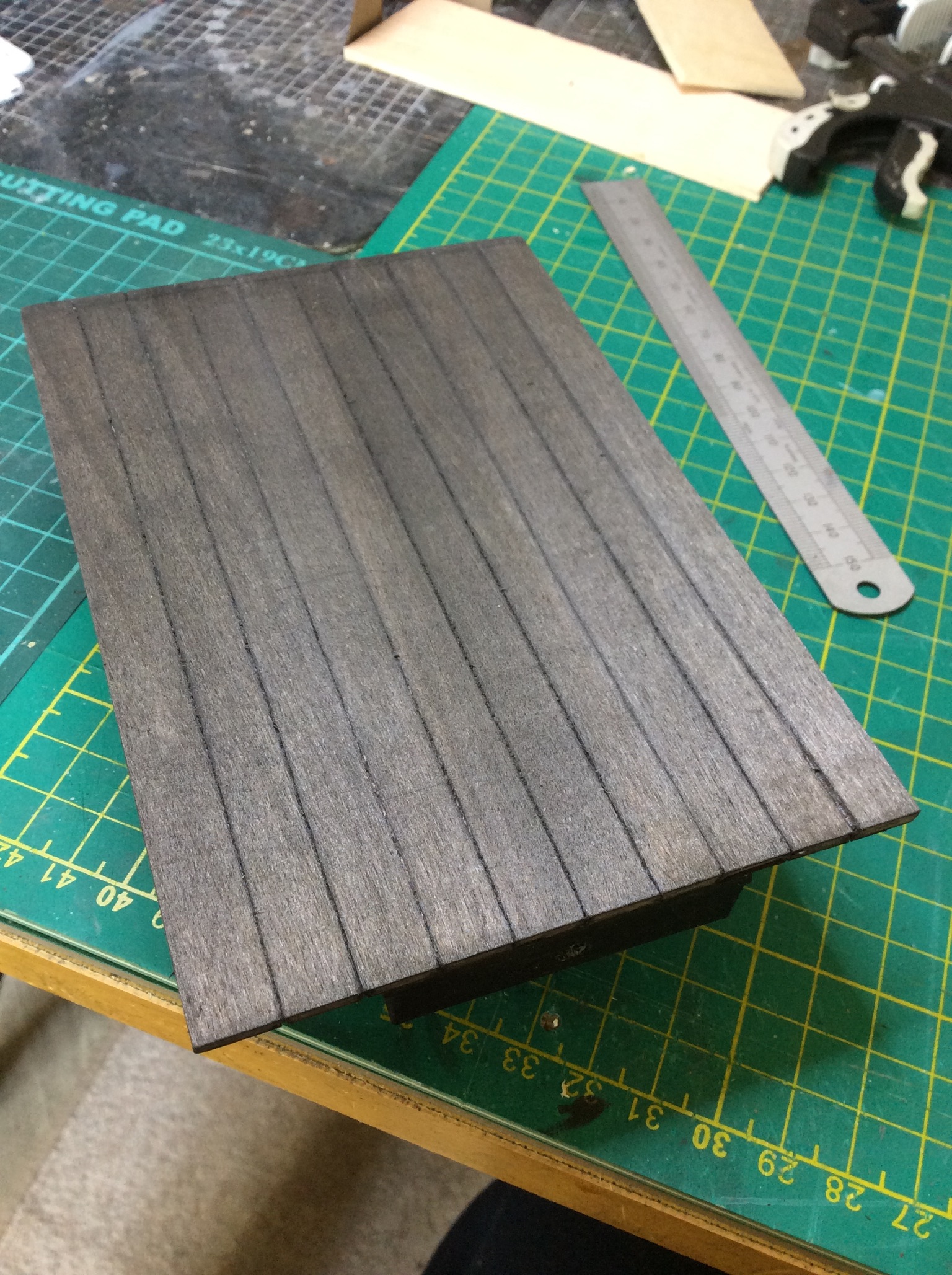

They were all given a black wash, I wanted to try and get the grain to show through, but I did forget how to do it and consequently it went too dark. So unfortunately the rest of the wagons I have planned for the line will need now to be very dark also. :scratch:

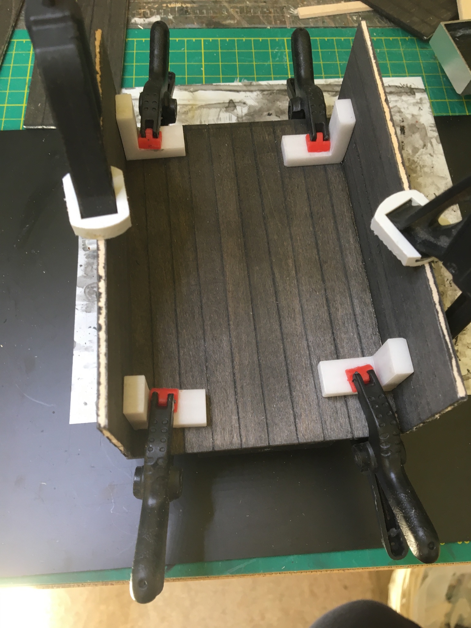

Then I started to assemble it.

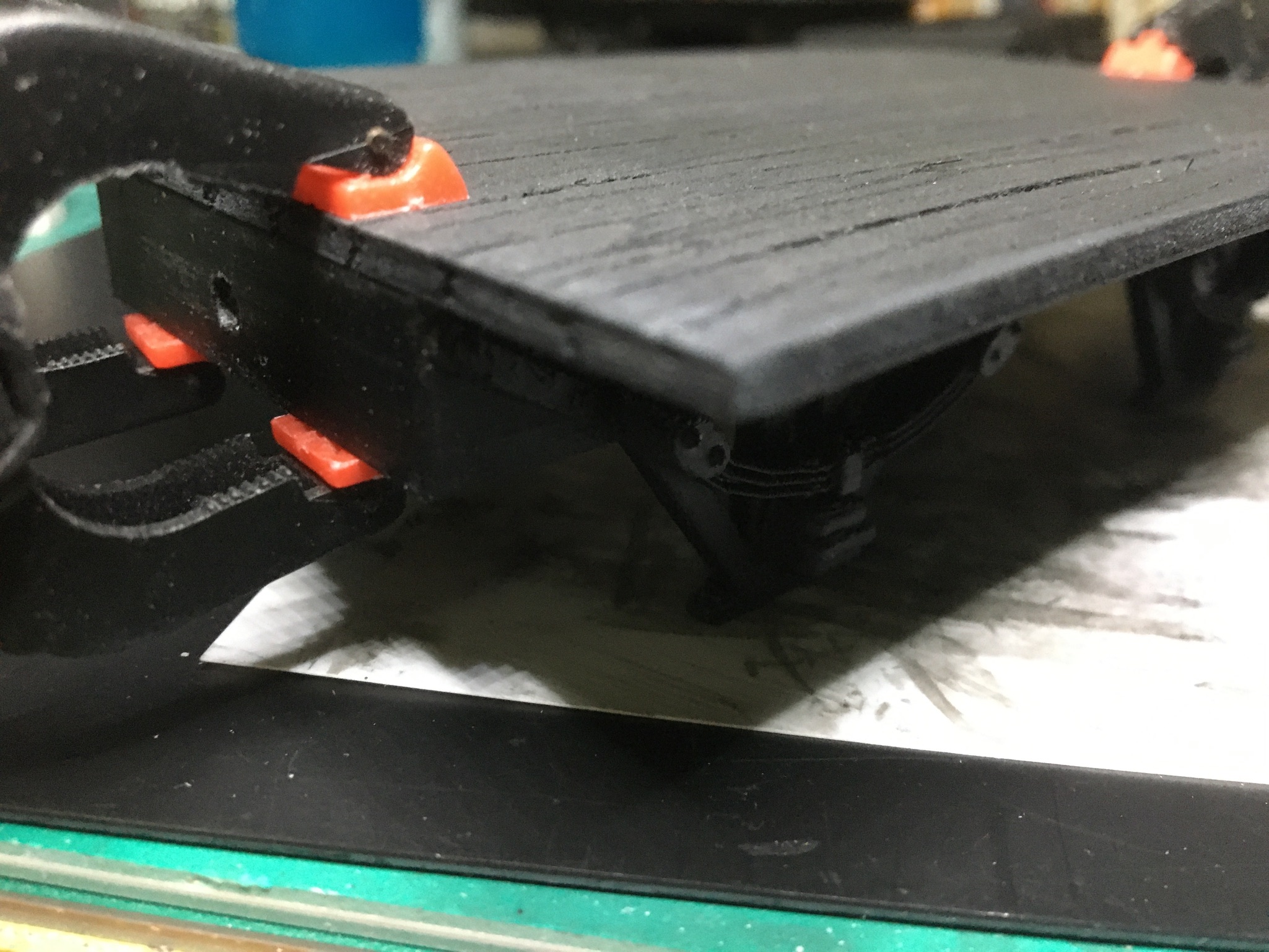

First I superglued the floor to the chassis.
The two sides were than done the same way, but with the help of those ceramic squares.

Then i 3d printed the buffers for the wagon. You have seen the photo of them, so I won't bore you with it again. Then it was weathered and sealed with clear matt varnish.
I have since altered the buffer slightly with the spacing of the buffer plates. I will show you more when I get a rest and with some more weathering done, if I can get it to look something like it should be. But then again it all depends on how much or little, people want the weathering to be. :dontknow:

That's a really nice wagon, the 3D printed chassis looks very neat and tidy.
Question - Where are you wheels from? They do look good.

Those look great! I'm most impressed with those axle boxes. Did you 3D print those a well? I've found it really tricky to draw leaf springs in CAD. I think your efforts might inspire me to try again.
