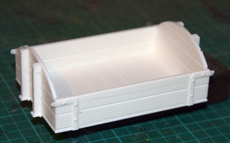

Yesterday I finally managed to get to work on the new printer ( Creality CR-20 Pro) and to begin with it, drove me mad and I came very close to packig it up and sending it back. Assembly was fine, quick and easy, but tryng to zero the z-axis was a complete 'mare. I spent about 2.5 hours following a YT video by "3D Printing Canada" which was really easy to follow, but I did it time and again following each step and checking before moving on to the next, but the zero setting just would not save.
Eventually I went back to a video by Creality themselves, which has the English subtitles mixed up with the Chinese ones and is not exactly easy to follow, which is why I had looked for another one originally.
However by concentrating and following it one step at a time, I managed to set the zero first time. The Canadian video seems to actually have a couple of steps either missing or badly worded.
Anyway, without changing anything from the defaults on either the printer or Cura, I tried printing a small item from my collection of stl's and 10 minutes later I had a perfect print!
I then tried something a bit larger and two hours later I had a 2nd good print.
Soooo... gritting my teeth and crossing my fingers... middle of the evening, I set it to print the wagon body that I was trying to do when the old printer gave up the ghost.
9&1/2 hours later ( Well, 1st thing this morning), THIS is what was sitting on the printer bed:
I am amazed at the quality of this print straight off the bed and just using the default settings and as you can see it needs minimal cleaning up and the surfaces are brilliantly smooth. One small point which has really impressed me is the tiny hole in each of the strapping ends. I drew it but but never expected it to print ( it wouldn't have done before) being only 0.75mm diameter, but all 4 have a clean hole through.
The only slight negative is a small 'elephants foot' effect, which is something I've never had to contend with before, but I'll sort out in future.
I want to have a bit more familiarisation time and then I'll have a go at the Raspberry Pi/Octoprint.

Veering away from the original subject, but still related, I thought it might be useful to record my trials and tribulations for anyone else who might embark on the same journey.
Ok, so the printer I bought in the end is the Creality CR-20 Pro. The main reason for choosing this one over the many others from the same manufacturer was simply it's physical size - it fits in the limited space I have available and most, if not all, of the others are larger. Also, this model is fitted with a BLTouch automatic bed leveller as standard.
First thing was to set the Z-height. The provided instructions are limited and not easy to understand, with English and Chinese bits mixed together, so I looked on Youtube. The video I found from an apparently knowledgeable source, turned out to be not correct after I had spent several hours going round in circles. So, I went back to the official instructions and going very slowly I managed to get the Z set properly at the first attempt.
A couple of trial prints later and I tried a proper model, the result being the wagon body in the post above.
So the next job was to set the BLTouch. There were no instructions provided but going to the Creality site I found some. Like the Z-set ones it had Chinese and English mixed together and was not easy to follow. It started off very much like the Z-set and therein was a problem of my own making. I'm not sure exactly what I did but somewhere along the way I think I got confused and did something wrong and then saved it without realising. So the print nozzle was several mm above the bed and I went through the setup procedure more times than I can remember but I couldn't get the nozzle closer than about 2.5mm. After taking the dog for a walk, watching Tv and sleeping on it (No, not the tv, nor the dog!) I realised that it might be a problem with the BLT, so I went back to the English/Chines instructions for it and carefully followed them again, and after saving it, everything worked perfectly! As an aside, I found a YT video for this procedure as well, from the same Canadian source, and this also had a major error in it.
At this point, the levelling only works on demand, rather than automatically, but a bit of searching found a very simple gcode instruction to amend the Cura start code, it simply needs "G29" adding in to the Cura settings and saving and now it levels at the start of every print.
Next issue to be faced was changing the filament. My old Qidi had the extruder mounted directly on top of the head and changing filament was simply a case of selecting "load filament", waiting for the nozzle to heat and pushing the end of the new filament into the extruder until it was gripped and taken in. This new m/c has the extruder mounted on the side frame and connected to the heated nozzle assembly via a Bowden tube which is about 8 inches long. The only sensible way to change filament seems to be to cut the old filament just before the extruder, heat the nozzle, then manually hold the extruder open and use the new filament to push the old filament all the way down the tube and out of the nozzle.
I have seen references to heating the filament to melting temp and then pulling it backwards out of the system, but then I've seen comments about this leading to blockages from cooled filament that sticks in the tube.
I have also acquired a 2nd hand Raspberry Pi 3B+ ( Thanks Hugo) so that I can use Octoprint to control the printer from the comfort of the sofa! We have previously discussed the power supply and in the end I bowed to wisdom and bought the official Raspberry Pi power unit. However, before it arrived I took the bottom off the printer to see which main board was fitted and had a look at the power supply whilst I was there. It is a 24V 14.6A unit and as far as I can see the printer itself takes about 7A, so there is plenty of spare capacity to lend 2.5A to the Raspberry! Oh well!
While I was waiting, I tried using a 5V 2A camera charger but the Raspberry didn't want to know and wouldn't connect to my home network. The correct item arrived this morning and it connected as soon as I plugged everything together. A quick test print showed that everything was working as expected. However it got very confusing when I couldn't get it to print anything else. I tried to reset things by switching the Raspberry off and an error message appeared on the printer LCD screen saying I need to reset. I flicked the printer switch and heard the printer fans start up..Huh? Then I realised that that the error message was generated by the Raspberry not the printer, and the reason it had printed one file but not any others, was that I had left the SD card in the printer and it was printing from that location and not the uploads!
So now it's hopefully settling down, the various test prints have all been fine. There will no doubt be a lot of fiddling to do, but the basic system is now doing what I want. I do want to fit a filament run out detector and probably a camera, in due course.
