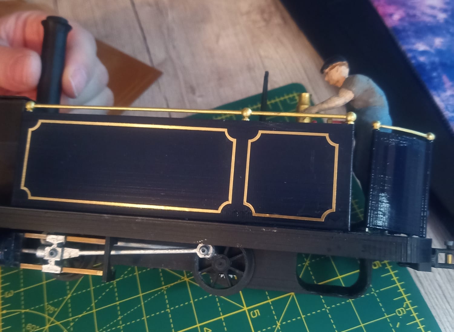

Post by -steves- » Mon Feb 21, 2022 5:05 pm
Well a bit of an update on this, not done much on it in a while. I broke the whistle off today, hence it's in resin green :oops:
I did the lining on this in CAD and then cut it on a vinyl cutting machine and applied it. :thumbup:
Posts: 5730
Re: Mountaineer
Post by Peter Butler » Mon Feb 21, 2022 6:40 pm
Love the lining Steve, makes such a difference.
Posts: 6075
Re: Mountaineer
Post by philipy » Mon Feb 21, 2022 7:18 pm
Ooh thats very nice Steve. Love the lining. Do you have your own vinyl cutting m/c or do you go outside for it?
Posts: 1209
Location: South West Wales
Re: Mountaineer
Post by Trevor Thompson » Mon Feb 21, 2022 8:25 pm
That lining is incredible!
You will have to provide more information on how you achieved that. Is it another CNC machine to buy?
Posts: 8051
Re: Mountaineer
Post by ge_rik » Mon Feb 21, 2022 9:08 pm
My questions are as above ......
ie How d'you do that then?
-steves-
Posts: 2473
Re: Mountaineer
Post by -steves- » Tue Feb 22, 2022 8:49 am
How to do that......
Get yourself a vinyl cutter, fortunately my wife has one called a "Cricut Maker 3". There are just cheaper ones out there for just cutting vinyl, but her one has all the bells and whistles on it, in this instance, the bells and whistles are not required, how odd for a loco hey! :lol:
Design your lines in CAD, preferably using the side of your loco as a template for the size, shape, etc.
Export as an SVG file which can be used for cutting, it only exports what is touching the build plate as it's a 2D image.
(Extra bit. I had to use Inkscape to change the colour of the lines as it seemed to export white on white, not very useful, resave the svg file)
Upload file into Cricut Design Space (that's specially used by Cricut machines, but there are other vinyl cutting programs out there which will do the same job)
Print the file onto whatever vinyl colour you like. Very carefully pick out the bits you DON'T need and discard. Put the remaining lines onto transfer tape (like Sellotape but in a much bigger, less sticky way)
Place on model in the exact right place, then extremely carefully remove transfer tape leaving the lines on the model. (sounds easier than it actually is).
Varnish with appropriate varnish to ensure nothing lifts and is smoother.
The pictures in my previous post show the latter part of this process once the lines are printed and applied.
Hope that helps explain the process?? :dontknow:
Posts: 1209
Re: Mountaineer
Post by Trevor Thompson » Tue Feb 22, 2022 9:01 pm
Wow - that is worth looking into.
The lining is far better than I can do by hand.
I particularly like the way the quarter circles in the corners are so perfect.
It looks as though the complex lining on Corris railway coaches (for example) - with all the intersecting celtic curls might be possible this way.
