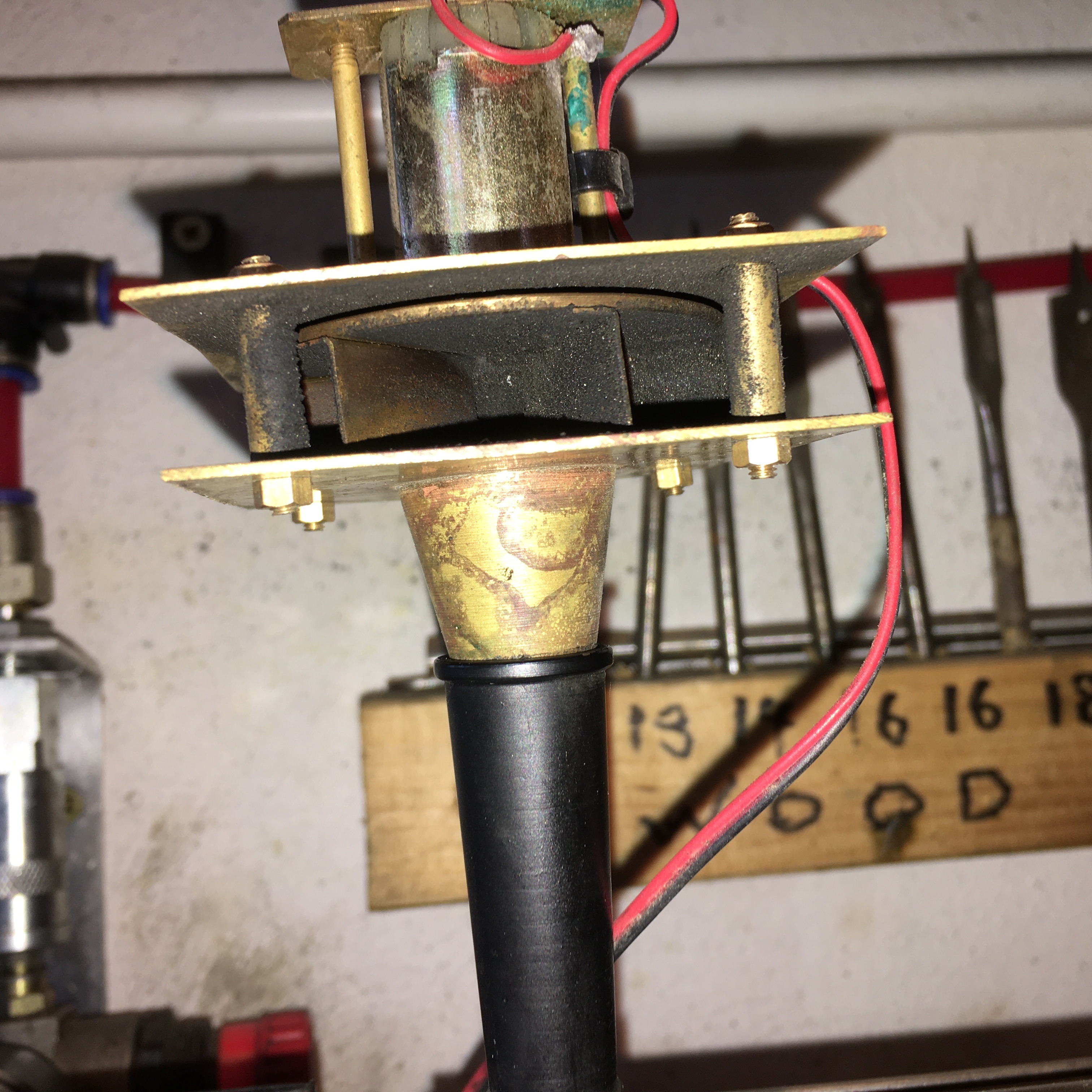

Question to the collective wisdom. The time for the test steaming is getting closer. What, where is a good source of a metal fan suitable for the Llewellyn works to build a steam raising fan blower ?

Darren
The fan is easy to make - perhaps more readily available than a bought fan.
It is just a hub, soldered to a brass disc, and brass strips soldered onto it radially. No actual "fan" - it just works on centrifugal force expelling the smoke.
Photo attached:
Photo attached:

Trevor Thompson wrote: ↑Mon Jan 17, 2022 12:02 pm Darren
Photo attached:
Thanks Trevor, your reply is much appreciated. All adds to my library of research.
