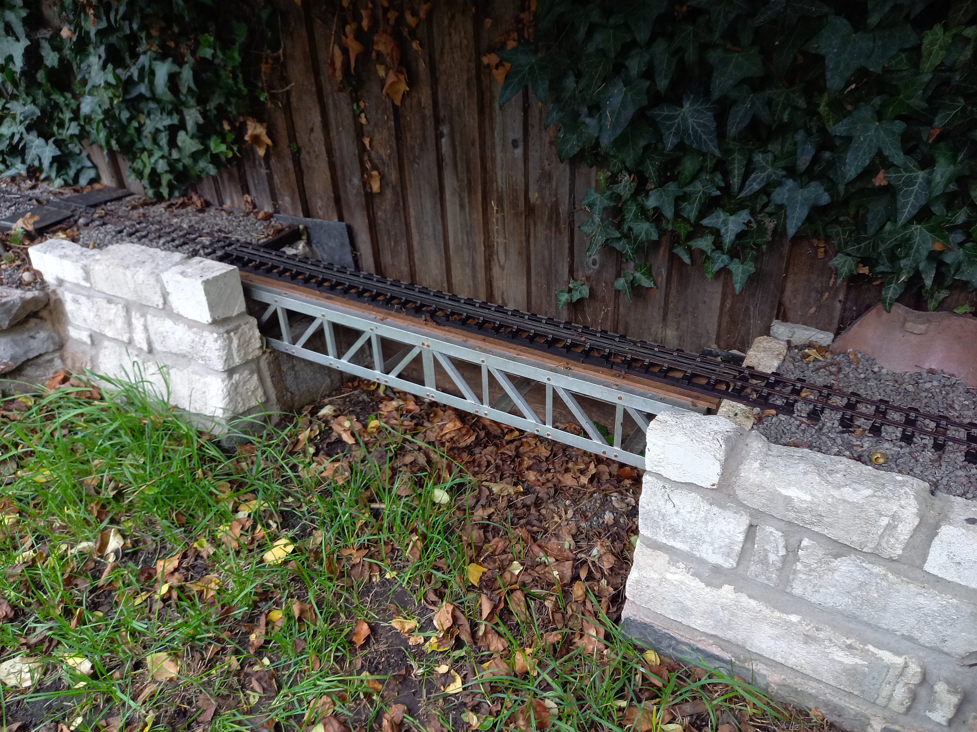

My main project over the summer period was to extend the N&BLR trackbed from its somewhat embryonic state, through two garden rockeries and towards what will become the second main station (of five planned.) NB this makes my garden sound much larger than it is - I’m content with stations being close together but out of sight of one another.
The challenge was a 4ft gap between rockeries, thereby presenting the opportunity for an engineering solution. With some available Bath stone I built abutments, and the main truss under-girder span of 2ft6in was constructed using aluminium angle suitably bolted together. The decking is creosote-soaked stripwood with track laid on top. I’ve somehow managed to continue the steady 1:40 falling gradient unbroken through both rockeries and the bridge itself, more luck than judgement although having floating ballasted track does make adjusting the line and level very straightforward.
With the track now running up to our recently erected ‘outdoor room’, I decided to emulate the smaller BR Western Region halts (such as Church’s Hill on the Tetbury branch, seen here: https://www.steampicturelibrary.com/sta ... 2475.html )
Summer House Platform was built to serve the local landowner’s manor, the grounds of which this section of the N&BLR traverses. Latterly it provides tourists and visitors with easy access to their destination, although trains only stop (by request) during daylight hours. The platform is Cuprinol-treated stripwood on a carbonboard base, representing a basic timber / sleeper construction.
