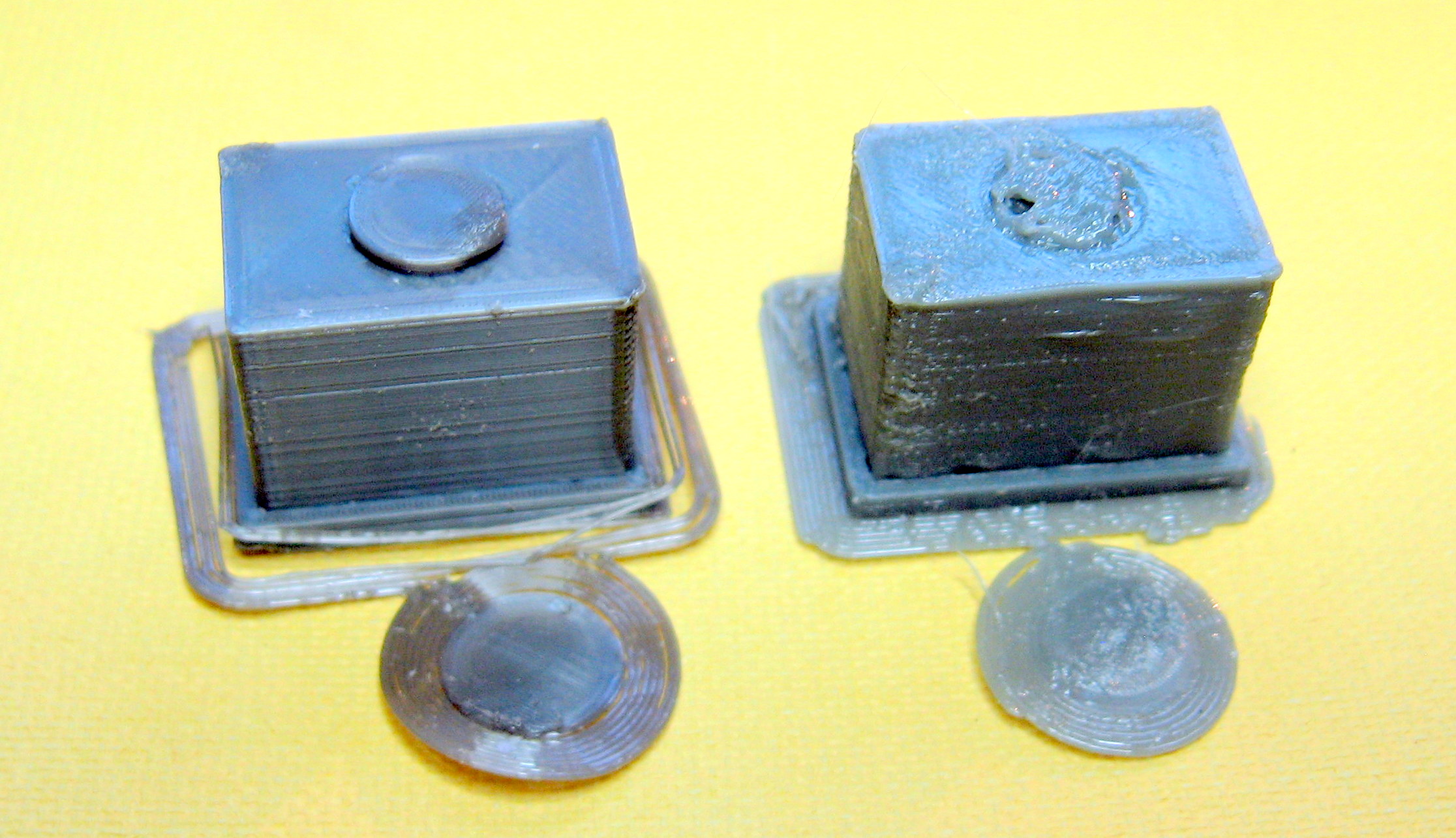

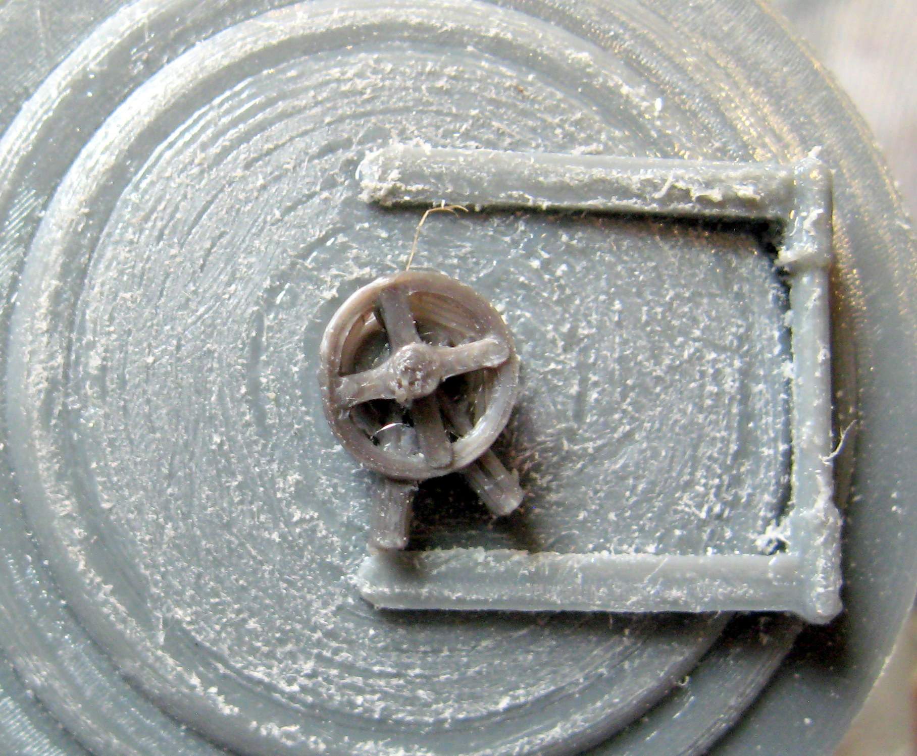

I've now reached the end of the reel of PETG and reached a conclusion.
I have decided to abandon PETG in favour of PLA+
Here's one reason why ..... On the left is the sandbox for my Skylark loco printed with PLA+ and on the right is the same sandbox printed with PETG. OK, maybe I should persevere with PETG to see if I can improve on the settings, but I have come to the conclusion that for fine detailed work and small parts such as these, PLA wins hands-down.
It wasn't until the PLA I'd ordered turned up that I discovered it was PLA+, so I used the default settings in Cura for it and this was the first item I printed. Not sure any further tweaking of the settings will improve it, but you never know.
The second object I printed with PLA+ was the smokebox door handle - which is only 8mm in diameter and took 59 seconds to print. I don't think PETG would have produced anything but a blob of plastic.
PS - Anyone want to buy two unused reels of Eryone PETG?

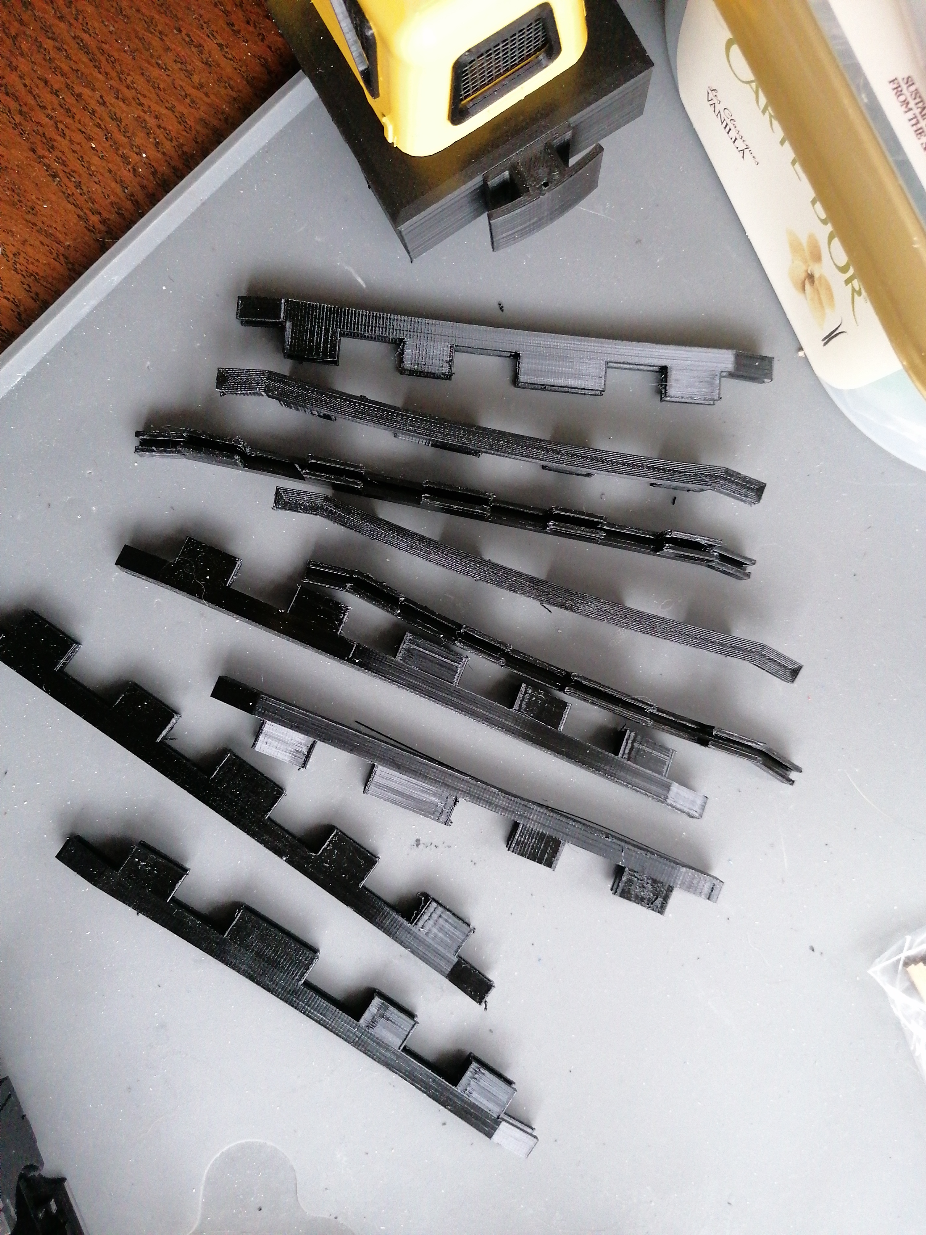

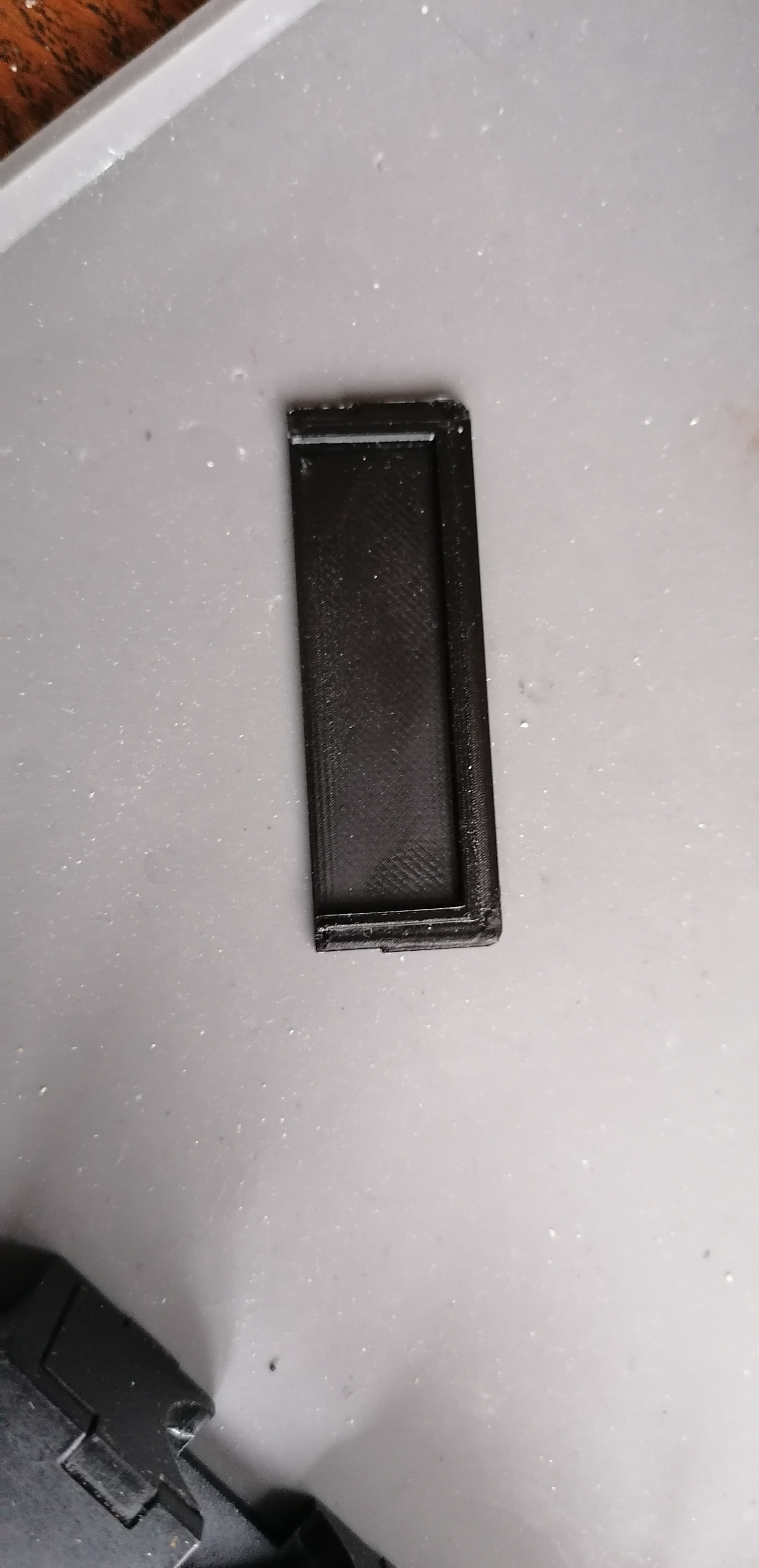

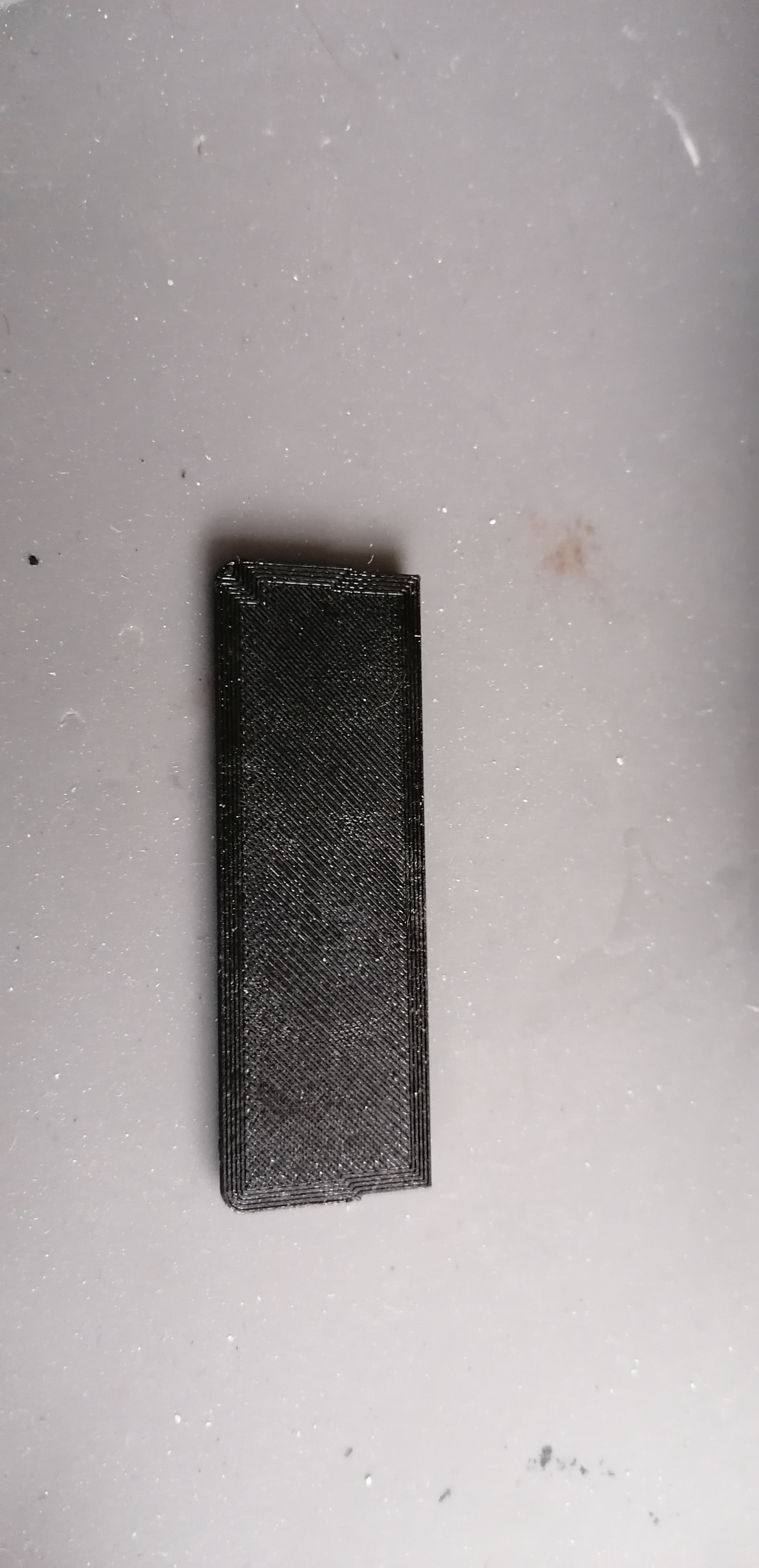

I also purchased some Petg some time ago but have only just got around to trying it. I thought I ought to as I have 3 rolls of the stuff.
Anyway, my first prints were pretty awful, so I did a bit of reading and found some recommendations on how to print it. My main issue it seems was speed, I was printing it way to fast, hence loads of stringing. With a mixture of speed, heat and retraction settings I am now getting very passable prints with it, all be it rather slow compared to what I am used to.
Not much detail on these, but here is a seat and some R1 check rails I printed with it and I am more than happy with the outcome. Hopefully the check tails won't warp like they did in the summer when I used some PLA ones.
So, food for thought, settings can make that difference, or at least they did for me.

- Posts: 7960
Re: PETG or not PETG?
That's useful to know. I still have a reel of PETG, so I might give it another try when my PLA runs out.
