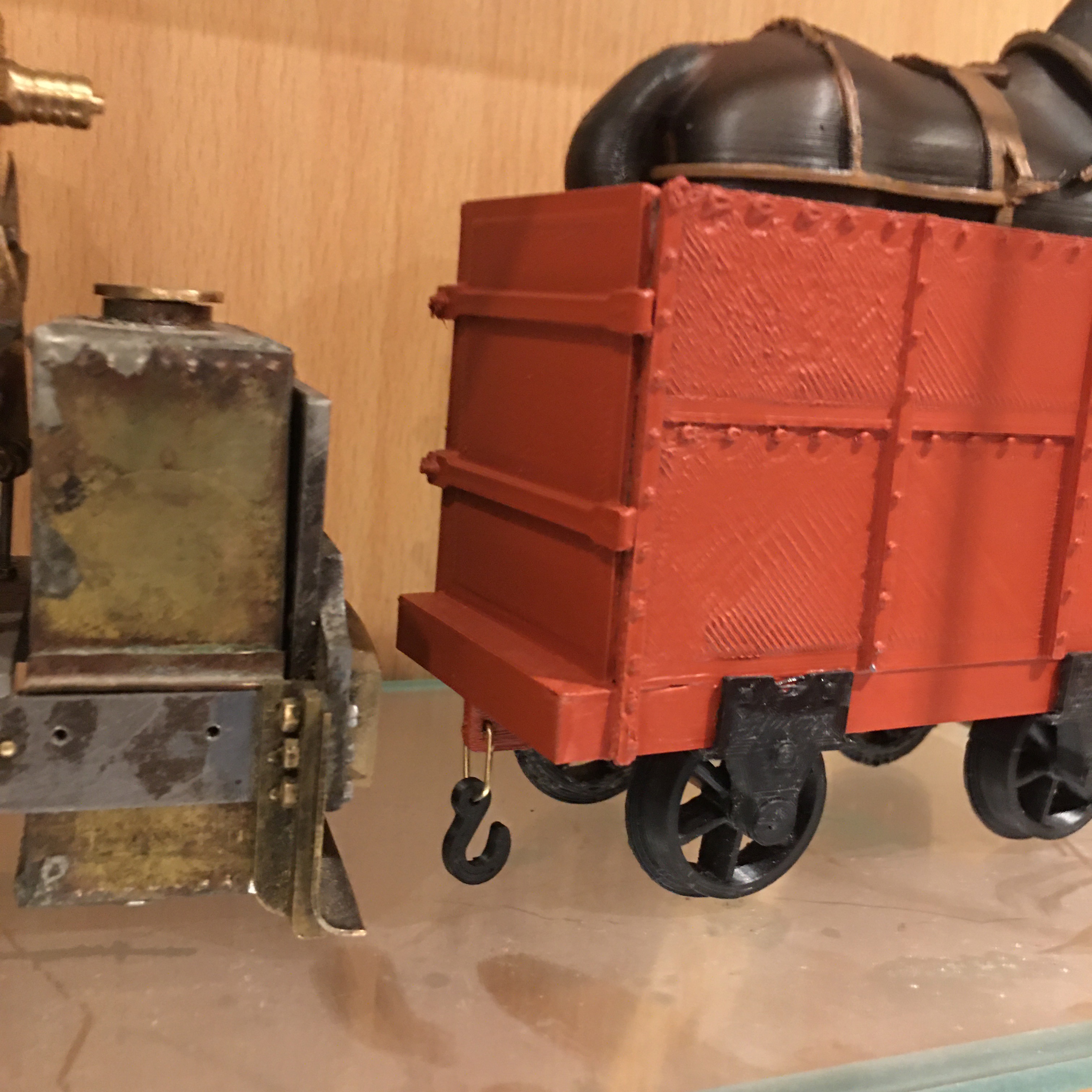

I have been making my own couplings for a while. Firstly 3 D printed hooks for slate wagons, and secondly an interpretation of the early "Norwegian type" couplings used on the Ffestiniog railway, again 3 D printed:
The hook has a square cross section which I found easier to hold with tweezers when attaching it to another wagon. They work fine - but it is a fiddle coupling them up.
The early couplings on coach 15 and 16 had only one hook, and had a tendency to uncouple - so I used a hook on each coupling. Initially I made these from brass, soldering the arm to a body made on a milling machine. The hooks were filed up out of brass sheet. Time consuming to make but they worked. Latterly I have been 3 D printing them, with different versions for locomotives and coaches. To enable wagons to connect to these couplings I have added a brass wire loop under the coupling - which is visible in the photo. It is tucked up under the coupling and can be pushed down if needed.
The couplings work fine and the plastic hooks on the coaches are well able to take the normal strains of being hauled along the track. However if a locomotive (accidentally) bangs into them at speed it tends too break the hook. So I wonder if magnets might be worth investigating?

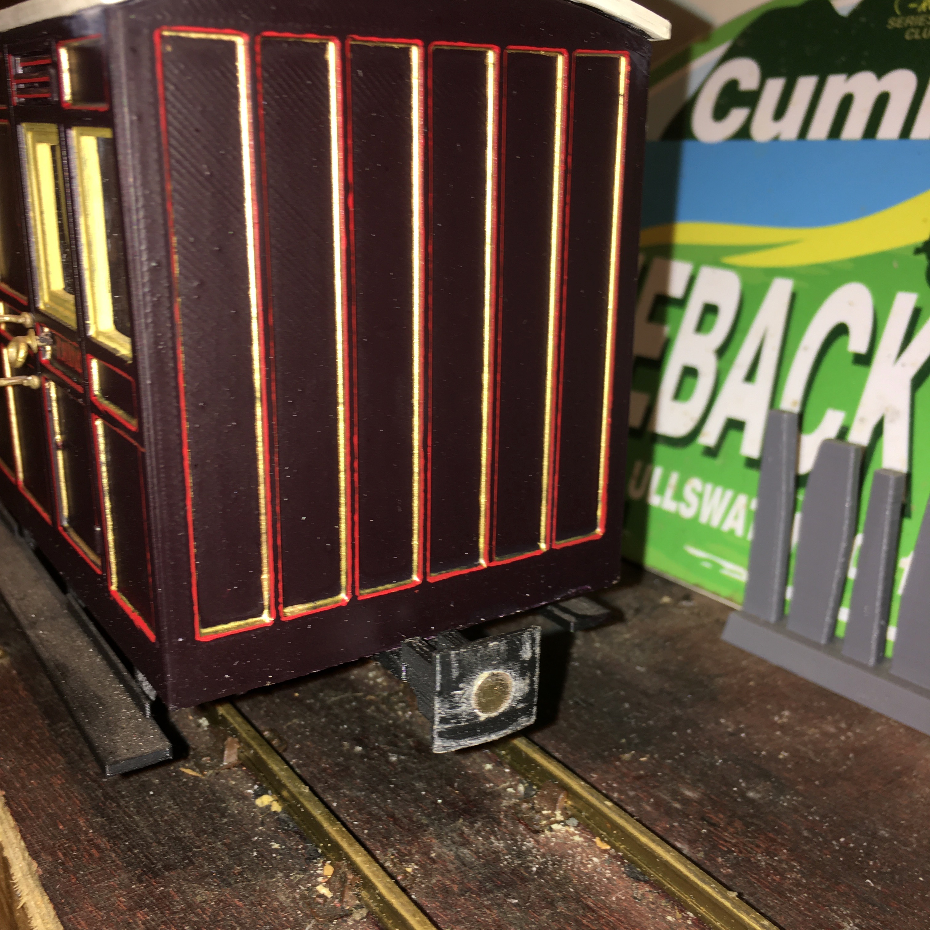

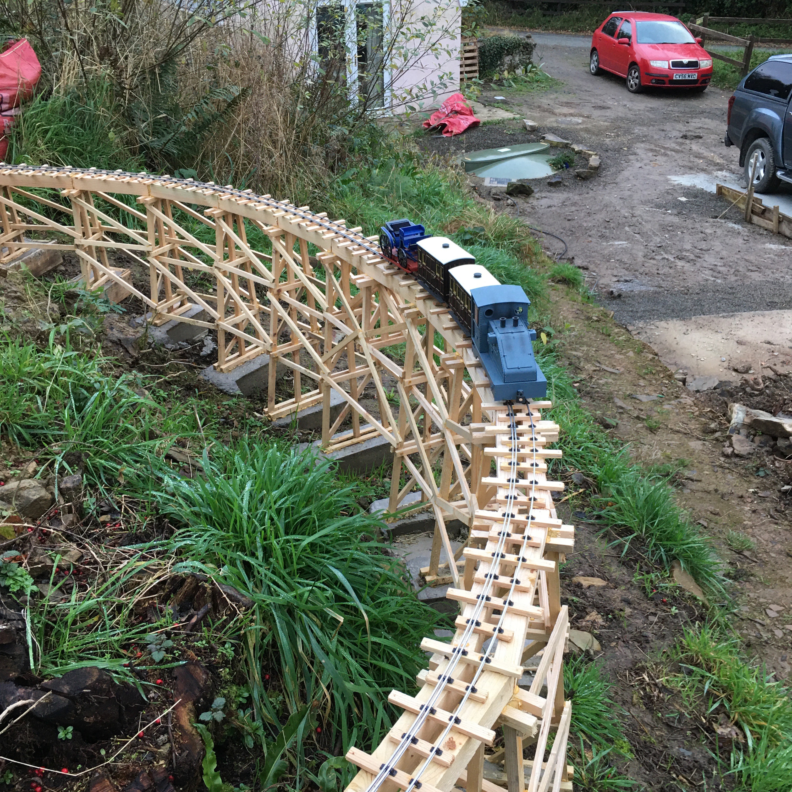

I have bought magnets to add to the couplings. Firstly 6mm diameter magnets 1mm thick, and 3 mm diameter ones 3mm long with a hole in them. The first are for the Norwegian couplings and the second type for wagon couplings.
So firstly my experiments with the coach couplings.
I have modified the cad files for the coupling to make a 6mm diameter recess in the front face of the coupling, printed them, and bonded a magnet into that recess:
I have added these new couplings to the Kerr Stewart diesel loco 4415, 2 coaches and the carriage wagon, and tried them on the line outside:
The train successfully ran all the way to the end of the line, and back. However it did uncouple a couple of times at the top end after the viaduct when it hit the recently ballasted section leading to and into Dduallt and the passing loop. This was caused by ballast sticking to the inside of the rails - and it is surprising that nothing actually derailed here. So that shows I need to clean up the track, and that the magnets are not really strong enough.
Back in the workshop I have added another magnet between the couplings and found that it is much more difficult to pull them apart now. So the trick will be to work out the right strength of magnet. I think my next step will be to add 2 1mm thick magnets to each coupling.

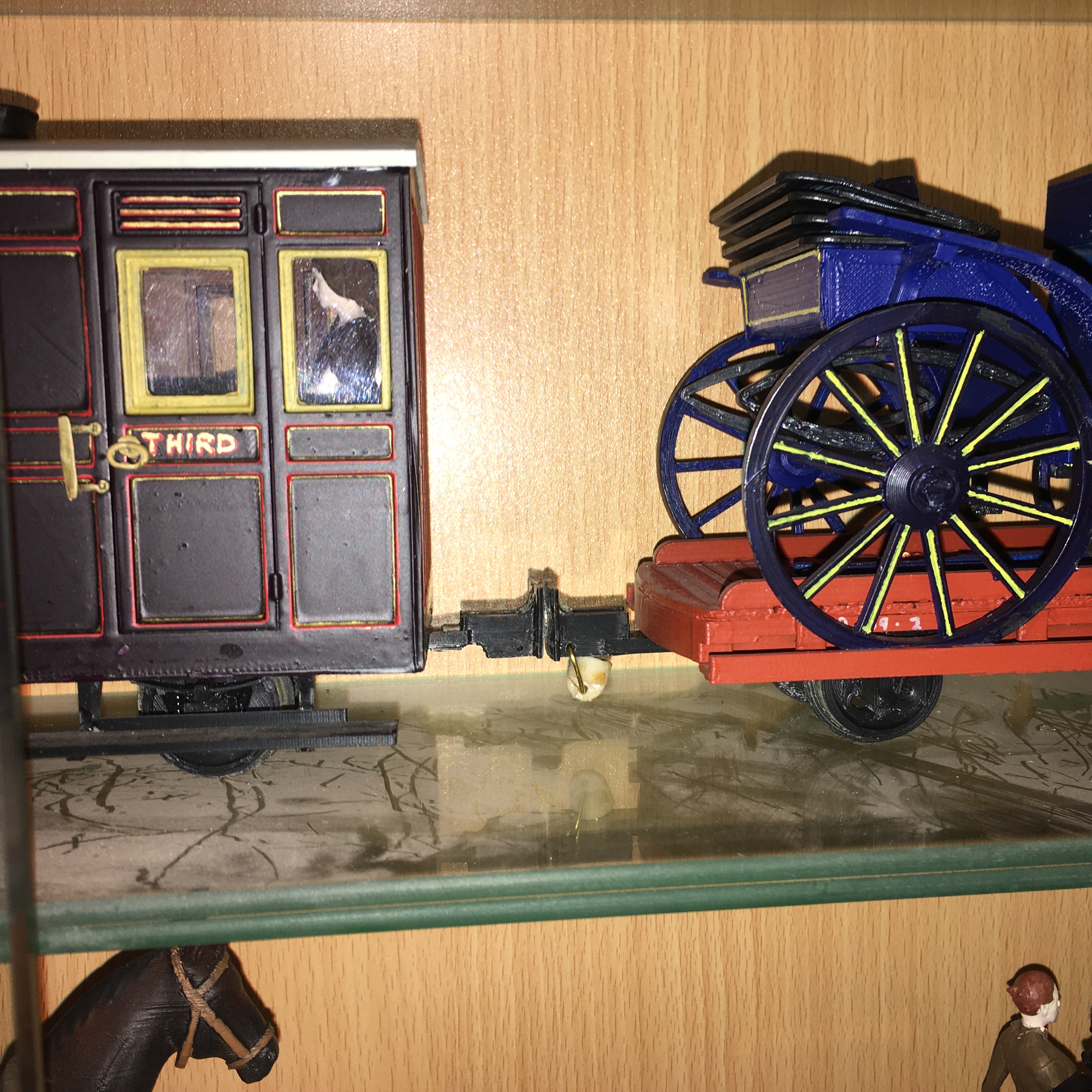

There is an interesting side issue when using magnets as couplings in this way. Magnets are directional - one way around they attract and the other way around they repel:
In this photo they are attracting each other.
and in this one repelling.
So stock can only face one way round on the railway - not an issue on an end to end line but it could be if locomotives can end up facing the other way around. Perhaps more importantly the couplings need to be made in pairs. If a magnet is put in the wrong way around, then you have a coach where both ends will couple to one end of the loco, and neither end will couple to the other end of the loco.

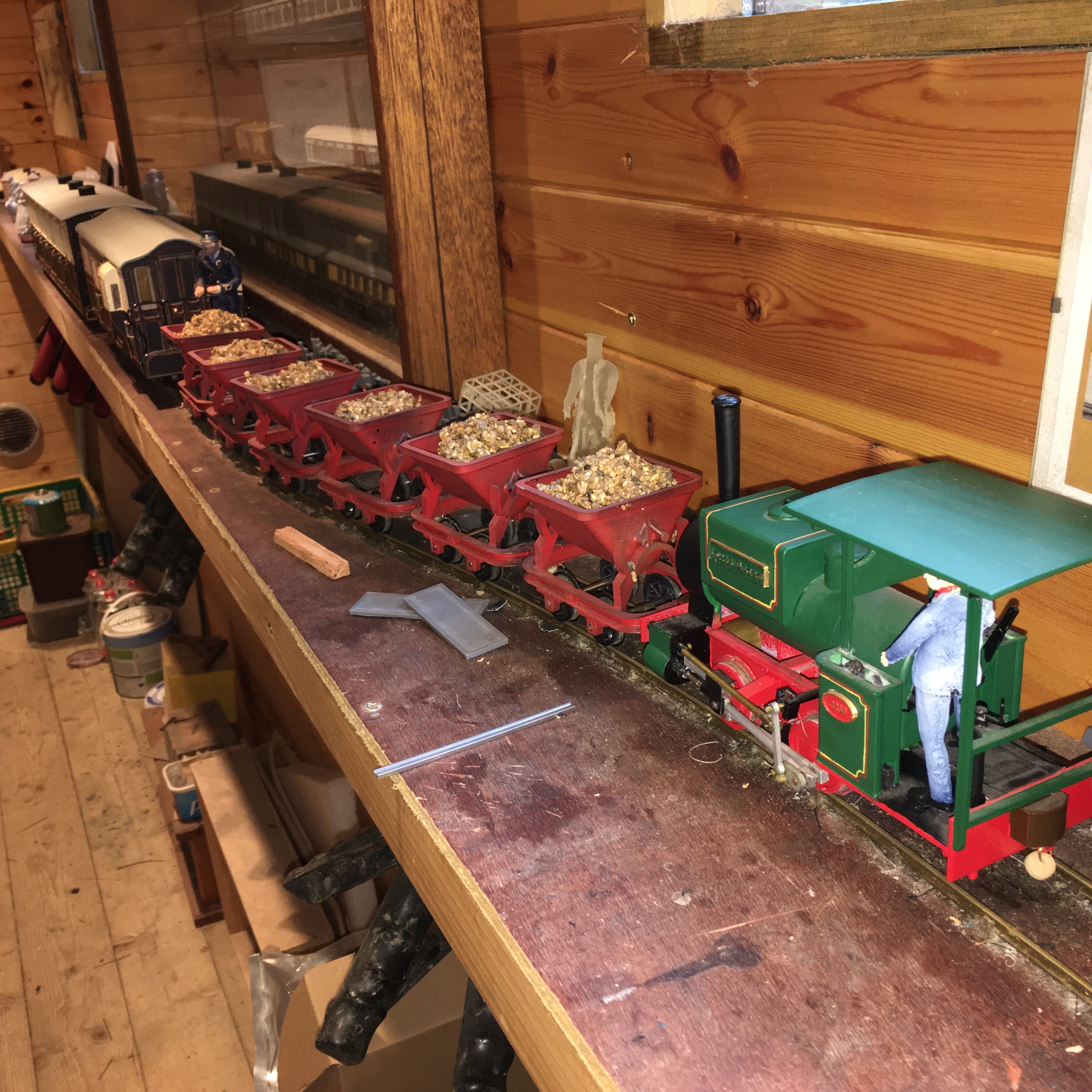

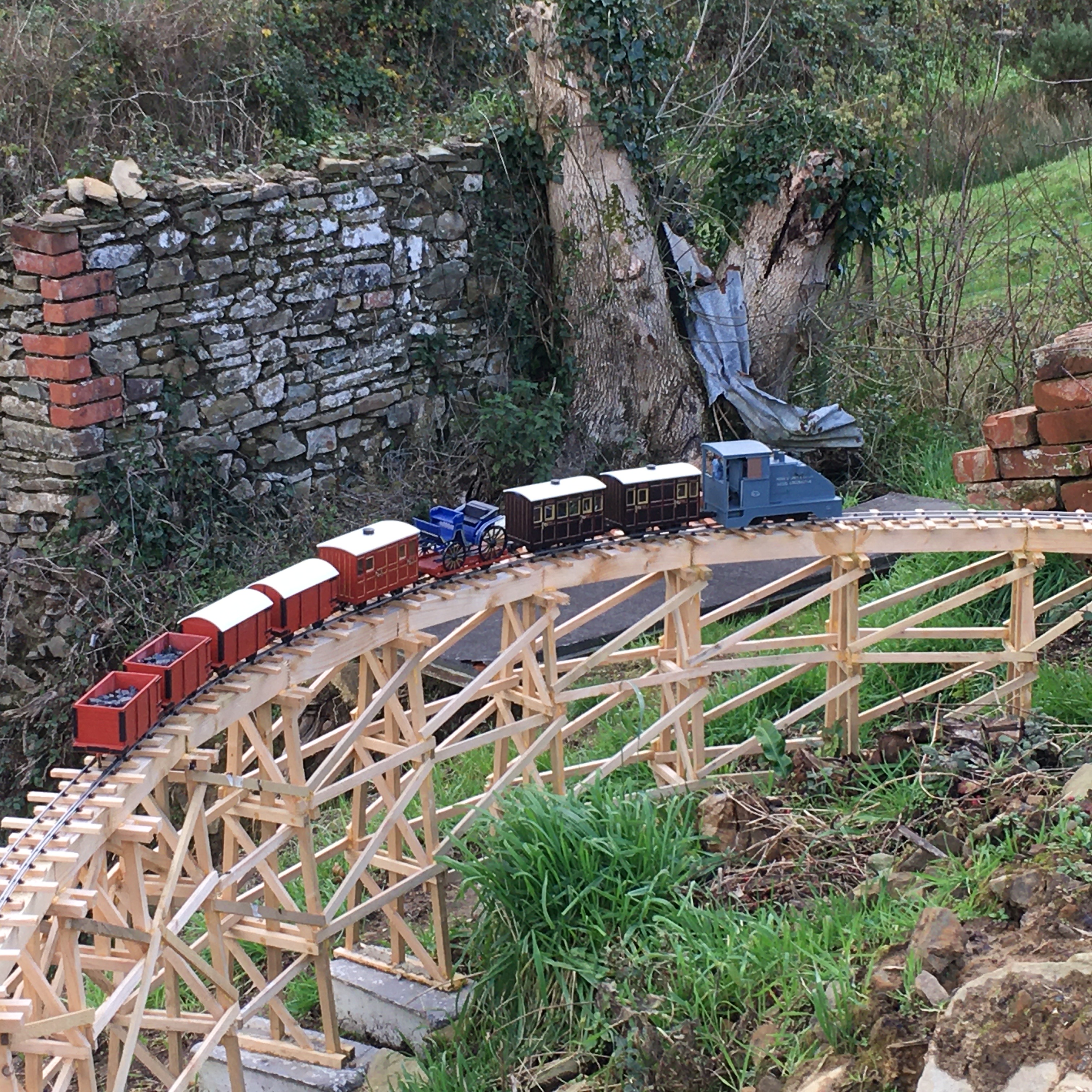

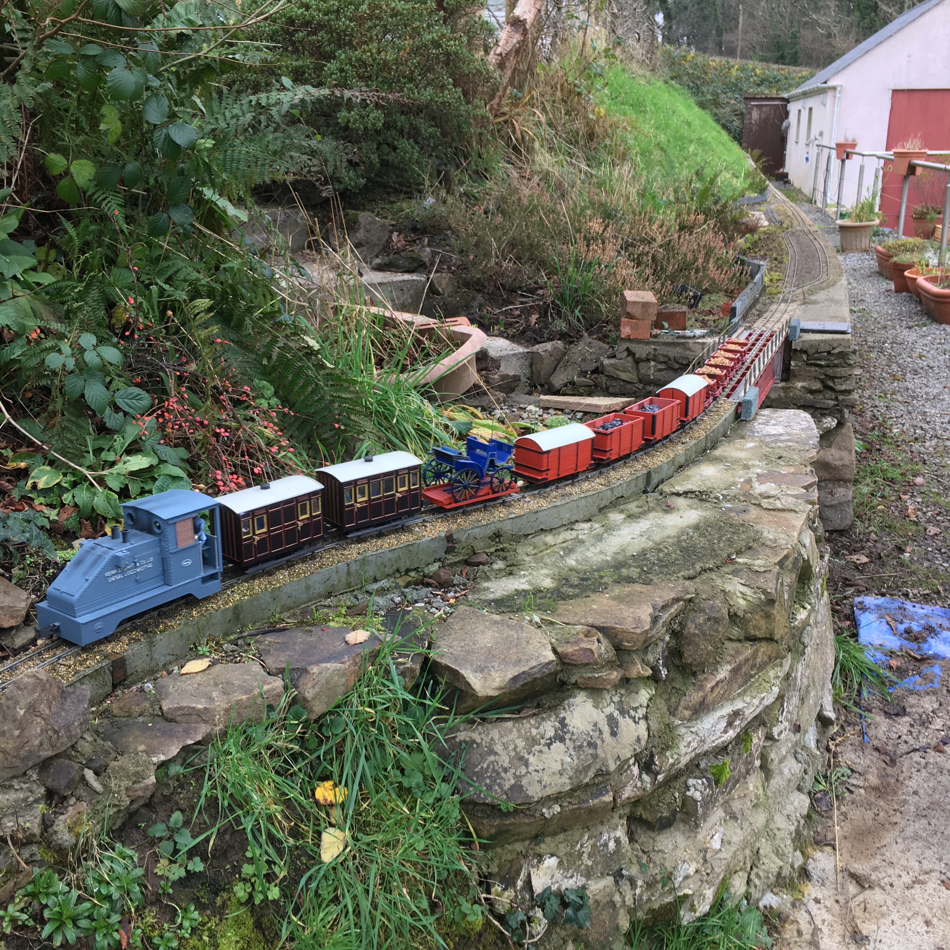

I can report that I have a successful system for magnetically coupling my coaches with the chopper type couplings.
I have sent a heavy train up the line. The goods wagons are coupled with standard hooks, but they are hanging onto a locomotive and coaches fitted with magnetic couplings:
Note that the last 2 wagons are fairly heavy - they are full of real coal. The track is pretty rough at the moment with all the rubbish that the wind has thrown around and nothing uncoupled. So I think it works:
I am standardising on 6mm diameter and 3mm thick magnets in this type of coupling.

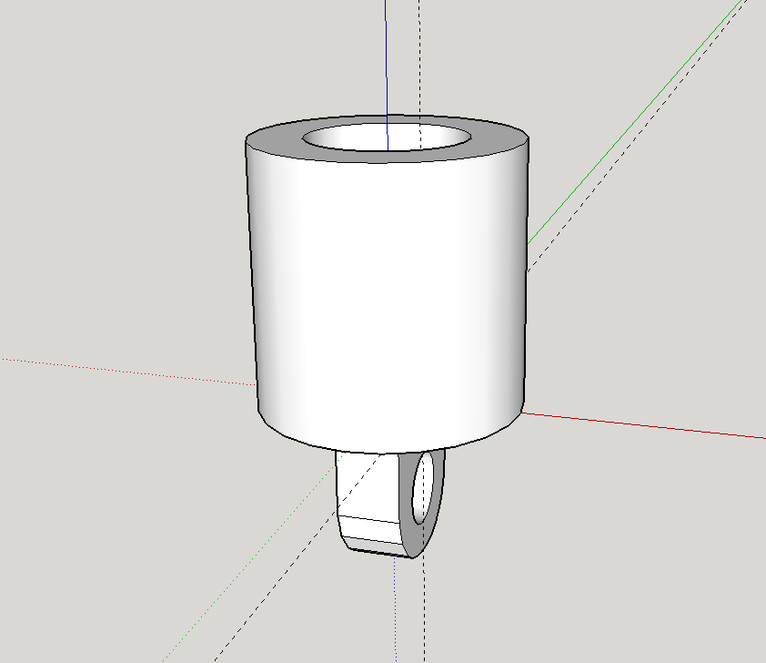

The magnets with holes in them finally arrived from the other side of the world, but they didn't have holes in them. Ah well! So I worked out a way of fitting them into a holder to do the same job as those jewellery clasp magnets.
Of course I designed a holder with a hole in it to glue the magnet into, and a ring to add to the link of chain:
That gives you the idea. I printed a dozen of them on the resin printer. Having washed and cleaned them up I have added them to the skip wagons:
They seem to hold the wagons together well enough to try them on the line. In the photo you can see how they attract and couple up of their own accord. It will be interesting to see if the rings are strong enough.

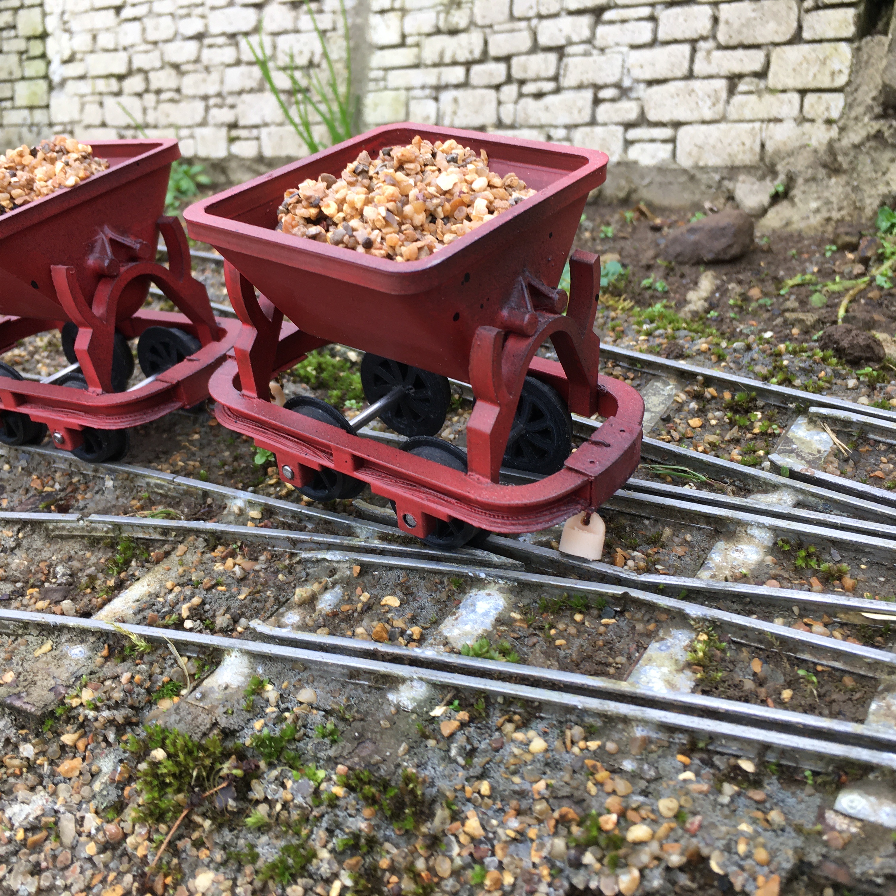

So to the unexpected.
On the bottom half of the line everything worked out OK. But on the top half above the red bridge things happened - and I noticed what was happening as the back of the train crossed the first point:
You can see how the rear hanging magnet has attached itself to the rail - and that caused the couplings further up the train to part - you can see the locomotive and first carriage going gayly on their way.
Just a few inches further on it happened again. So that hanging magnet hasn't just uncoupled the train it has also derailed the last wagon:
Having sorted out the immediate issue of crossing the point ( diamond crossing actually) and setting the train off again I could see how that magnet was being drawn to the right hand rail - and was putting a twisting force on the last wagon which could easily derail it - before it is derailed by the next point.
So there is an issue with these tipper wagons and this particular version of the coupling.

Shunting, or at least pushing the wagons.
My initial tests in the workshop on my test track using the Wren and the tipper trucks led to the locomotive derailing as well as some of the trucks near the locomotive. The issue was partly lack of weight in the printed locomotive, and partly the couplings preventing the trucks touching each other when being pushed. Because the couplings were taking the pushing strain they were pushing the coupling pivots sideways, making the wheels try to climb the rails - hence the derailing.
So I printed magnet holders to specifically take the 6mm diameter and 1mm deep magnets. These are much more successful with these light wagons:
Here is the Wren pushing 6 tippers and two large bogie vehicles around a double curve. Nothing derailed. Here is the same train going the other way (the bogie vehicles were not attached), and everything worked fine. The couplings are 4mm shorter and that allows them to fold under the wagons when being pushed so that the drawbars touch as per the real thing.
Now I need to establish that these thin magnets are strong enough to keep these wagons together:
I also checked that the magnets don't attach themselves to stainless rail held in the middle of the track. They work in the workshop but the final test will be on the line this afternoon.
