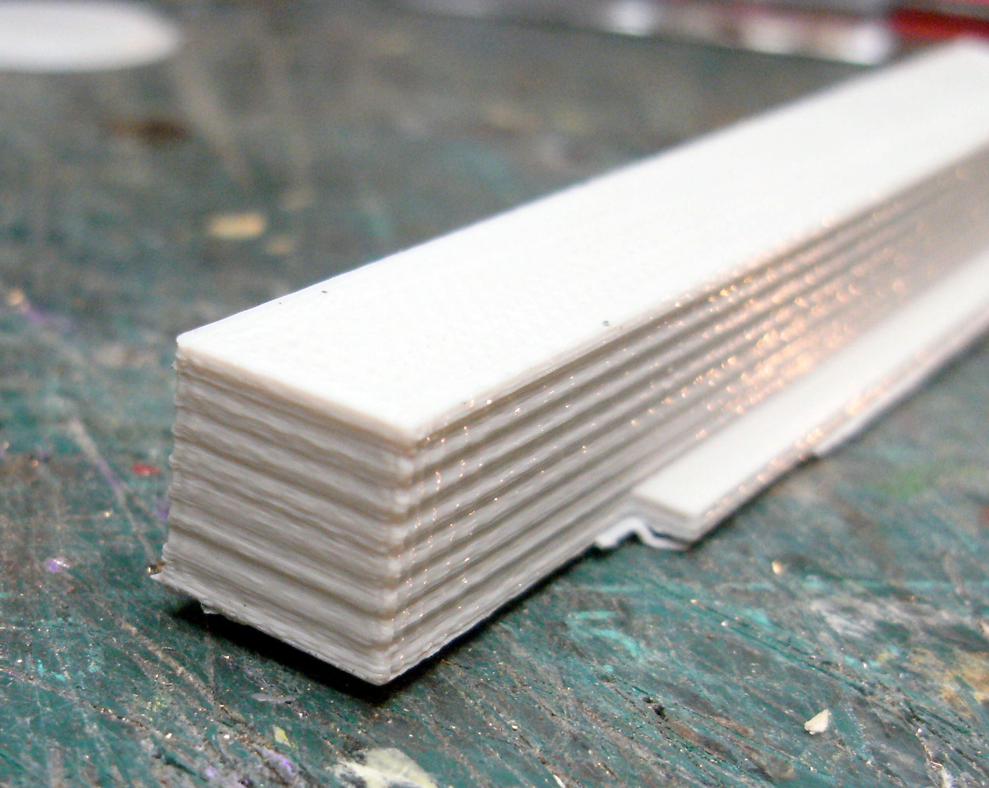

I've had my (very) cheap Anet A8 clone for about 18 months now and upgraded almost every part of it. I've also strengthened and reinforced the structure to try and overcome a consistent problem I've had since I first got it - I get regular corrugations every 1mm or so on both the X and Y axes.
I've always assumed it was because the plywood structure is a bit rickety but I'm having doubts that it is the cause:
  • I've done my utmost to eliminate movement in the structure and it has made absolutely no difference
  • The corrugations seem too uniform at every 1mm or so which means the structure would have to flex one way and then the other after every 10 layers
  • The corrugations seem uniform on both X and Y axes
So, do you think there's some sort of bug in the firmware or am I barking up the wrong tree?

Looks like typical z-banding or z-wobble artefacts, if you look up those terms online you will see a wealth of information on this common issue.
You say its every "1mm or so." Coarse M8 is a 1.25mm pitch, if the banding lines up with the pitch of the leadscrew you know its something linked to the rotation of the leadscrews. Most likely bent leadscrews.
My machine originally came with threaded rod for the leadscrews, and I had similar issues, but not as pronounced. I ended up using a part similar to this: https://www.thingiverse.com/thing:141479, which allows the nut to slide around under the x axis ends following a bent rod, but not transferring that motion to the x axis. It helped a bit, but didn't fully eliminate the issue.
A bit later the threaded rod on one side wore out, and I replaced the z axis with proper trapezoid leadscrews which work much better than ordinary threaded rod.

metalmuncher wrote: Mon Aug 23, 2021 7:11 pm Looks like typical z-banding or z-wobble artefacts, if you look up those terms online you will see a wealth of information on this common issue.
That makes perfect sense. Thanks.
Did you have to recalibrate the Z axis when you replaced the leadscrews?
