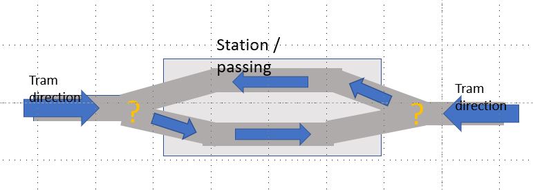

Can anyone explain how a real tram turn out works . So that it directs a train coming from one direction on a single track to one side of station and vice versa? Direction dependant . Are there any moving "points" in such a system . Looked at my local tram and cant see any but cant see how it works.
Attach picture of gist of what I mean
Any advice on recreating this function ( O gauge) I did it once by inserting a thin piece of plastic into track at diverting point so it directed one way. tram leaving station coming other way knocked it aside to continue back on to single track Painful, hoping such is not needed

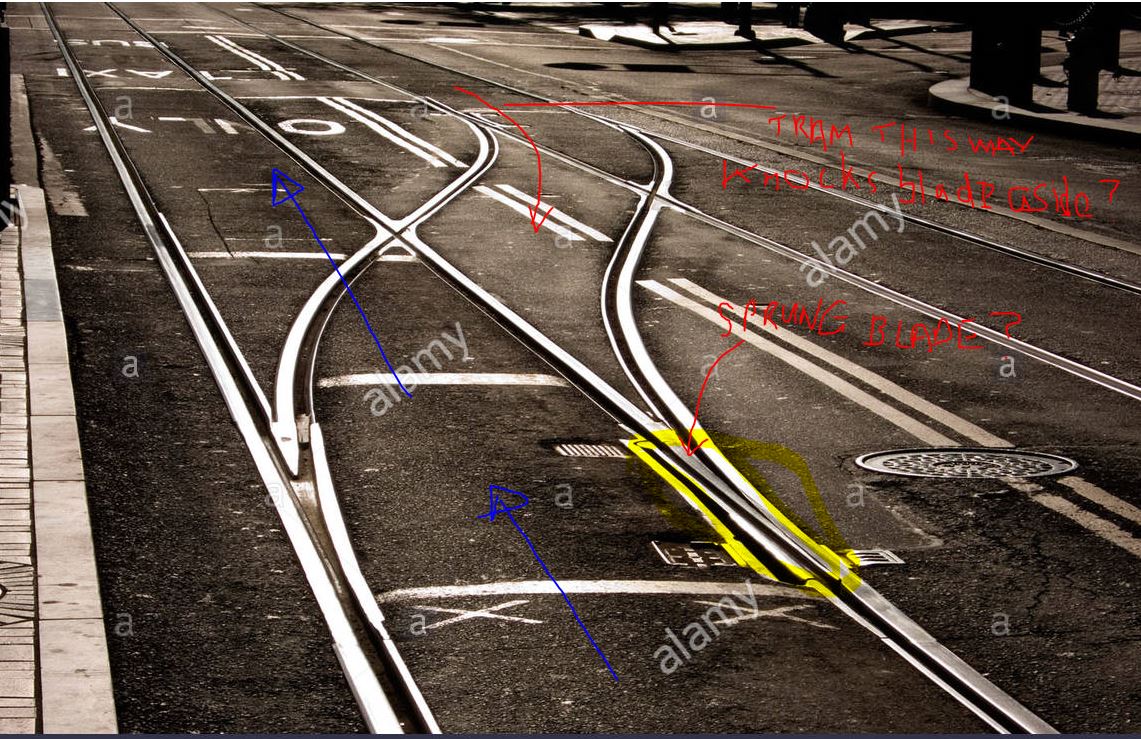

Attach photo from tram expert of real tram track ( I marked up ) The blade here looks like it is a pivoted type ( not sprung steel)

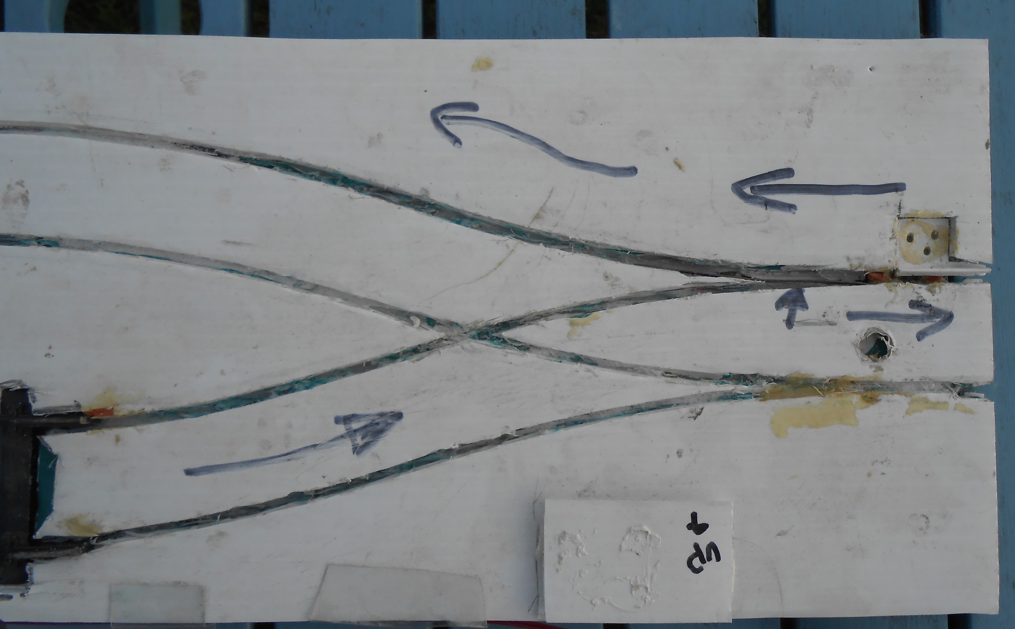

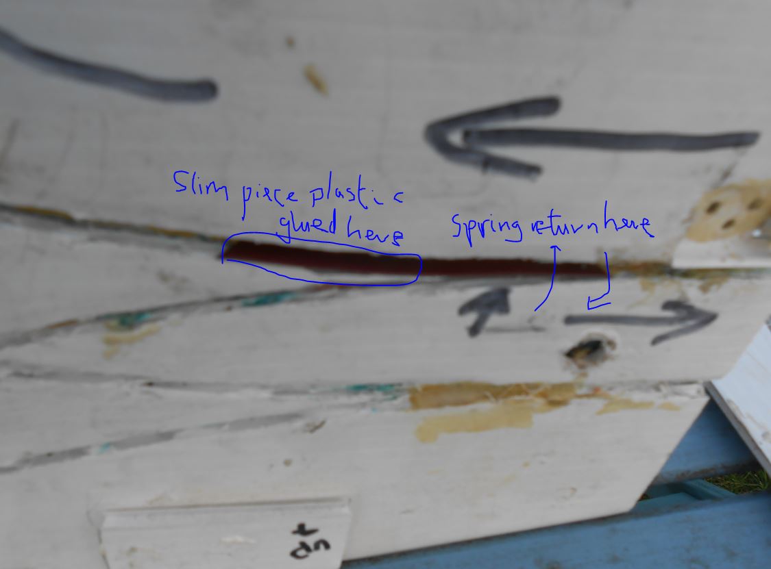

Attach couple photos of my old single line tram model to stations. It ws made by dragging a soldering iron over old plastic advertising house for sale bill boards
You may just see the thin plastic film I glued in to simulate the " blade pivot" worked well but rather unsightly O guage
