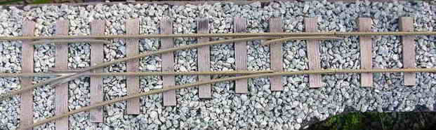

Alternatively you could go for the no moving parts option...
- Attachments
- FixedBladeTurnout2.jpg (34.96 KiB) Viewed 8405 times

That looks great Tony, What is it called? so I can look to buy a couple online, regards Norm

As Tony says, not much chance of buying one off the shelf. You could get a bespoke one made, but the easiest and probably cheapest way of doing it would be a modfication of a standard Peco point. Shorten the blades to allow flanges, then solder small bridges between the stock rails and blades.
