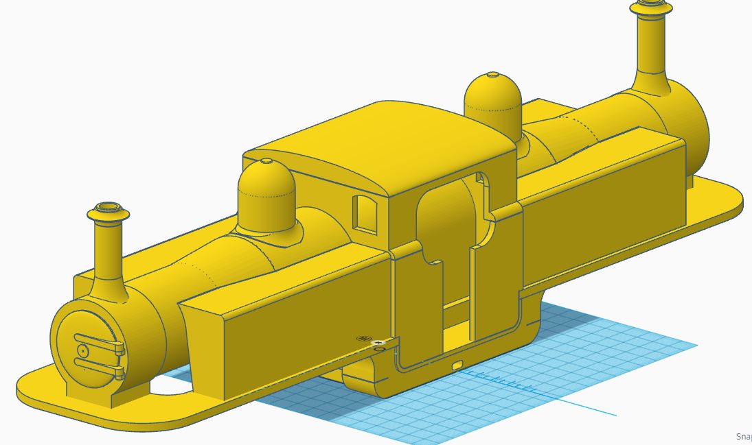

Been doing a bit of tinkering over the last couple of weeks, can you tell what it is yet?

Perhaps it would help if we had a view from the other end?
Posts: 8022
Re: Can you tell what it is yet?
Post by ge_rik » Wed Feb 24, 2021 2:51 pm
It's a single Fairlie loco looking back into a mirror.....
Post by Andrew » Wed Feb 24, 2021 2:52 pm
Judging by the livery, I'm going for a tamper or some other kind of track-fettling machine? Probably ought to have wasp-stripes on each end though?
Seriously, that's very impressive, especially the tapered boiler...

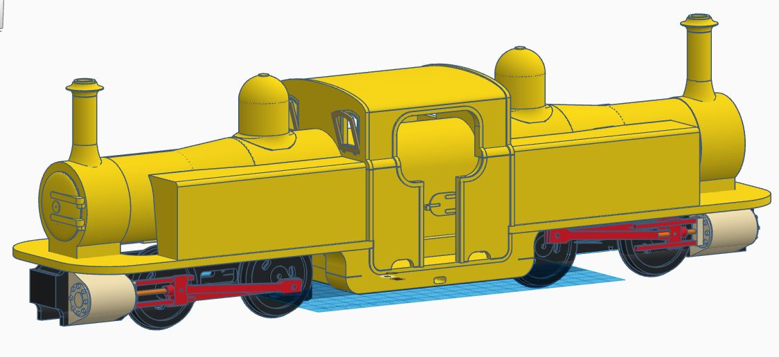

Well, it's had a bit of a cab upgrade and it even has some wheels now, lol. :D

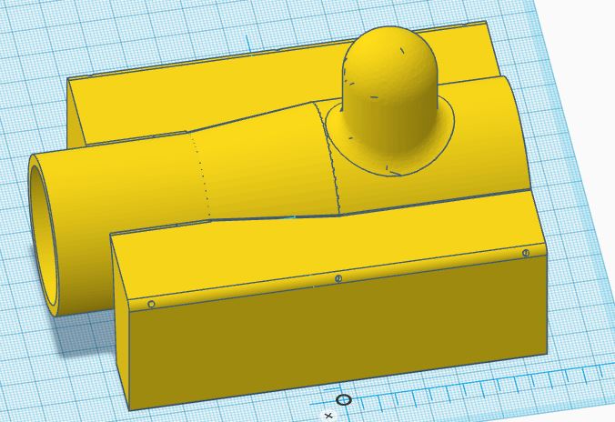

Another little upgrade, how this will all hang together once printed, well, I have no idea to be honest, lol :lol:

Opening spectacles as well! You are getting adept at TinkerCAD

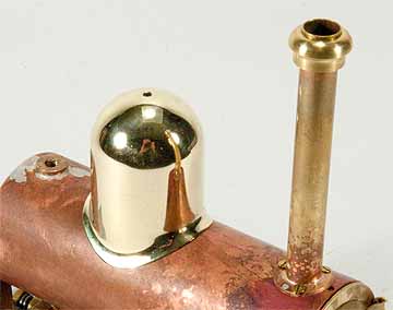

I try, but quite honestly I think you are way ahead of me with Tinkercad. I certainly have issues with doing the dome, I can get it to fit if I print it in pace as I can hide it in with the boiler wrapper. What I want to do is have it as a separate piece and that just isn't working at all. I would like the dome and then have it flare over the boiler for the same amount in each direction. I tried using a "P-Ring" adjusting the wave height, thickness etc etc, but it just won't work :( Something like the brass one below I found online, that flare is a nightmare to get in each direction. If anyone knows how, I would be eternally grateful. :thumbup:

I've not perfected the flare yet. It's a bit of a compromise whichever way I try to do it.

I have no idea how any 3D work is done but I can show the PDF Models domes do have a flare, so it suggests there is a way.

Peter Butler wrote: Thu Feb 25, 2021 2:02 pm I have no idea how any 3D work is done but I can show the PDF Models domes do have a flare, so it suggests there is a way.
Also, if it helps, this is the way their kit is separated into sections ....
Hi Peter
Yes, that dome is exactly what I am after doing, I would imaging that it requires a better CAD program and a decent CAD person to make it :(

ge_rik wrote: Thu Feb 25, 2021 11:50 am Opening spectacles as well! You are getting adept at TinkerCAD
Absolutely staggering what you are both capable of getting TinkerCAD to do. Fascinated to see how this beautiful drawing will translate into a real-world print, the detail is wonderful.

SimonWood wrote: Thu Feb 25, 2021 2:34 pm
Thanks Simon, as you know, both Rik and I are self taught in Tinkercad with no previous experience, you just learn it as you go along, it is so intuitive :thumbup:
All the parts are designed separately so each part is already printable, the printer is just busy doing a long list of other things at the moment. I have only put them all together in this one piece so I (and you) can see how it fits together and how it should eventually look. Some of it is very painstaking, lol :lol:

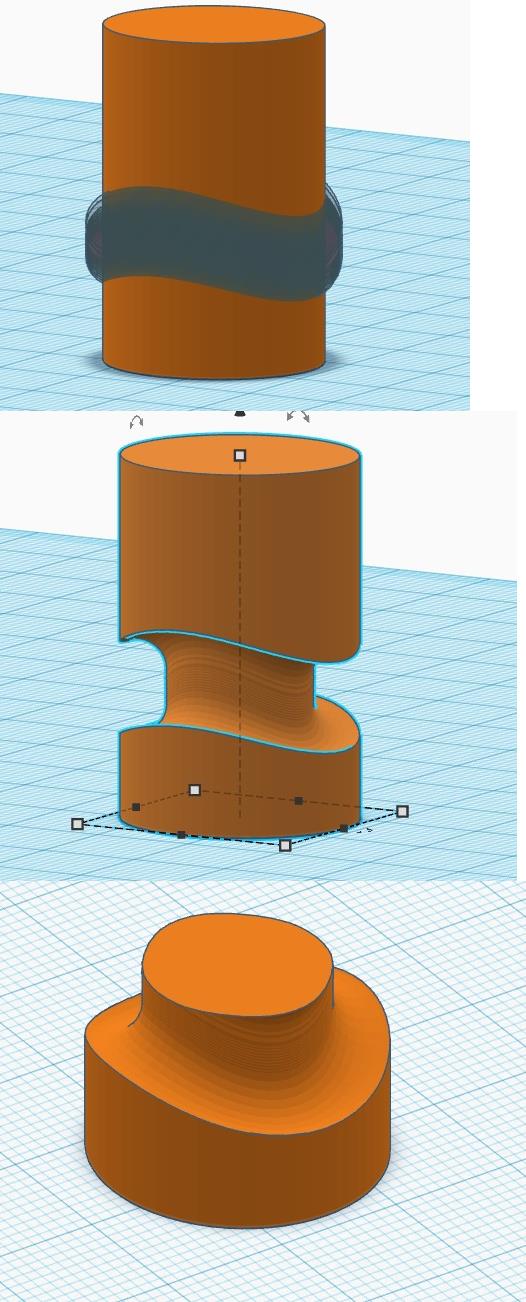

Out of interest I have just had a go with TinkerCAD, your results look brilliant for what a basic set of tools it gives you.
I haven't seen a good way to do the flare on the dome in TinkerCAD. This is how I would do it in Fusion 360, its very easy, at least when you know how to do it. :lol:
It appears TinkerCAD can import STLs, maybe there is a case for doing the dome in another program, exporting it to STL and importing it into your main TinkerCAD document? If you give me the dimensions of the dome and boiler I could send you an STL if you want, as you can see it will only take a minute. ;)

metalmuncher wrote: Thu Feb 25, 2021 7:03 pm Out of interest I have just had a go with TinkerCAD, your results look brilliant for what a basic set of tools it gives you.
That looks very handy. I do have Fusion 360 so I will give it a go tomorrow. I did use it once to make a curved wheel, took me ages and it looked pants, but I did export it and get it into tinkercad but as its an stl file there isn't much you can do with it.
If I can't follow the YouTube video then I will be asking for help again, lol.

-steves- wrote: Thu Feb 25, 2021 12:23 pm I would like the dome and then have it flare over the boiler for the same amount in each direction. I tried using a "P-Ring" adjusting the wave height, thickness etc etc, but it just won't work :( Something like the brass one below I found online, that flare is a nightmare to get in each direction. If anyone knows how, I would be eternally grateful. :thumbup:
Try getting the the P-Ring the right shape and turning it into a hole around the base of the dome cylinder. Duplicate the P-Ring and move it up 0.25mm, repeat that duplication another dozen or so times. Group all the shapes and you'll get a cylinder with a flare at the base (once you've chopped the top off). You can then add the dome to the top of it.
Hope that makes sense
-steves-
Posts: 2473
Post by -steves- » Fri Feb 26, 2021 3:40 pm
And that's how you do a flared dome in TinkerCad :thumbup:
Absolutely amazing what you can do with a bit of help, thank you so so much :thumbup:
