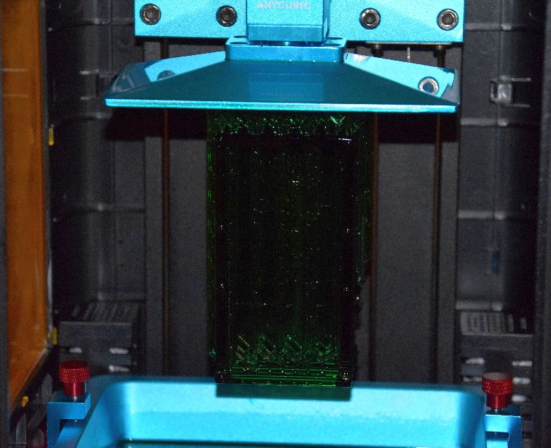

OK, No.1 lesson learned!

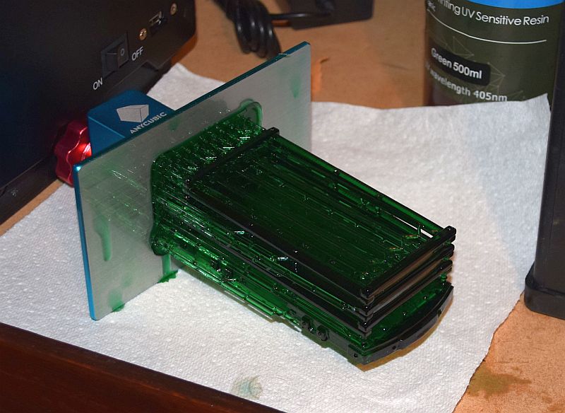

I turned the drawing through 90deg and tipped it to almost vertical to ensure nothing was out of limits and tried yet again. This time it worked and 10 hours 50mins later (Yes, really), the build plate lifted up with the wagon suspended below it.
The model was removed from the plate, washed in IPA and then put under the UV lamp for an hour.

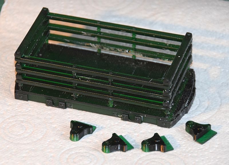

Next comes the exciting part, removing all the supports.
At this point I learned Lesson No.2.
I have watched various YouTube video's and seen references to never using the Automatic support generator feature in the slicer, but decided to use it anyway and found out the problems the hard way. If the supports run too close to the model there is a danger that the slightly viscous resin will bridge the gap and fuse the model to the supports, and that is exactly what happened. Some of the supports have to run between the bars of the slate wagon which leaves very tiny gaps and on one side they did indeed fuse in several places. Getting them separated left distinct scars on the bars which can be seen on some of the pictures. However that aside, cleaning up was not difficult, the resin sands and files quite nicely.

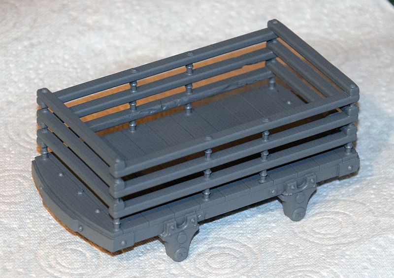

Now in works grey to show up defects:

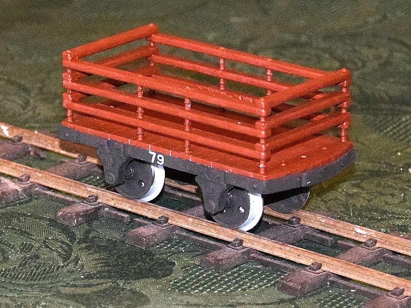

....and with a quick paint job.

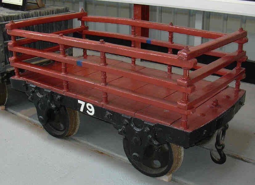

The wheels were quickly printed just to see the complete effect because I haven't got any 'proper' ones in stock. Also, I know there are some differences from the prototype photo, mostly down to my drawing but easily correctable if I wanted to actually build and run a slate train. Although the 11 hour print time seems excessive, included in that is all the detail such as rivet and bolt heads, nuts and washers, the turned spindles, planking, corner plates and anything else required, which I reckon is a lot quicker, easier and cheaper than trying to fabricate or buy in.
I weighed the print after curing and before removing the supports and it came out at 50.3g. Since the resin is £13.99 for 500g, that gives a cost of only £1.40 for the print. However there is also wastage in the washing plus the cost of the IPA, so a generous overall cost would be about £2.50 -£3.00 ( plus wheels) for the detailed model.
