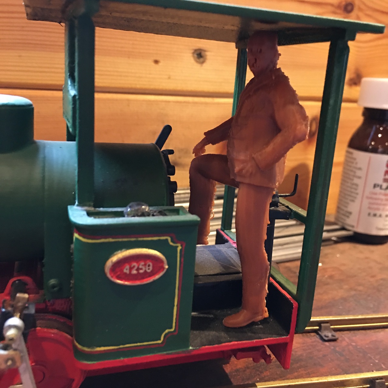

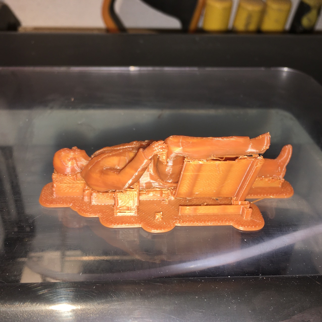

I have also been playing tentatively with makehuman and blender. My early attempts are encouraging:
A first attempt at a driver (5ft 3inch tall) as it was printed:
and in a suitable position:
Not good enough yet but it is encouraging me to learn more. The bent leg needs to touch the footplate and the arms need moving. It is interesting to see how easy it is to make figures which are properly proportioned and the correct height this way.

Trevor Thompson wrote: Sun Nov 22, 2020 10:29 pm The bent leg needs to touch the footplate and the arms need moving. It is interesting to see how easy it is to make figures which are properly proportioned and the correct height this way.
You are doing well, congrats.
FWIW, when I did my diesel driver figure ( the one which both Steve and I printed using different machines) I wanted his hands to touch two different controls and I also had to move his legs slightly. I started by trying to do it by eye which was hopeless, too many 3d position variables. In the end I imported the basic shape of the cab console into blender, then stood the figure in place and moved his limbs to where I wanted them. Doing it like that you can spin it in all directions to check, because what looks Ok from one direction can look totally unatural and distorted from another.

Really helpful series of photos, Trevor. Interesting to see the various ways you've tried to get successfully printed sections.
Clever idea to use a 3D drawing of the cab to get the driver's limbs right, Philip. It reminds me of the solution to the fox, chicken and grain, rowing boat problem πŸ€”πŸ˜

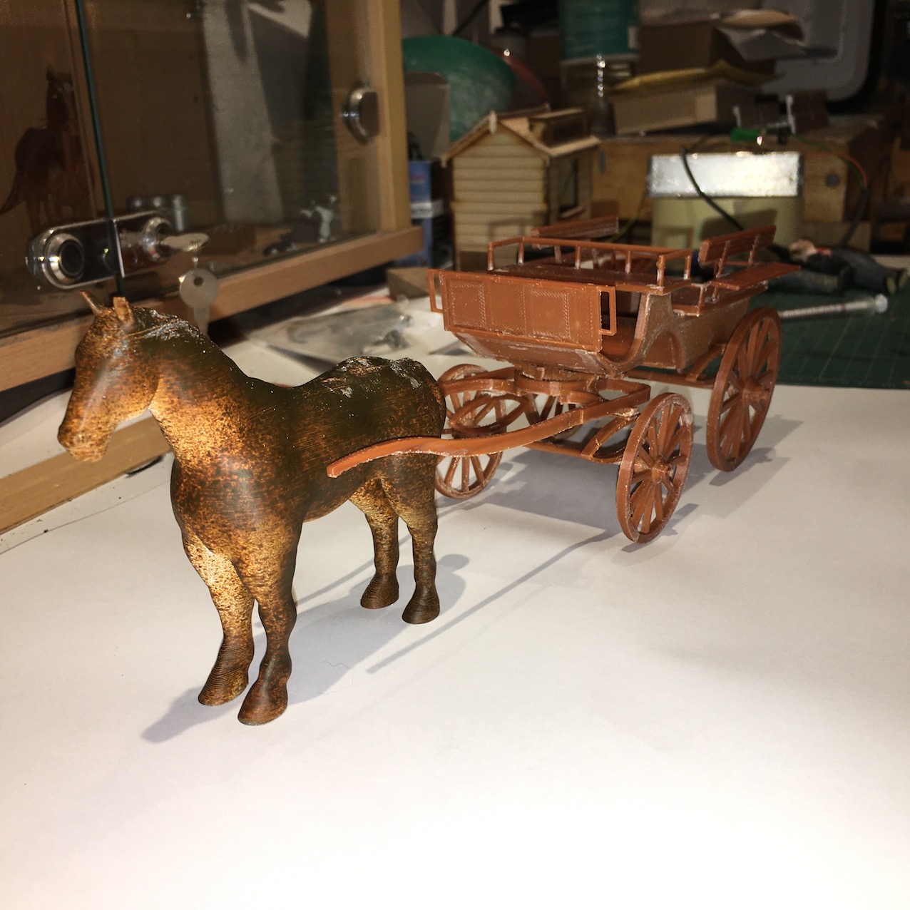

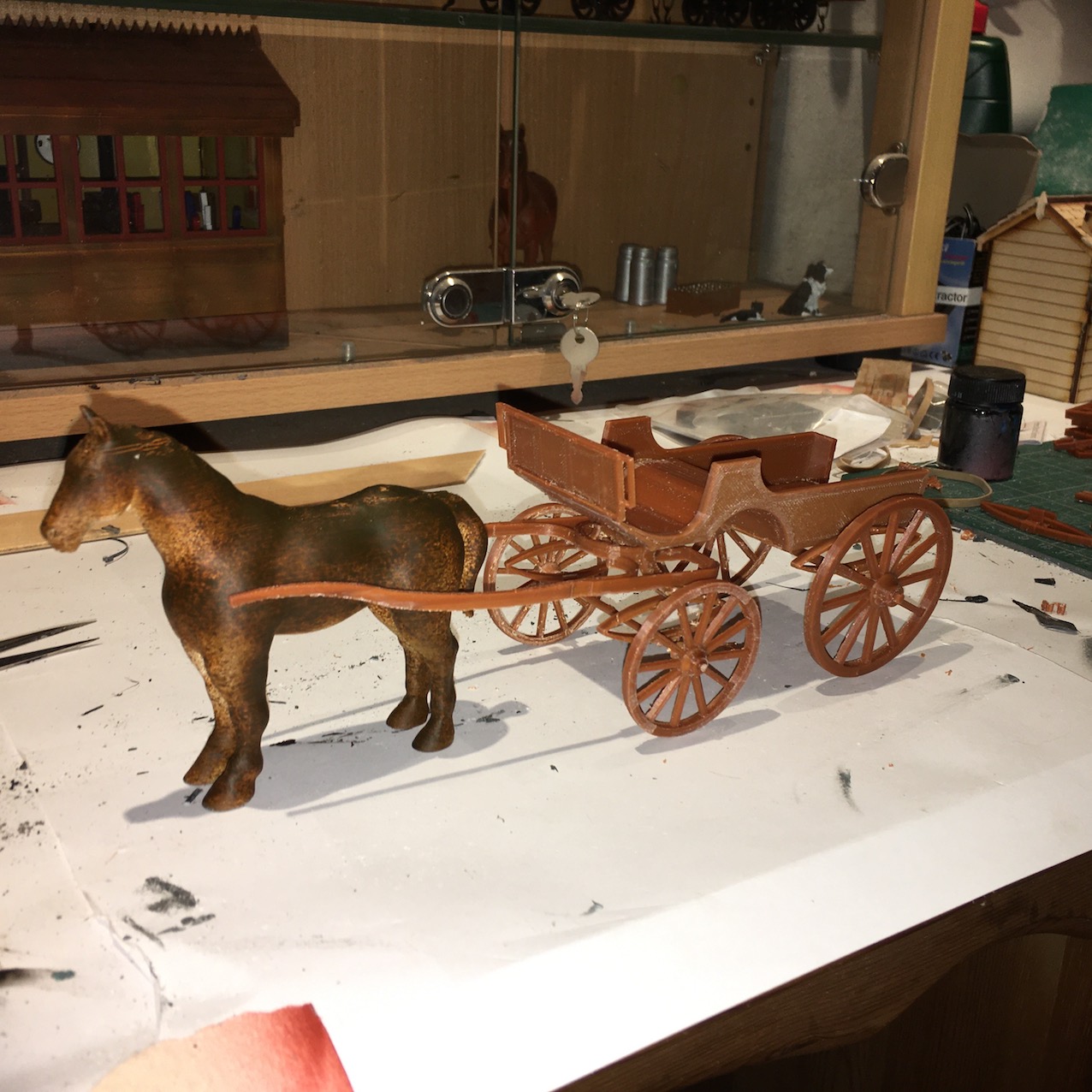

An update on the wagonette.
Successfully assembled the wheels axles and suspension. The suspension was a bit fiddly to glue together. The drawbars and fifth wheel were tricky to clean up. Printed as an assembly so lots of support filament to get free:
I am printing the seats and backrests at the moment. The model is reasonably delicate. Not something you would want to leave out in all weathers . On the other hand it is strong enough to be handled. It is a compromise between beefing it up so much that I loose the delicate appearance of the real thing, and it being so delicate it disintegrates when someone touches it.
I thought this would be something to "dress" the railway with when visitors are coming to run trains, rather than a permanent installation and i think it will fit the bill.

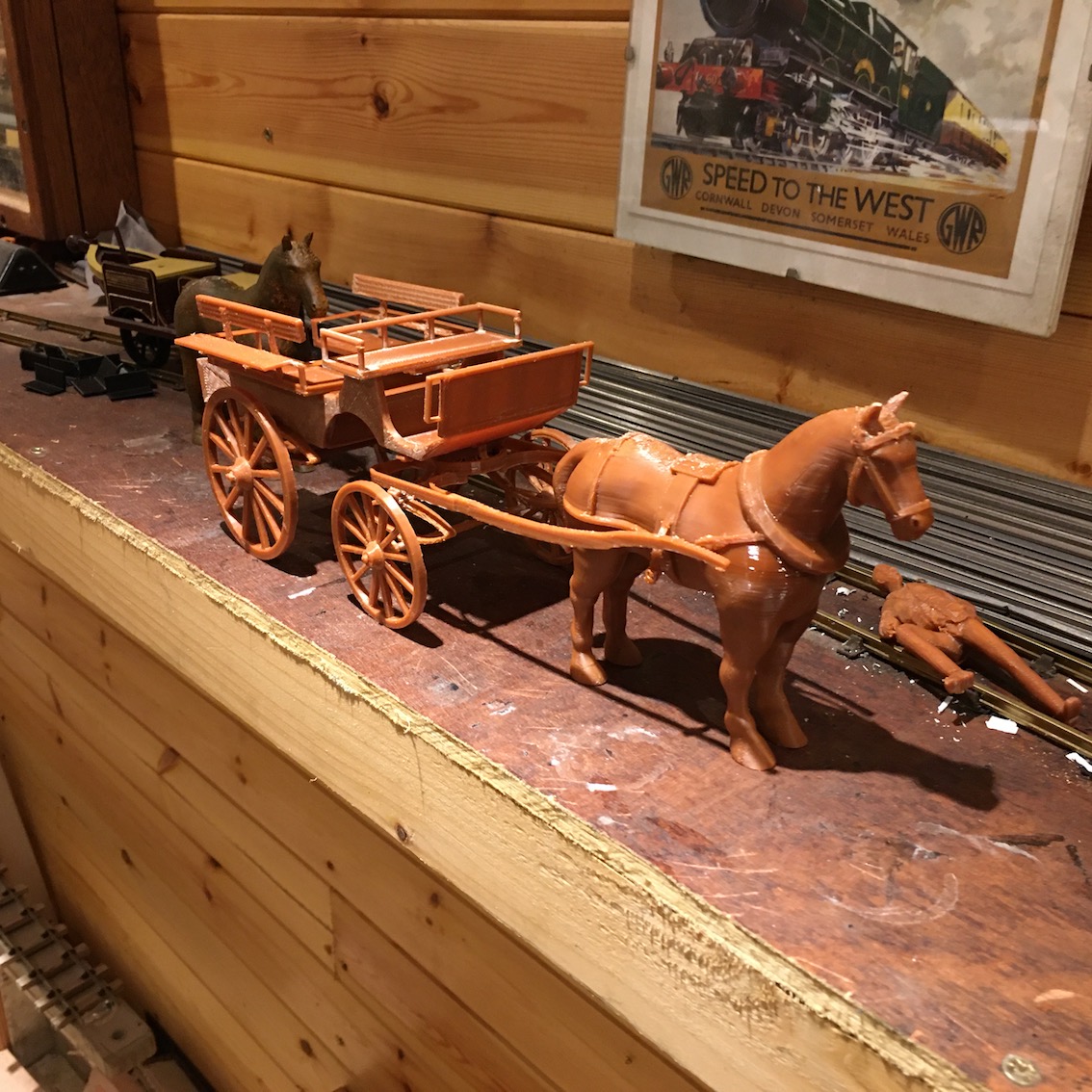

Post by Trevor Thompson » Tue Nov 24, 2020 10:02 pm
Firstly let me show you the finished wagonette:
The rear door is meant to be sloping down at an angle - the rear face isn't upright - it slopes at the same angle.
The detailing was not easy to print because much of it is so delicate. This is what worked best: The drivers backrest was printed upside down as a separate section. The passenger seat was printed with the end armrests attached, and sticking upwards. The passenger backrest was printed with the mudguard and the two support frames in one piece with the inner face of the backrest on the bed and the mudguard sticking up in the air.
The horse was just a test to find the correct type of horse and the correct size - and to check it would print. It was printed upside down by the way.
As for the harnessing or tack - I am about to create it and add it to she horse before re-printing the horse. Some of it will have to be added later - but the basics should be possible in sketchup. Well lets see how it works out!

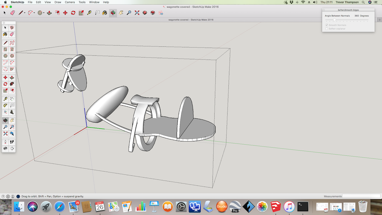

I have now drawn up the horses "tack", or at least an approximation to it. This is what I am currently printing:
Screen Shot 2020-11-26 at 21.10.53.png (536.38 KiB) Viewed 11412 times
and in case you are wondering how I created it:
Screen Shot 2020-11-26 at 21.11.12.png (415.24 KiB) Viewed 11412 times
The elements are basic circles pulled to give thickness and then distorted to make them elliptical. They are then superimposed on the horse so that the centre of the circle is inside the horse. After that it was just a matter of cutting away some parts of each element and distorting others.
Perhaps the cleverest bit is the collar. That is a combination of making a circle, turning it into an ellipse, and then pulling for 1 mm. Change the size and pull again. repeating that to make the basic shape. Making the top thinner was done by grabbing one of the ellipsis and rotating it to make the top thinner. Then repeating that with the next ellipse. Finally the whole thing was treated using the soften/smooth edges window.

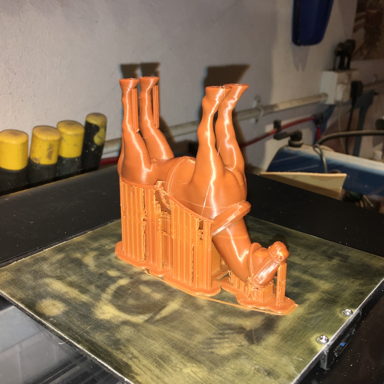

So the result of the overnight print (7.5 hours by the way):
I printed it upside down because this is how I have achieved success with horses in the past. You can see if you look carefully a light line on the horses neck and another parallel on his "chest". It is where the print has shrunk during the printing process. I will try a higher extruder temperature next time. The problem with printing them this way up is that the roughest parts of the finished item are on the top where they are so obvious.
And with the support filament removed and a bit of a clean up:
There are some errors. Firstly the harness around the horses chest has a gap just in front of the girth. Secondly the collar is at an angle. Very difficult to control how you rotate a curved component. I will fix these errors and try again - perhaps the right way up to see what happens.
