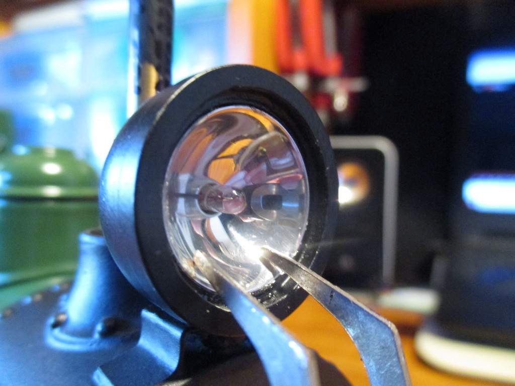

I wasn't happy with how the RH Darj. headlights looked. The bulbs, arranged vertically, looked more like the glass chimneys of early kerosene headlights, and being mounted that way, certainly weren't bright enough to represent Stones electric lamps in operation. The internal surfaces were sprayed with Alclad II's "chrome", which I must admit looks excellent, but in the end was no less trouble than simply machining proper reflectors, as I should've done. The domed glass wrist-watch lenses, once fitted in place of the plastic lenses supplied by Roundhouse, helped obfuscate this shortcoming, but they really needed gutting and re-doing properly.

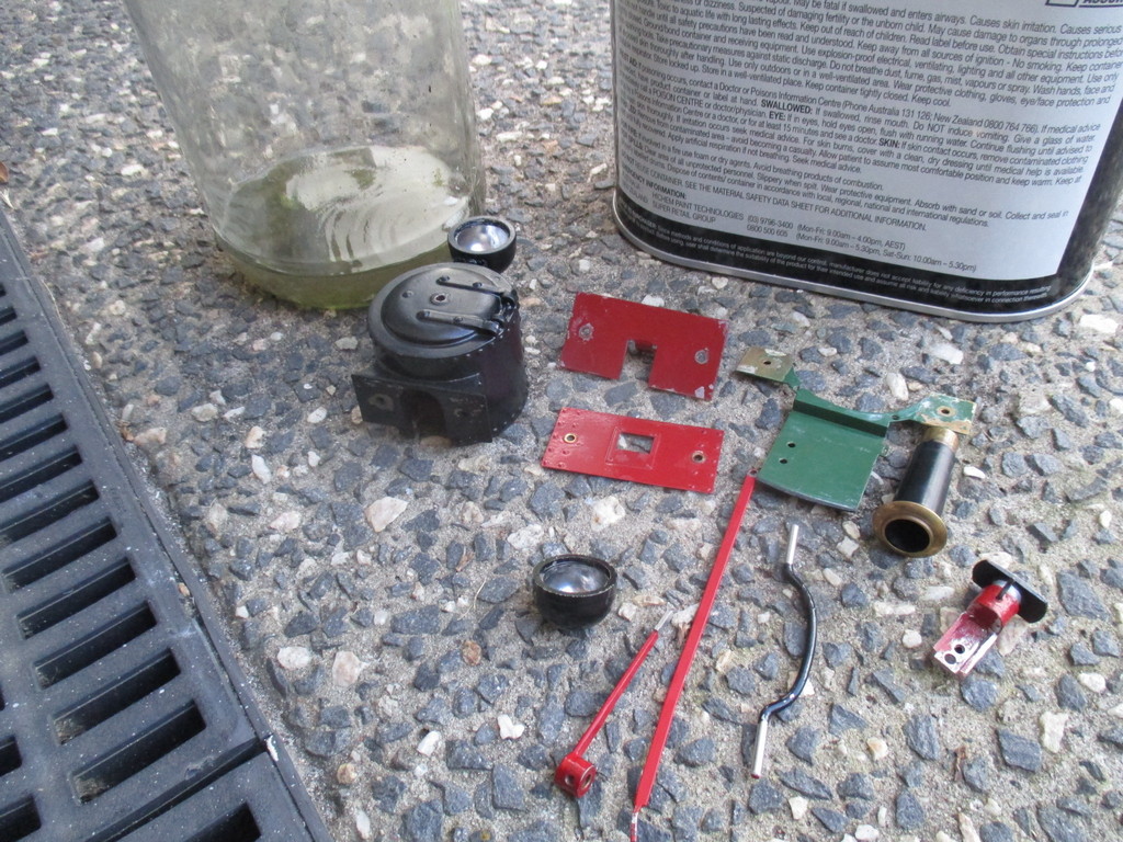

By early October, I was able to make a start on this loco. I was going to do a blow-by-blow write-up on the pre-cleaning and weathering, so that others might have a go at weathering their own kettles. But this loco differs from the last (first) live steamer I weathered, (An Accucraft Ruby) in so far as that loco was a complete strip-down to bare metal and full repaint. Which is of course easier, because virtually all of the oil comes away with the paint, when stripped in lacquer thinners. Any residue is dealt with in the usual surface prep routines.
This loco is very different. I need to fully, properly de-grease it without damaging the paint-work. There's also the matter of the motion being more complex, and not only is it an unusual case in that it's painted, but I also want to avoid the inevitable paint-wear and hassle of having to re-time it when I'm done. So this loco is very much a learning experience of it's own. Once it's finished, I'll have another Roundhouse-based loco to receive the same treatment, a Bundaberg Fowler. By then, I'll have worked out my technique, and can properly document the preparation and weathering - along with the other detailing and improvements that loco will receive.
In any case, "Victoria" had a handful of parts with rushed, lumpy touch-ups of areas chipped during final assembly. Weathering was as likely to highlight these, as much as hide them. It was quicker and easier to strip these bits in a jar of thinners and repaint them. Not shown is the cab roof which was also stripped.
Before dismantling, the loco was hit with automotive degreaser and washed down, taking care to avoid the lights fitted in the dummy ashpan under the footplate. This dealt with the "heavy" soiling of oil - Not that there was much, being a Roundhouse, having done little running.
Once dry, the loco was pulled to bits and individual parts degreased again, to remove any heavy soiling trapped by assembly. Note the motion has been removed from the axles, but is otherwise assembled. I think with some care, I can clean the motion ultrasonically, then give it a light-coat repaint (because I'm now using a different shade of red) without dismantling it and losing the timing. If I'm successful, I'll do it again on the Bundy and record it properly.

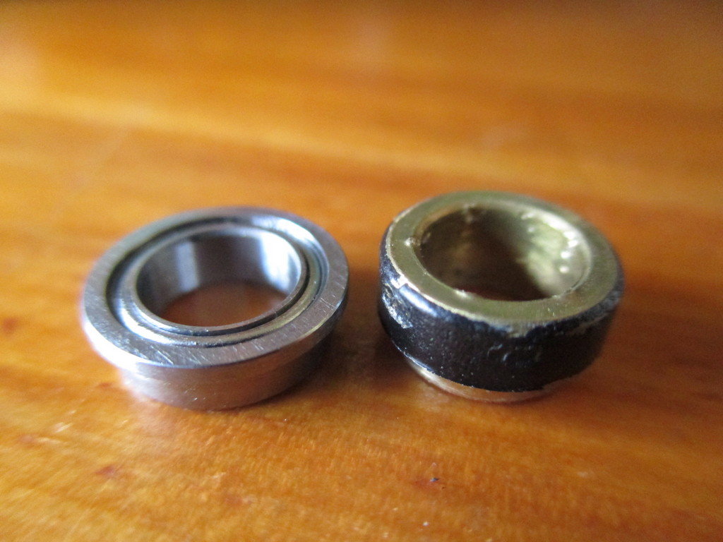

Speaking of oily messes, I noticed oil from the bearings quickly tends to run down the frames and "pool" along the bottom edge. In my book, shiny oil running over a matt, weathered surface defeats the purpose of weathering itself, so I'm going to minimise that by replacing the plain bronze bearings with ball bearings. Sealed bearings of the right dimensions are hard to find at any remotely reasonable price and quantity.
I ended up ordering some from Yankeeland on Evilbay. That was in May, to allow plenty of time for them to arrive; orders from there usually take 2-8 weeks to reach me in Southeast QLD. If you've not already figured, I've yet to see them. I presume The PlagueTM to be mainly responsible, and don't expect to see the bearings any time soon, if it all.
Searching for another supplier yielded only shielded bearings, which aren't preferable, but may work. It does mean that I can no longer periodically spray-degrease this loco and wash it down. But as a Roundhouse, it doesn't really make a mess of itself, and when needed, I can clean the motion with rags and careful use of a squeezy bottle filled with white spirit.
The new bearings being much thinner than the originals, and may have me turning some spacers to fit behind the cranks. Or, I could hand-strength loctite the axles into the bearings to prevent sideplay

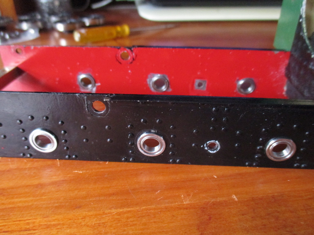

Going past the point of no return. After removing the plain bearings, the holes in the frames were drilled out to 9.5mm for the new bearings, which were fitted with a little retaining fluid. Worst case, and ball bearings don't work out, I'd just have to buy a ¼" reamer and machine six new bronze bearings to fit the enlarged frame holes. All things considered, that wouldn't be too bad.

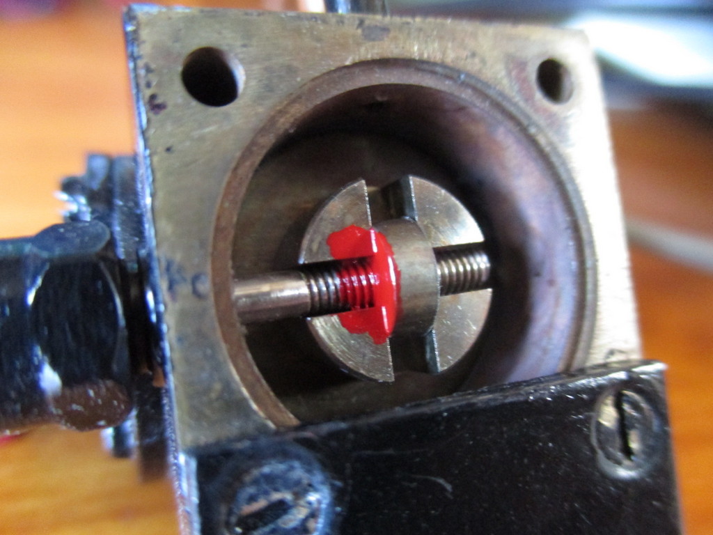

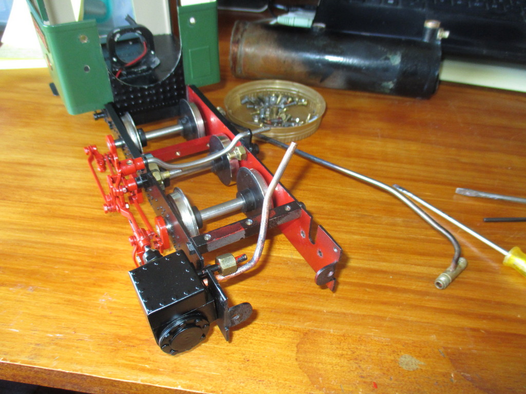

In order to properly clean them, the valve chests (and therefore the valves) had to be removed. This would upset the valve timing. So in order to put the valves back correctly when I'm done, the covers were removed, the internals of the valve chests degreased and scrubbed with meths, then once dry, a dab of acrylic paint was applied where the spindle screws into the valve. After that dried, the valve could be unscrewed from the spindle, and the spindle withdrawn from the chest. Before removal, the top of the left and right valves were marked "L" and "R" with a scribe, just in case of any tiny difference between the two. That also shows me which way to orient the valves during re-assembly.
It goes without saying that I should probably photograph that process for anyone new to that sort of work, when I properly document the process on the next loco.
I neglected to photograph the process of thoroughly cleaning components, because I'm learning as I go. Long story short, the cylinders, after a few trips through the ultrasonic cleaner, are receiving some extra detailing because they're so prominent on a Fowler. Roundhouse kindly sold me Silver Lady cylinder overlays for three locos, along with an unpainted pair of their clip-on covers. With a bit of hammer-fettling of the clip-ons, their fit was slightly improved.
When fitting the front covers and SL overlays, I substituted the supplied M2 cheeseheads with hex-heads. Whilst the heads are twice as thick and of slighly larger width than the etched dummy bolts of the SL overlays, it really improves the appearance. It's even the right number of bolts for Fowler cylinders. The aluminium disks originally fitted during construction were made to mimic the small decorative covers fitted to most Fowlers.

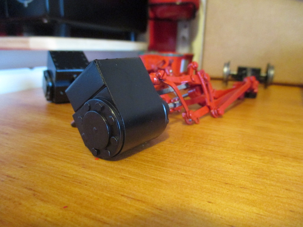

The cylinders were painted with "Low Gloss Black" engine enamel. I prefer to use black etch primer, as when paint chips, it tends to leave the primer behind - and a chipped or worn area with black primer underneath, is a lot less noticeable than the usual grey primer. It's more expensive and difficult to find, though.
The cylinders really need a pair of valve spindle guides sticking out from the front of the valve chests, but those are beyond my capabilities to make. As a lost-wax casting, or even pre-fitted to a variant of DJB's cylinder covers, I do think they would sell reasonably well. They'd be ideal for the numerous Fowlers about, along with the less common Bundy Fowlers and 16mm "Victory" Decauvilles, in addition to anything else with standard RH cylinders. I can even provide photos and measurements of the prototype. I should speak to DJB about it..

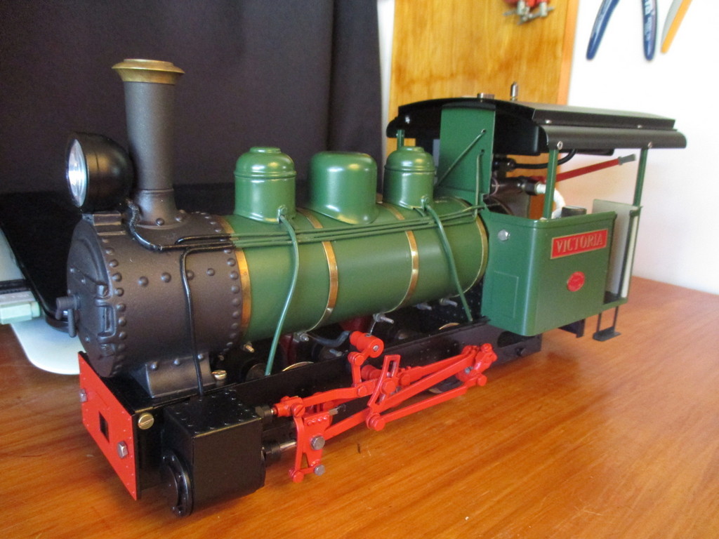

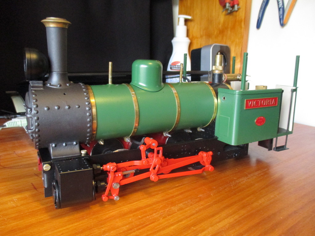

Back to "Victoria", which is quickly coming together again. Cab walls were brush-repainted with a mix of flat Tamiya enamels. I forgot to repaint the boiler's aft section and the lubricator, so I may brush paint them and weather the interior, before proceeding much further with re-assembly.
I think I'll leave the brightwork to dull by itself, as anything I apply to it, is liable to chip away and look even worse. The smokebox was painted with the same stuff we use on full-size smokeboxes at Woodford - Potbelly stove paint. That one's a bit annoying, as it requires baking to cure. The headlight was later sprayed with the satin black engine enamel, though I've yet to brush paint it's mounting bracket to match. Will do that and any unpainted fasteners during final touchup before weathering. Everything else has been painted and awaits re-assembly. More of the same for the tender, is yet to follow.

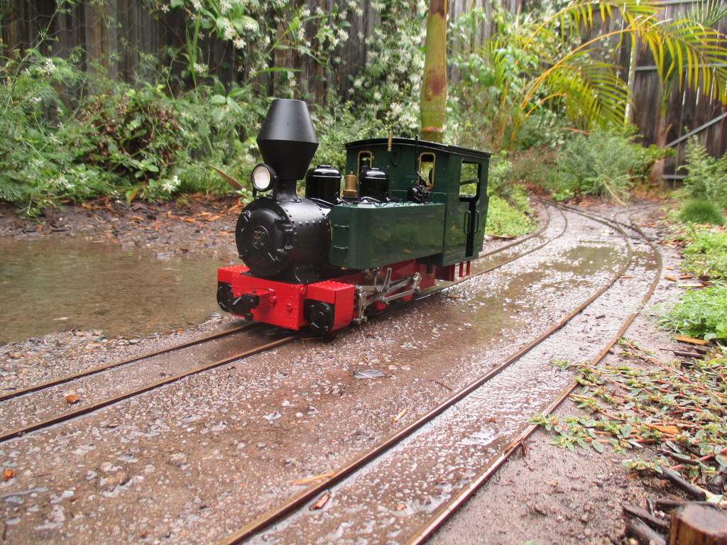

I love the photo of loco running in the rain - it looks "very realistic" :thumbright:
Keep up the good work Aaron - all the "toy like" gloss converted into dull flat paint does wonders for the appearance of your loco.
I hope you will eventually get it "properly dirty" as well :mrgreen:

Speaking of weathering, the loco certainly will receive more, once it's all re-assembled. Weathering powders and Tamiya enamels seemed to work well on the now-sold "Baron". That weathering came out a little too subtle, and was more noticeable in person. It represented a loco that was worked hard, but very well looked-after.
"Victoria" will receive a somewhat-heavier treatment. I've realised the brightwork on the footplate would best be obfuscated a bit, so a bottle of gun black is on it's way. I've done no other work beyond that, (or even checked the forum until yesterday) due to having a "crash" period.. Might have some more progress to show in about a week or so; Will start on the tender once the loco's just about re-assembled.

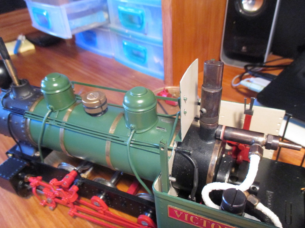

I thought about removing that horrible bright white insulation from the steam pipe, but I'll just brush paint it a dirty grey when I get to weathering..
03/01/20
As I'd like to lower the height of all my couplings from the 16mm standard of 25mm above railhead, to 18-20mm, I figured the easiest way to do this was to replace the standard LGB-style-mounted couplings, with their stud-mounted equivalent. To provide a mount for the stud & nut, I'll find some suitable brass or steel plate, drill a hole in it, then JB Weld it to the backside of the standard RH headstock.
After refitting the pipework, domes and spectacle plate, the new bulb was painstakingly soldered into place. Careful use of heat shrink and epoxy glue should prevent any shorts, (touch wood) and the machined reflector glued in with more epoxy. A pair of tweezers held in a small bar clamp laying on the bench, stops the reflector from falling out as the glue sets. Looks good when supplied with 3V, so far, but will have to fit the lens and test the lamp in the dark, yet..

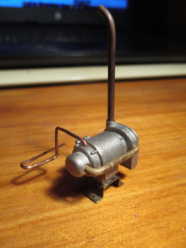

The Roundhouse Stones generator was detailed next, referencing an old Stones service manual I have as a PDF file.
Once the glass lens was fitted to the headlight, I put a pair of batteries in the tender and plugged it into the loco. When machining the reflectors, I just did 'em by eye, so the shape looked about right. I didn't expect it to reflect the light this well! Camera doesn't do it justice; it projects a nice solid beam about 12ft/3m ahead, on 3V. Extremely pleased with this, couldn't have asked for a better outcome.

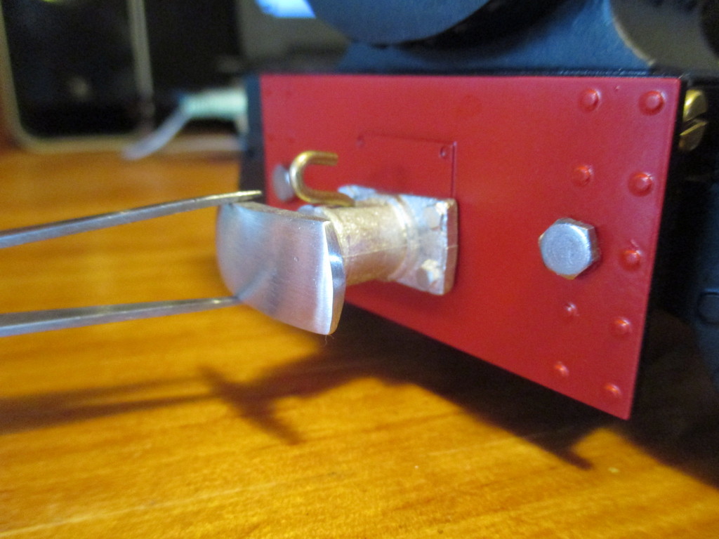

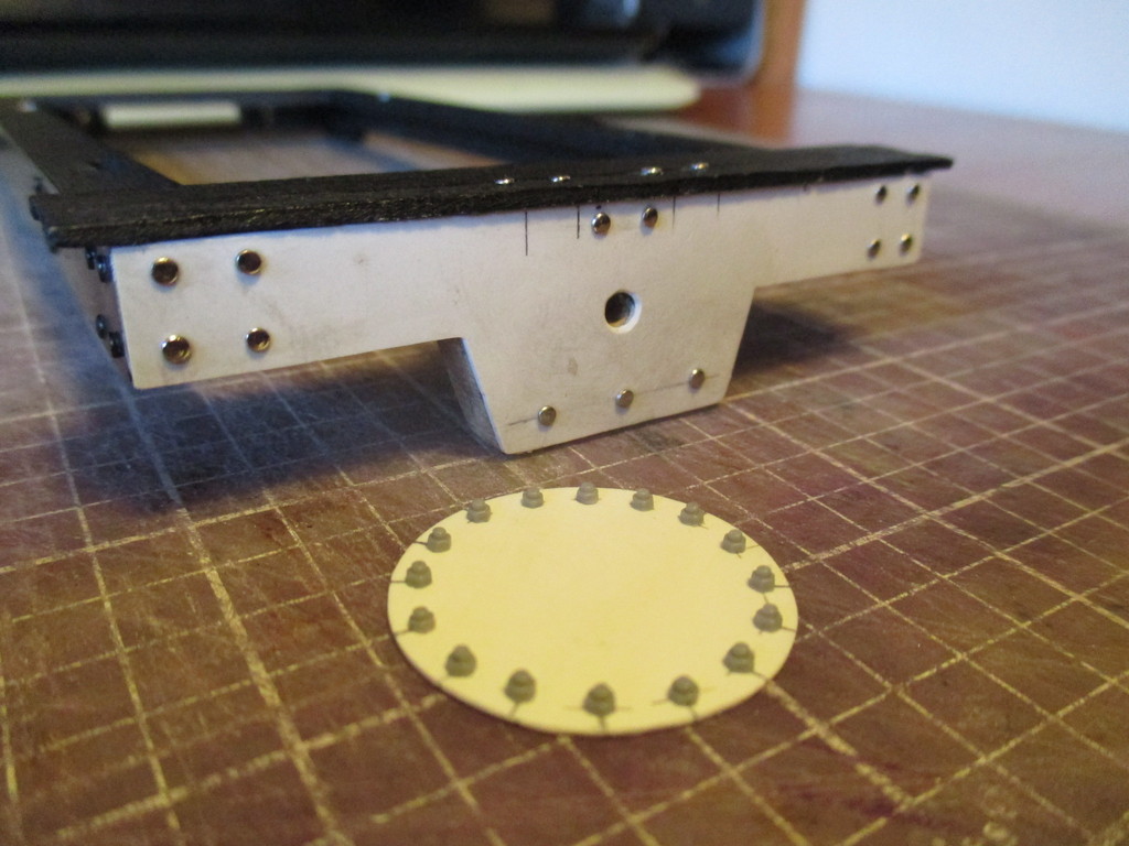

After dismantling and cleaning the tender parts, the rear coupling mounting height was lowered by 5mm in typical industrial fashion - heavy timber extension, faced with ½" steel plate as reinforcement. In reality, I glued two pieces of 6mm square oak together, cut down their ends to a taper, then JB-welded them to the tender frame. After it cured, sewing pins were fitted from top and bottom as mechanical reinforcement. The "½" plate" is 0.5mm styrene, with more sewing pins as rivets and "bolts". Quietly confident this will hold up to operation..
The round plate is for internal access to the tender tank, based on prototype photos. The water hatch is too small for grown human access.

The access hatch and a Roundhouse toolbox casting were fitted with epoxy, and the coupling JB-Welded into place. I don't know if the latter will stay put, or be ripped out during a run - there's no room for a nut behind the headstock. I might drill and tap an M2 hole from the backside, and put a spare screw in there to hold it..
Rear headlight was wired up and works as nicely as the front does.

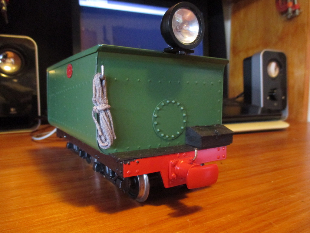

Baking twine, dyed with an acrylic wash, makes for a nice scale shunting rope; The twine was wrapped around two fingers, then removed and manipulated to give it that characteristic "sag" of heavy rope. Superglue was then sparingly soaked into the twine, to hold it's shape. A flat clearcoat hides the superglue's shine, and was followed by a wash of black, to highlight the rope's texture.
In truth, I'm just hiding the soldered joint at this corner of the tank. I didn't align it very well during construction, and I'm sure as hell not stripping the thing to re-solder it..
All is now ready for touch-up, prior to weathering. Before that, though, I'd like to add water hoses between loco and tender, so some dummy water valve castings are on their way from Ozark Miniatures..

After finishing touch-ups some weeks back, a thick wash of dark (sooty-coloured) grey Tamiya enamel and mineral turps, with a tinge of brown, was brushed over a few square inches at a time. Then with a clean rag, wiped, swirled or dabbed off, leaving (I think) a suitably sooty, grimy residue. It was applied to every nook and cranny including the interior; for which of course the roof was removed. Should've done it before refitting the controls, it would've made for a faster, easier and better result.
It's not the best photo, I should've taken the loco outside first. You'll notice there's a fair amount of lint on the surface - that was from the rag I used, and it's both difficult and time-consuming to rub away. Next time, I'll try using paper towel instead; failing that, I'll bite the bullet and buy some lint-free rags for this express purpose. After a few days to dry, the entire loco and tender were sealed with the earlier-used satin clearcoat. The motion, smokebox and a few other spots will need another hit of wash tomorrow.
The water valves/hoses were painted during touch-up, before the wash-n-wipe treatment.
Recesses to accommodate tiny magnets, were cut into the crewmens' boot soles, by offering them up to an end mill spinning in the drill press. After that, the fireman was painted. Fitting the crew around the controls was tricky; they don't quite face the directions I'd like, but they'll do. Magnets were fitted under the footplate to hold the driver in position. Under the fall plate however, there's not enough room to fit magnets for the fireman. Consequently, the brass fall plate was replaced with steel, and I'm hoping that'll be enough to hold the fireman in place.. The water bag is a very nice casting from Ozark Miniatures; I bought enough to equip all my current and planned locos. You may notice the pony wheelset hasn't been re-fitted - I don't want it swinging about and chipping it's own paint off against the cab steps. Refitting it will likely be the very last thing on the list.
The fire irons were fitted, having been made from brass sheet and copper wire over a year ago. I forgot to apply the grime wash to the water hatch, so it's on tomorrow's to-do list..
