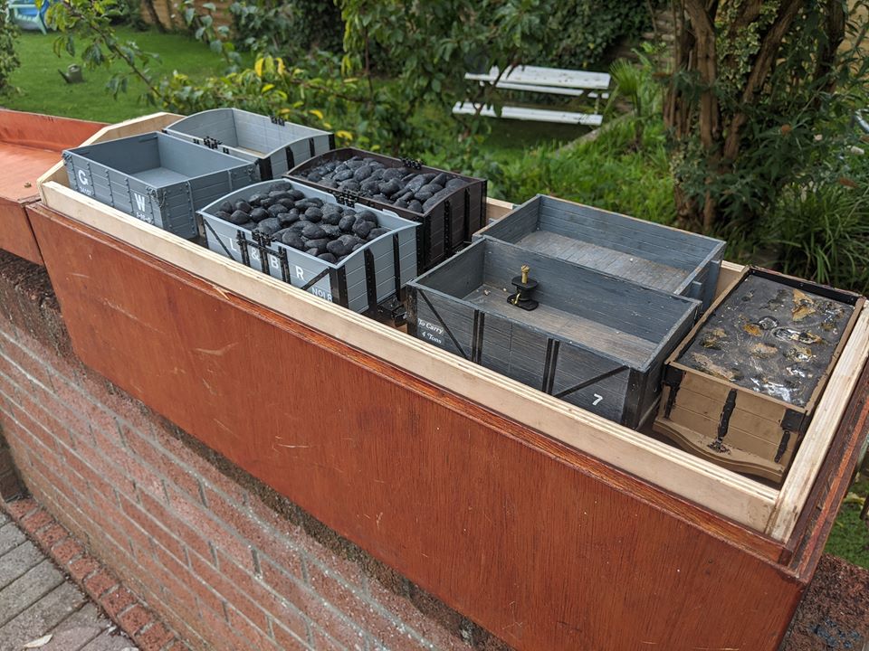

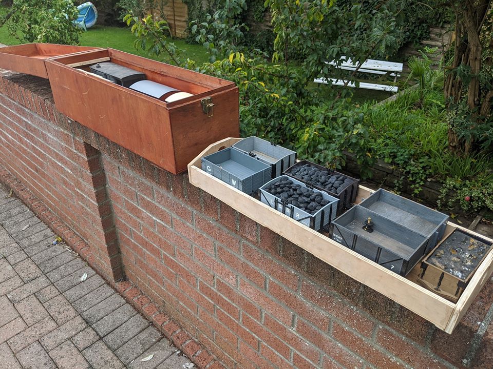

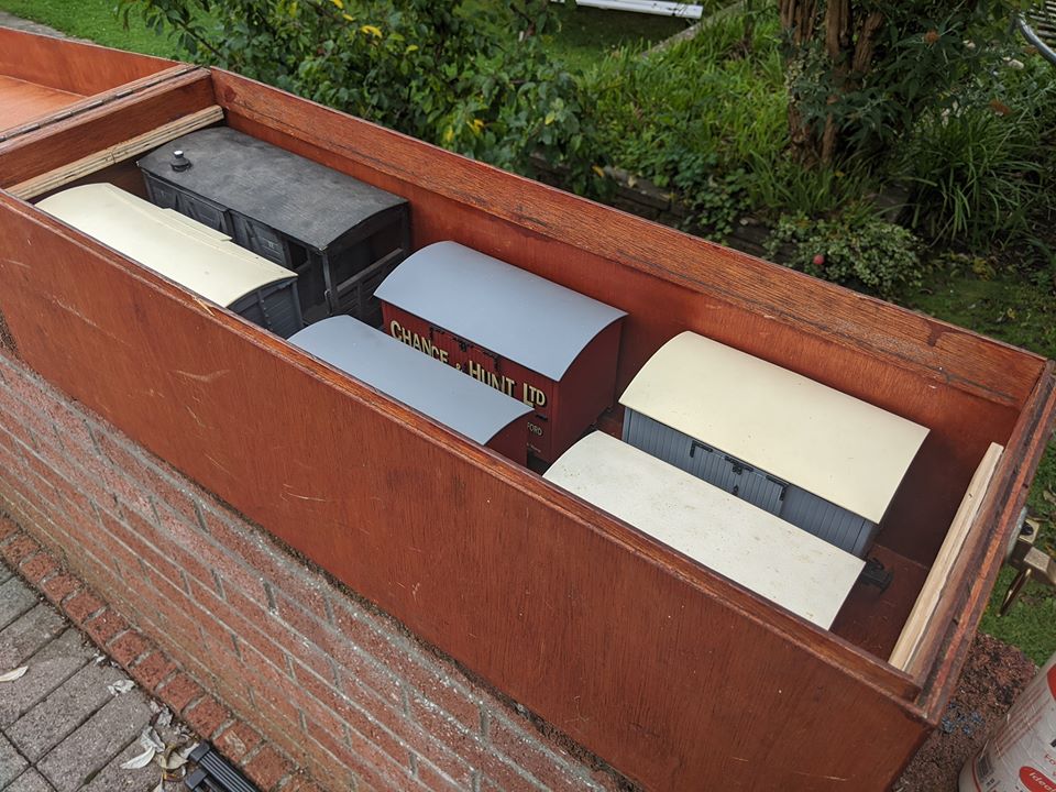

A pleasant little job yesterday afternoon adding a second level to a Locobox box I had knocking about to make it more suitable for storage and transportation of rolling stock. 4mm plywood base and 12mm ends. Might provide some inspiration for someones stock storage.
Just got to build boxes for the loco fleet now think I'll build another box to take my rake of IOM Pairs coaches and a short rake of 4 wheel coaches.

Nice work there, and very tidy. I should really get on with making some stock boxes myself..

Just to add as it may not be clear, I did not make the box, just the tray.
I'm going to make a set of boxes of standard width and height with varying lengths for the loco fleet. A friend with a well equipped carpentry shop has been collared to run the plywood sheets out for me - a quick job in his workshop but a bit of a faff in mine!

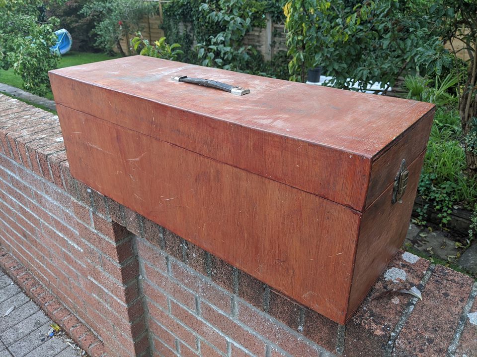

Be interested to see your stock boxes Graeme. I'm undecided how I want to access my locomotive boxes - I've currently a couple that 'split in half' like this one, and one that has a flap on the end. I saw this one with a side flap in a YouTube video that I rather like.

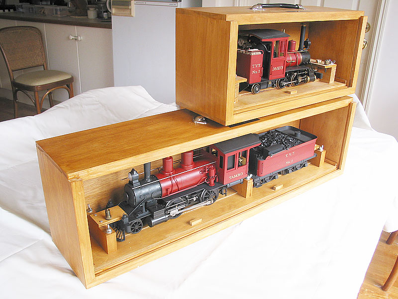

This photo shows my standard small loco box, made from 6mm ply and 170mm x 19mm dressed pine. That isn't a standard board size in Aust., so I have to rip down 184mm x 19mm dressed pine, which is where the Triton Workcentre comes in. The front slide and the back of the case are 6mm ply, so the next step for the pine is a trip through the router table to cut a groove on both sides of the board to house the back and provide tracks for the front slide. The top and bottom are then cropped from the the board using the saw bench and the top and bottom have steps routed out to locate the ends. The top then has a piece cut off which forms the top lip of the slide.
Glue it all together with yellow PVA woodworking glue and clamp it up with band clamps until the glue dries, usually overnight. Finish is stain varnish, which seals the wood and stops water and oil from locos staining it. As well as the carry handle fixed to the top, there are also rubber feet fitted to the bottom. These stop damage to table tops and other cases and also clear the handle so the boxes can be stacked and remain stable.
The photo also shows the cradle used to stop the loco rattling around inside the case. The longitudinal strip of 3mm ply locates the wheels (much easier to make and fit than routing two grooves) and is 39mm wide in my case, as I run on 45mm gauge tracks. The clamping blocks are made to match a particular loco and have felt pads where they contact the loco when screwed down. One, or sometimes both, are removable so the loco can be rolled off the cradle onto the track. The little block at the front is there to make it easy to slide the cradle out of the case.
Case 7.jpg (116.65 KiB) Viewed 9950 times

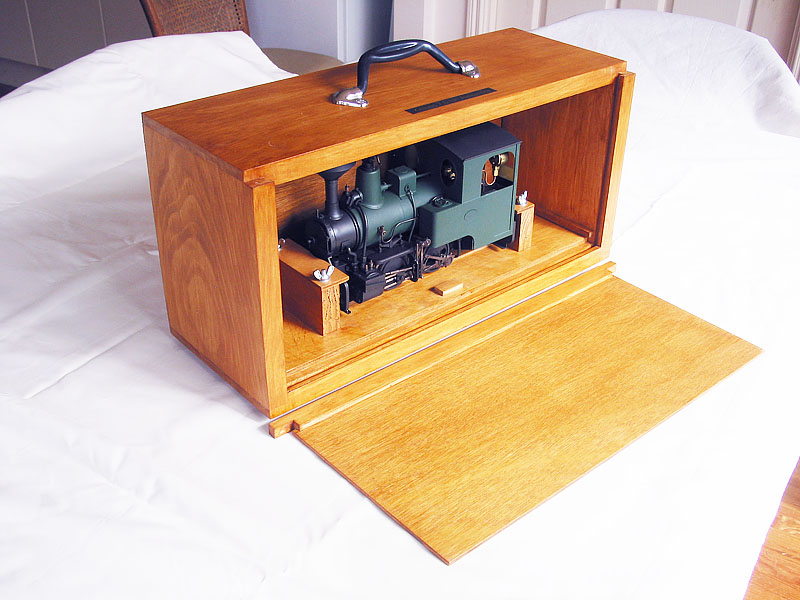

The next photo shows the case with a loco in residence. I try and make all the boxes to the same internal dimensions, so the cradles are interchangeable. The original plan was to have only a couple of boxes, but as the fleet grew, I found they were also good for storage as well as transport.
Case 8.jpg (127 KiB) Viewed 9950 times

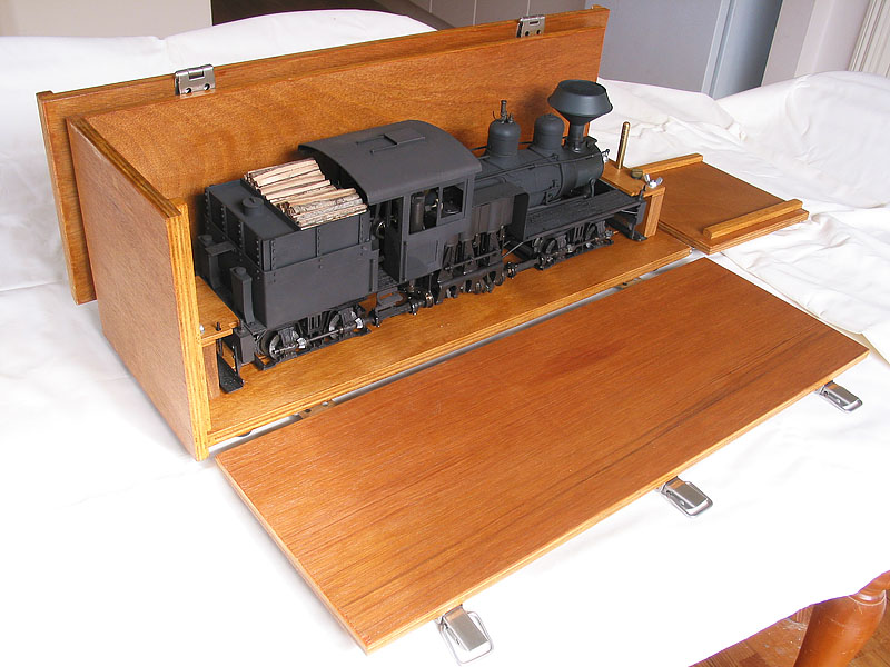

The last loco case photos shows the Shay in the ply box made by Accucraft and used to pack the model. Instead of their usual nested cardboard boxes, this replaced the inner box. The Argyll NA class model was supplied in something similar. All I've done is to fit feet, a handle and stain it. It came with two grooves already in the bottom, so I didn't make a cradle, just added the clamping blocks.
The first photo shows it locked up for transport, the second opened up to show how it works. Being plywood, it is easy to make, as you just need to rip a sheet of 9mm ply down into the necessary width strips and dock them to length. My IOM railcar came in the usual two cardboard boxes and I was going to make one of these for it, but I was unable to source suitable catches locally.
Case 11.jpg (119.27 KiB) Viewed 9950 times
Case 12.jpg (130.26 KiB) Viewed 9950 times

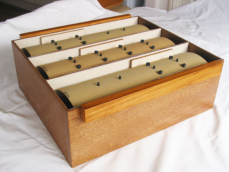

The next couple of photos are my rolling stock storage trays. The first one has three passenger cars in it, but the bogie wagons use the same design. The only variation is that the ones for open wagons aren't as deep. The spacers with the felt pads are there to stop the models rattling around during transport. The footboards are wider than the carbody, so the spacers fill the resulting gap and stop things moving around. Much easier to use than chunks of foam rubber and less likely to get lost. The cleats on the side are there to locate the trays when stacked for storage and also provide convenient handles for carrying a loaded tray.
The timber bogies are stored in a similar tray, but they are shorter and narrower than other bogie stock, so they are mounted across the tray. That way the tray is the same size, but it holds five models, not three.

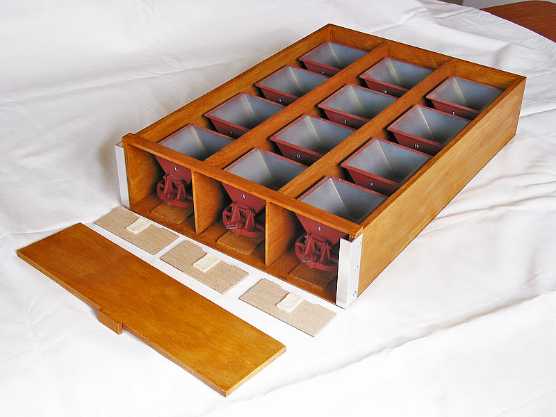

The last photo is a 'one-off' storage tray I made for the string of skips. They are semi-permanent coupled into rakes of four and there is an end slide so each rake can be pulled out onto the track and coupled up fairly quickly. They are a pain to transport, so they haven't left home to date.
