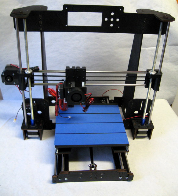

OK. It's taken a few days, but I feel I'm beginning to have something to show for my labours. The structure of the printer is now more or less complete - at least it does sort of look like a 3D printer!
It's certainly been an adventure to get this far.
The next stage is to add the electrics and electronics and then wire everything up. And then, of course, I'll find out if it actually works!!!

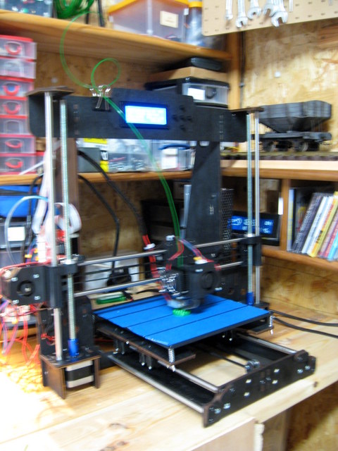

- Posts: 8051
Re: Prusa i3 3d printer
OK - the printer is now up and running .....
Sorry it's a bit blurry, it was getting late last night when I took this.
My first print out wasn't entirely successful ... .
A barrel, downloaded off the web for free. 2/3 of the way through printing it, one of the vertical guide rods became detached (partly poor design and partly because I hadn't tightened the restraining screw enough). However, as you can see the striations are fairly prominent. I'm not sure if this is because of the quality of the printer, the quality of the drawing or there are some settings which I can adjust to improve matters. I did increase the size from the original drawing, whether that makes a difference to the quality? Any suggestions?
My second model is a bit more successful - a pigeon basket which was often seen on rural platforms between the Wars. .
As it's wickerwork, the striations don't really matter. This was actually reduced in size from the original and maybe that helps?
Anyway - it seems to work. I've ordered more filament as I've nearly run out of the small reel they sent with the printer. My next job is to get to grips with Sketchup to make a drawing of the seats for the railcar .....
Interesting times.....
