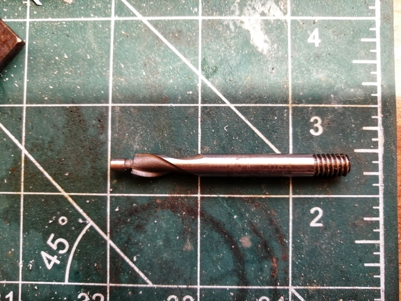

As I don't have a milling machine where you could use a mill cutter bit to face the holes I needed a bit that I could fit to the my pillar drill that would not wander all over the place (this is what I have learned is called 'chatter') when I applied pressure. I found a second hand 4BA counterbore bit with a stub online so that it would could fit inside the threaded hole and centralise the bit:
Unfortunately, when it arrived it was not 4BA sized at all so it did not fit the threaded hole. The seller measured the others he had in stock and agreed they were incorrectly sized so I got a refund but I was back to square one with what to do.
