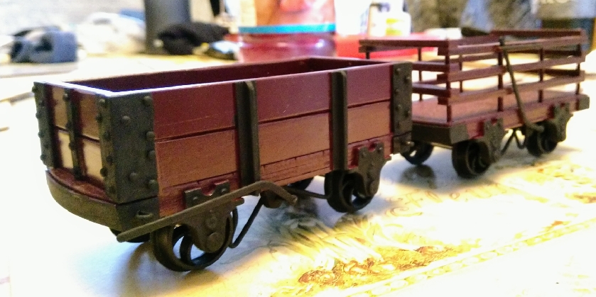

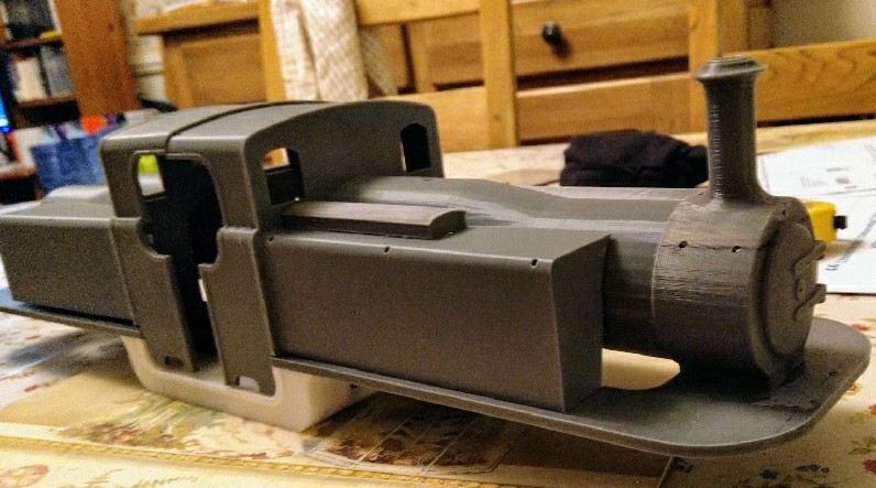

Whatever it is, post it! I'll start: PDF Double Fairlie. This one is being detailed with pipework, bunkers ect. Bespoke, laser cut steel chassis's will be used with steel wheels and rods.
Lineside hut slate waggon and scratch built NWNGR slate box wagon

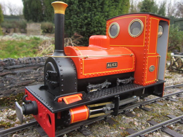

I'l be interested to watch progress on the Double Fairlie, having just finished my second Hunslet from PDF I am impressed by the kits and the value for money they offer. They are an excellent base to work on adding as much extra detail as you want......
The Lineside Hut laser cut kits are also well produced and make into good models.....
Like any kit, you get out what you put in, so a little additional preparation time always pays dividends.

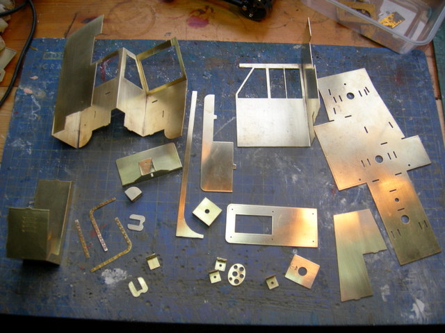

I've just dug out an enormous etched brass kit for County Donegal Railcar No.10 which has been sitting there for around five years.
1. I've never made an etched brass kit before
2. The kit does not have any instructions
I persuaded John Campbell to sell me a kit at the Llanfair Show - John is the chap who used to exhibit those wonderful operating crane layouts where sand was loaded and transported. He doesn't normally sell them but I twisted his arm by promising to make him a bespoke Deltang transmitter. I hadn't realised there would be no documentation with it so have been repeatedly putting it on the back burner.....
The brass is now quite tarnished and so it's not just a case of separating all the bits from the fret, they also need a fair bit of elbow grease before I can start trying to figure what goes where - and actually what some of the bits are.
Any tips on making etched kits would be most gratefully received.

You will need:ge_rik wrote: Sat Mar 21, 2020 12:59 pmAny tips on making etched kits would be most gratefully received.
- A big iron, at least 100W.
- Small gas blow torch.
- 60/40 tin/lead solder with no flux cores.
- Powerflow flux in a yellow tub.
- Patience.
- Practice.
Remember:
- Cleanliness is next to Godliness.
- A bad workman CAN blame his tools (but only because he has the wrong tools!).
- Heat sinks are wonderful things.
- Wooden clothes pegs make great clamps.
- Tacking a joint works well.
- For awkward joints, apply solder to both edges before trying to stick them together.
Tony Willmore

Just in the process of separating all the pieces from the sheet. Taking ages. It's quite heavy gauge brass and the only way I can get through all the little tabs is with a slitting disk. I think I've got through over a dozen disks so far and I'm less than half way through.

Progress of sorts ....
There are three sheets (not to the wind.....
) and I've so far prepared one of them.
Before ..... .
..... and after .... .
It took a while, but I've now figured out how those parts fit together. Well, nearly all. I just cannot figure where these parts go. .
I've tried the rivet strips against all the other parts and they don't seem to fit any of them. And Goodness knows what the elliptical piece is for. I wondered if it might be an instrument panel for the cab, but there's nowhere obvious for it to fit. I've downloaded as many photos of the railcar (which is preserved in the Ulster Folk and Transport Museum) as I can find, but cannot spot this missing jigsaw piece.
We were planning a trip to Ireland this year and the museum was on the list of places to visit...... Looks like I may have to wait a while before I can identify that mystery part.
Before ..... .

Hi Rikge_rik wrote: Sat Mar 21, 2020 4:05 pm Thanks Tony
Try using a cheap wood chisel to cut through the tangs with the etch on a flat surface, certainly works with my 0 gauge stuff.

That should keep you off the streets for a while......ge_rik wrote: Sat Mar 21, 2020 6:17 pm I've tried the rivet strips against all the other parts and they don't seem to fit any of them. And Goodness knows what the elliptical piece is for. I wondered if it might be an instrument panel for the cab, but there's nowhere obvious for it to fit. I've downloaded as many photos of the railcar (which is preserved in the Ulster Folk and Transport Museum) as I can find, but cannot spot this missing jigsaw piece.
If you can find a copy of Roger Crombleholme’s 'County Donegal Railways Companion', that has a good drawing and some useful photos of CDR #10.
The elliptical part is indeed the instrument panel, it was mounted inside the driving compartment under the window, on the left.
The riveted strips fit around the engine cover where it meets the cab unit. One curved one is on the front of the driving compartment, the other curved one is on the front of the recessed part of the cab and the straight one is on the side of the cab, connecting the other two. The other half cab Walker railcars had the same arrangement.
I'd agree with Tony about needing a 100W soldering iron. I use a soldering station, as it can be used for electronics and white metal as well and the smaller handpiece can get into areas a large fixed temperature iron can't. For this sort of job it needs the largest tip you can get for it.
Also use a liquid flux, rosin cored solder isn't really up to the job of soldering long joints in brass. If you have a choice, avoid lead free solder, it's a pain in the what he said for soldering long joints in brass. As Tony indicates, tinning the edges first, then tacking the joint in a few places works best. Also only run the solder in short lengths, moving back and forwards along the joint until finished. If you try and run a long seam in one run, the metal will expand and things will move around.
I don't usually use a gas torch on thin brass sheet, it's too easy to overheat the brass, which will then go soft and probably warp. I only use a torch for soft soldering large lumps of brass, where the metal will otherwise conduct the heat away faster than you can put it in, even with a 100W iron.
What are you planning on using as a power unit? Walkers have a long wheelbase motor unit (~100mm) and it won't look right with a short one.
I seem to remember reading the full kits came with resin mouldings for some parts, like the bonnet top, roof ends, etc. Probably a few whitemetal parts as well for things like radiators. Easiest way to make those parts will probably be by laminating polystyrene sheet. Unless you have some fine grain wood that won't take many, many coats of sanding sealer and much rubbing down to get a decent finish.

Thanks Doug. I did consider using a chisel but I was worried I might distort the parts in the process. I suppose putting a wood block underneath might help.Puddlejumper wrote: Sat Mar 21, 2020 8:49 pm Hi Rik
And thanks for "tangs". I wondered what they were called.

Thanks for the info and advice, Graeme. I'll see if I can track down that book online, it sounds very useful.
I figured there are parts missing. John told me I'd have to fashion my own curved roofs but didn't mention things like the radiator. I suppose it's more of a bare-bones kit.
I bought a power unit from G-Bits. It's adapted from an Aristocraft motor block.
http://www.g-bits.co.uk/CDJRCchassis.html
The wheelbase is identical to that of the chassis supplied in the kit. I'll need to combine it with the kids chassis to make it the right length, but hopefully that won't be too difficult.
A quickie question. Just wondering how to stop something becoming unsoldered when soldering nearby. Astute use of low melt solder, maybe?
