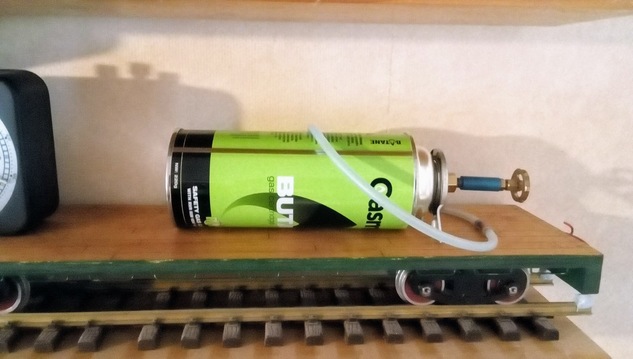

Tired with carting around my gas cylinder on the flatbed truck (it fell off the other day in a small derailment :oops: ) I found that a 220g gas cylinder fits inside our standard 80mm rainwater downpipe. So today I rushed out and bought some end caps to start the project

Post by dewintondave » Mon Feb 17, 2020 10:28 pm
Butane is my new "universal fuel", I've got 2 gas-fired locos now
During loco testing in the spring, I found low gas pressure a problem so placed the canister in a warm water bath, the cylinder has a 40 dg C max pressure, although it is designed to be used inside a single-burner stove :D
220g gas canisters are approx max 69mm diameter. The downpipe is approx 76mm ID. There's enough gap for a water bath, especially with an upper and lower vertical centre projection.
There can be a drain tap for the water and another valve for gas flow
Here's the current set-up on the flatbed

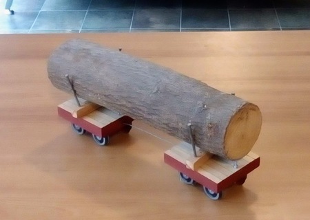

Here's the logging truck set-up that could be used for the Gas tanker
