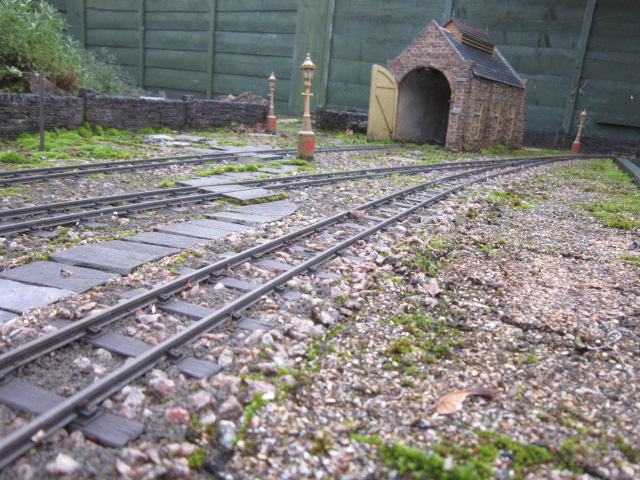

I gave notice some time ago that the BURPS would be ceasing passenger and tourist trains shortly and that time is upon us!
Today, in fine weather, the management and staff (both me) embarked on the not inconsiderable task of removing, cleaning and inspecting, and storing, all items of structures, passengers and visitors, and other infrastructure not built to withstand the winter conditions.
Our last open day of the season took place here yesterday, so I was able to tidy everything away. Pictures of the meeting will be available under 'Exhibitions and open days'
I have been very pleasantly surprised by the condition of the items which showed very little deterioration over the past two seasons and recent very wet months.
The major cause of damage is probably me! I was a little enthusiastic using a scrubbing brush to remove algae and general grot, so some items now need a little re-assembly, but nothing major.

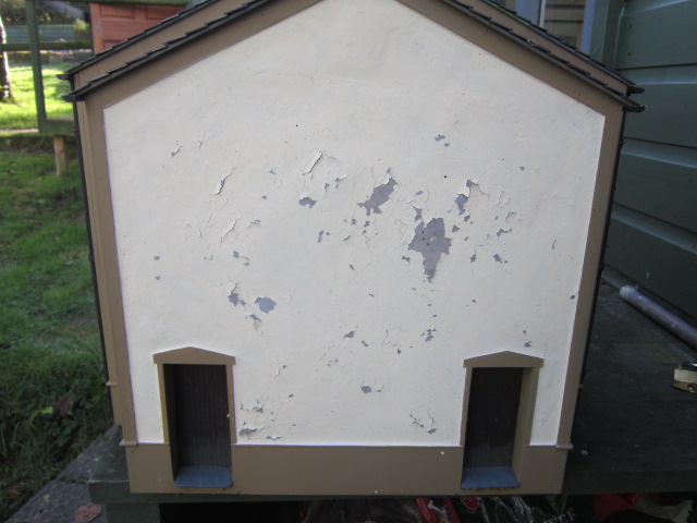

One of the structures, the Chapel, has some peeling paint on the rear wall, one which doesn't get direct sun, which I believe is due to my use of an emulsion sample paint-pot instead of my preferred acrylic paint. That proves the benefit of using quality paint.
Another structure has one small area where a crack has formed in the screed material I used to give a texture to the HIP. My fault again as I forgot to score the smooth plastic surface before applying the screed. All other areas are fine on all of the structures where the the same screed has been correctly applied.
During the build process of my structures I posted my methods for others to see. It was experimental at the time and no results were guaranteed. I think I can say with some satisfaction that they have proved themselves to be successful and I hope others feel secure in trying this for themselves.
This is what my forlorn railway looks like minus its embellishments, a sad sight indeed.....

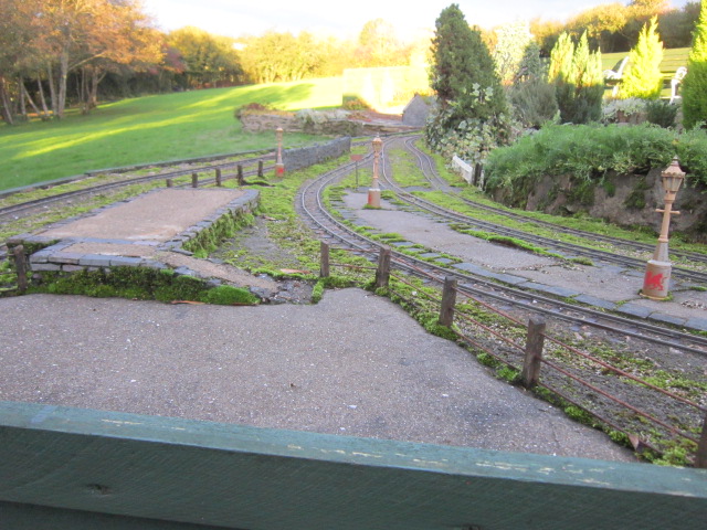

Just a little digress from you thread if it's ok Peter.
Your last photo isn't as sad has ours......
This was taken by Anne after our line was taken up. I will post the full story on my own thread when I am up to it later.....

Yes Rod, not much sign of your railway ever being there now, however, your landlord will have no reason to complain!

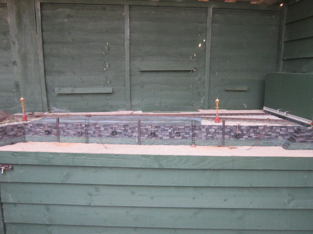

Having removed my structures only yesterday, I was horrified to see the demolition contractors have moved in so soon..... It is certainly a good job this didn't happen for my final open day, it would be difficult to make it tidy at short notice.
Other than that I have been dealing with the repairs to some of the issues mentioned previously.
This passenger was so enthralled by his visit he was stuck to his seat..... The peeling paintwork on the Chapel isn't really a major concern as it looks entirely appropriate for that type of building where cosmetic damage in an area, not prominent to viewers, wouldn't receive attention requiring financial outlay. I might just leave it alone.... The front of the building is perfectly OK.... Elsewhere, the crack which has appeared in the screed will need attention. I have inspected the structure for distortion in the HIP, and there is none! This is clearly a case of poor surface preparation (by me!) and I will need to remove the damage and start again. However, I am certain that the method is satisfactory when correctly applied....

Peter, the cracked render looks entirely realistic to my eyes, that is exactly the way 'real' render cracks.
Of course it will tend to get worse if left alone, but I wonder if carefully dribbling SBR into the crack ( via a small needle and syringe ) might stabilise it enough to avoid wholesale replastering?

I agree with Phillip on the screed Peter. It does look realistic. Try what he has said, it may work.
The Chapel also looks good like it is.

Honestly, Peter, when I was looking at the chapel on Saturday, I noticed the peeling paint and thought it was something you'd done deliberately. I was actually going to ask how you'd done it! The crack looks good too. The brilliant thing about your construction methods is that nature is now doing the modelling work for you!
Glad you got an Open Day in before taking your models in Peter. The damage doesn't look too bad, considering the amount of buildings you've made for your line? Good solid construction techniques, clearly!

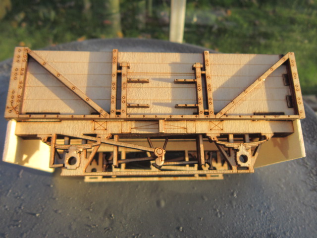

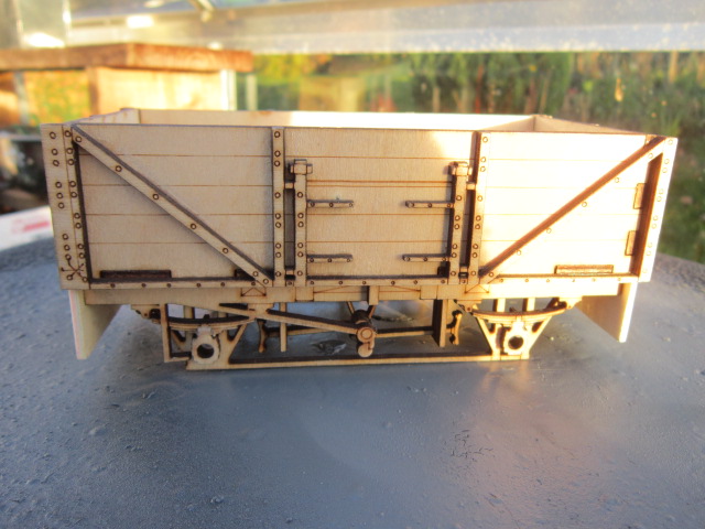

In between building up my collection of 'Rocket' locomotive models for next year's exhibition programme (see Open days and exhibitions, 'Rocket Man'), I have been working on a laser cut, plywood wagon which I bought last week from a model shop. This has been in the shop for about 3 years waiting for someone to take pity on it.... that would be me then!
I first noticed it when one of their customers bought a laser cutter and practised using it by cutting 4 wagons, which he constructed and offered to the shop for sale. It was offered as a novelty table salt and pepper holder, or similar, as the maker had no interest in railway modelling. It isn't built to a particular scale, (the wooden wheels were too wide for 32 and 45mm gauges and didn't rotate anyway!) but it looked as though it could be made into a reasonable item of stock...... Having removed the wheels and replaced them with steel rimmed ones running in bearings it is now a good runner. Binnie buffers on dropped beams have made it look OK too. It measures 11.5ft x 5ft (in 16mm scale) so fits in well with existing wagons.
A coat of paint has been applied and the strapping and hinges picked out and it is ready for lettering and weathering..... Not a bad buy for a fiver!

Good one Peter, for someone not interested in railways he certainly included a lot of detail. Your additions and a good paint job finish it off very nicely.

Grant's comments are more or lesss exactly what I was thinking, too.
That's a beautiful looking wagon Peter. It's so good it will look fantastic on my line....
Oh I forgot for a moment there, I haven't got one has yet....But soon.

Some impressive detail, particularly below the solebar. The strapping looks a bit thick but sometimes I think detailing needs to be slightly exaggerated in model form otherwise it can get lost.
As you say, a fiver is a really good price for a wagon with that amount of detail. As always, you have a knack of picking just the right colour.

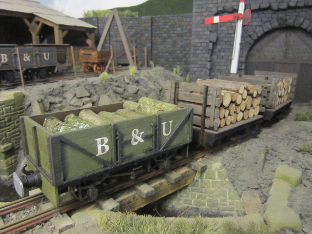

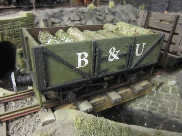

Returning to the Β£5.00 wagon, I have now finished the paint job, added some lettering and weathering and a load of logs to go with other wagons I have. For such a basic construction I am happy with the result, especially when not seen in isolation....

Another triumph Peter.
It's a lovely wagon. I like the livery too, very nice.

And the colour co-ordinated load matches the livery too!

Agreed. Actually I thought the whole thing looks as though it had been parked for a couple of years on a forgotten rusty siding in an overgrown wood
Nice job as always Peter.
