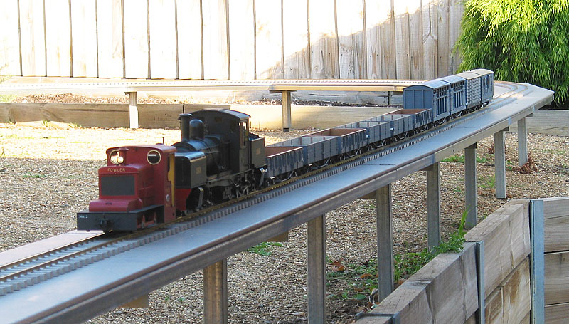

This photo shows my old Merlin Motor Mule pulling the Garratt dead, along with it's train.
The Mule weighs 1.9kg and has a 12V motor running on 8 x AA NiMH cells, with manual control. It is easily pulling 6kg of Garratt and 10kg of train on more or less flat track in the photo.
The photo isn't meant to show off, but to demonstrate that any small diesel that weighs about 2kg and has a nominal 12V drive will have no problem bringing home a small steamer and it's train, even on a track with grades.
I can't find the weight of a Baguley on the Accucraft website, but the motor fitted to them is equivalent to the motor in my Motor Mule, so a Baguley with a metal chassis could be ballasted as necessary, as long as it can still slip the wheels at maximum load.
If the budget is tight, an Essell chassis with a scratchbuilt body and suitably ballasted would make a good basis for a rescue loco. The current Essell chassis design is an updated version of the one used in the Motor Mule.
