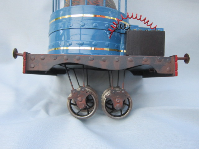

It's hard to stress the importance of a perfectly built chassis to ensure good running. I spend absolutely minutes on building perfect chassis.....
OK, so the chassis isn't the sort of thing you need, but you will notice the use of metal wheels and plenty of low-down weight, which should all add up to better running.
