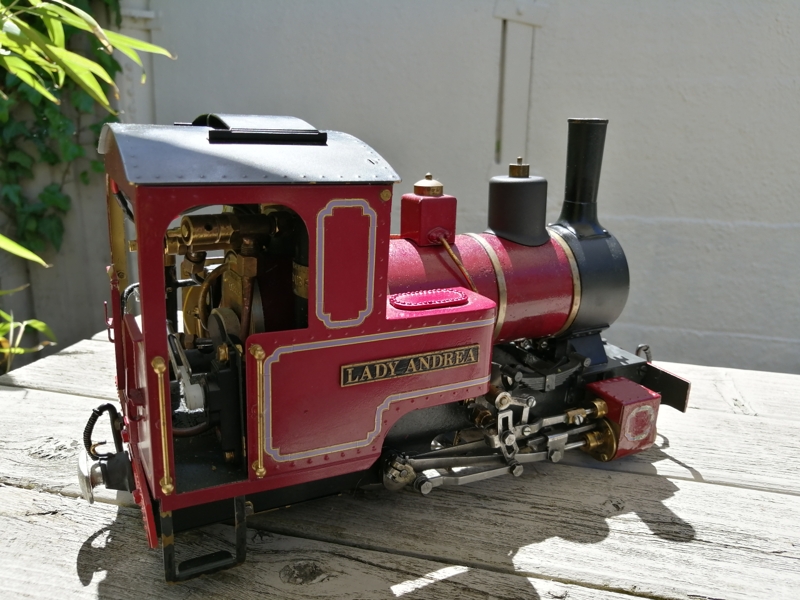

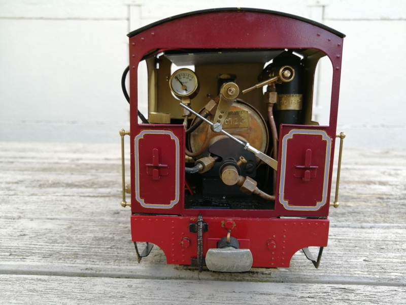

Rod (FWLR) sent me his Billy recently as he was not happy with how it performed and had concerns that the Summerlands chuffer was not fitted correctly (and you will see he was right to suspect this).
This is how she arrived:
Unfortunately, the loco has had a little accident in Rod's ownership and when steamed it was evident either the timing or return cranks were at fault.

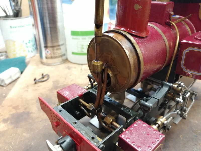

But before looking into the poor running I wanted to see why the chuffer was wobbling about in the smokebox and was not making much of a chuff noise.
Smokebox removed, mystery solved:
I have come across some botched chuffer installs since tinkering with locos but this one beats them all.
Once both exhaust pipes were connected to the chuffer it was on to fixing the running issues.

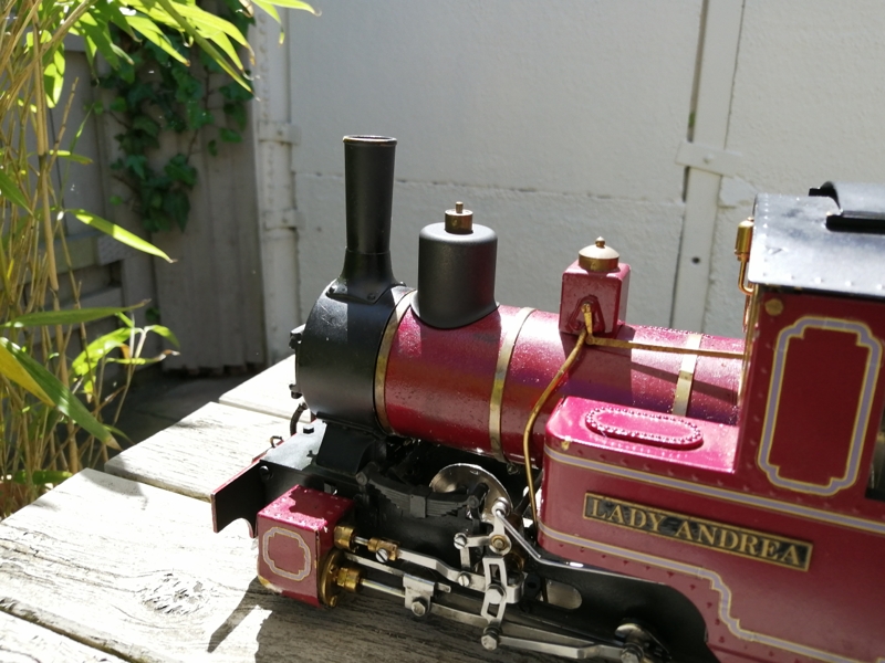

I played about with the timing but got this far before I suspected something else was wrong as I was not happy with her performance:
Inspection of the return cranks found the culprit, one was not set correctly (possibly from her little trip off the line as the cranks had not been pinned).

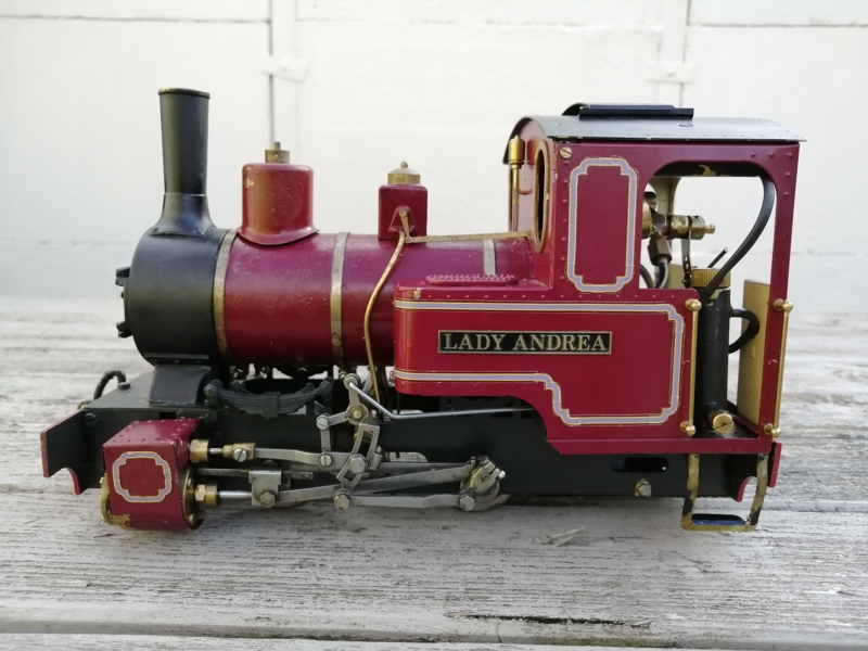

Second attempt and much happier with her:

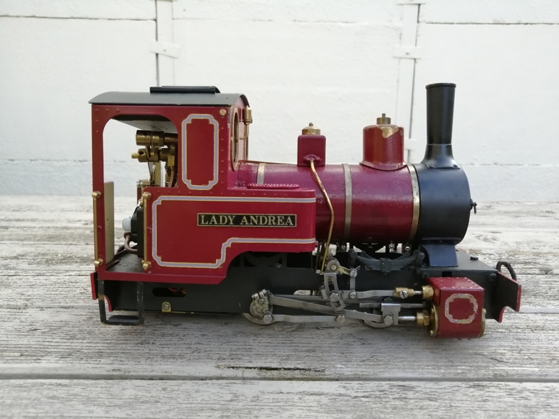

The safety valve bonnet was badly chipped so this got stripped back to brass and then chemically blackened with highlights of high temperature paint. I like the fact I have retained a metallic shine which even the most dirtiest of locos retain:

It is good to see her in safe hands after Rod has already had poor service elsewhere. She still looks a fine locomotive and I spent some time stripping, painting and re-building her very carefully. I am surprised to see the Chuff-pipe detached in this way and can only suggest that at least two journeys in the post, plus the off-the-rails incident wouldn't help. It certainly made the right noises on my line.
As I have said from the beginning, I did not do the initial build and, having no knowledge of such, had to presume all was well. I'm sure she will now give years of reliable and enjoyable service. Thank you Tom.

She sure does run better Tom. Has for the little accident, that was caused by the eldest grandson, who was extremely upset about causing it to come off the track, but in his defence it was after I had her serviced before and I think I said on my thread about her that I wasn't happy, only reason I went to him was because he was only 1/2 an hour away. You live and learn.
When I got her off Peter, she was in excellent condition and she ran really well, but then I took her to a steam up and she wouldn't light up at all, so a replacement gas jet was installed. But for some reason she didn't run well, although she did pull a long rake of coaches ok, on her own she performed somewhat like Tom got her, but not has bad. so off I went to hat guy...
