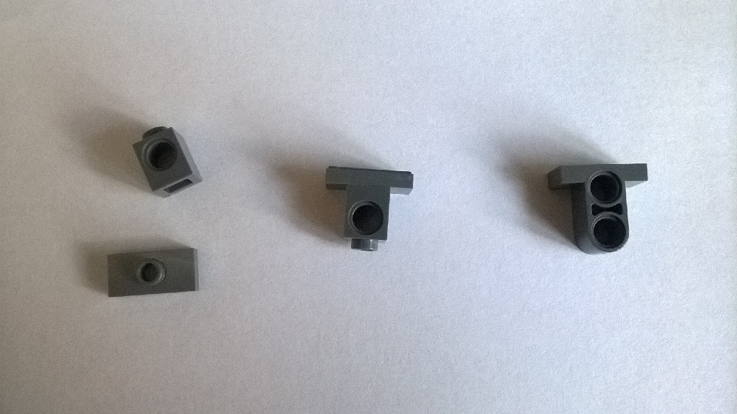

If it helps, the bricks on the left are the ones I used, stuck together as demonstrated in the middle:
I knew what I wanted, from looking at my son's collection, but even so they took a bit of finding, and I had expert assistance! To use the proper Lego terminology, the bricks I used are a "LEGO Dark Stone Gray Plate 1 x 2 with 1 Stud (with Groove and Bottom Stud Holder) (15573)" and a "LEGO Dark Stone Gray Technic Brick 1 x 1 with Hole (6541)".
There's a 2 x 1 version of the brick with the hole too, which could be handy for freelance axleboxes. Or bogies?? If it were hidden away you could possibly make a whole Lego sub-frame, which would certainly make it easy to get things nice and square, never normally a forte of mine!
The piece on the right is a "LEGO TECHNIC Pin Connector Plate 1x2x1.67 Grey (32530)" - I bought 20 but didn't use them in the end. I still think they could be useful sometime - inside bearing mine tubs maybe??

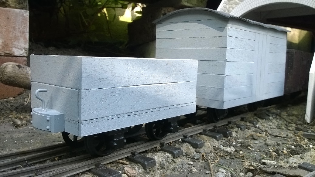

Yep, glue and paint have both worked fine - I used Revell "Contacta Liquid" and Poundland primer and paint...
Both wagons now have running and coupling gear attached, so I took them into the garden for a quick picture but was joined by this very friendly photo-bomber:
Believe it or not, Hendricks (from up the road...) is only the second most stupid cat on our street...
Having shooed the cat out of the way, I managed a more sensible picture - although sorry, the Lego axleboxes don't show up very well!
Painting next...

Re: (WH)WHR Rolling Stock
I think those photos demonstrate that you can't tell the axle boxes are made of Lego

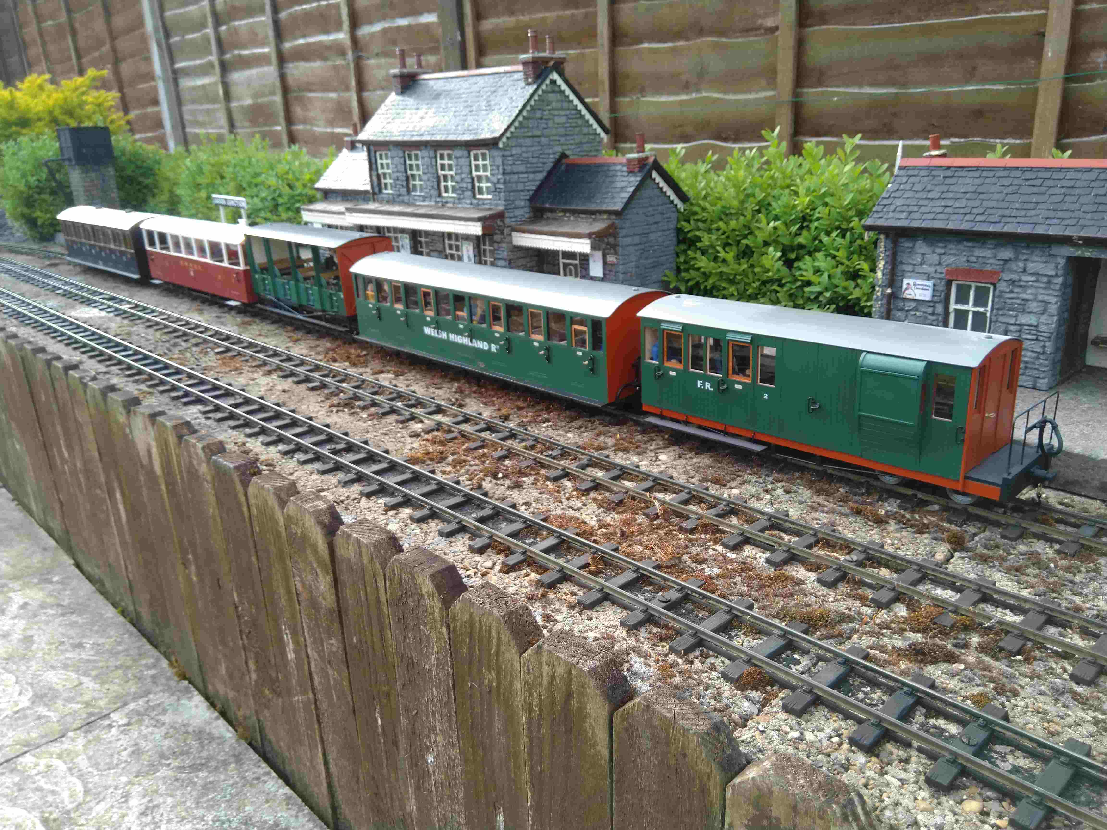

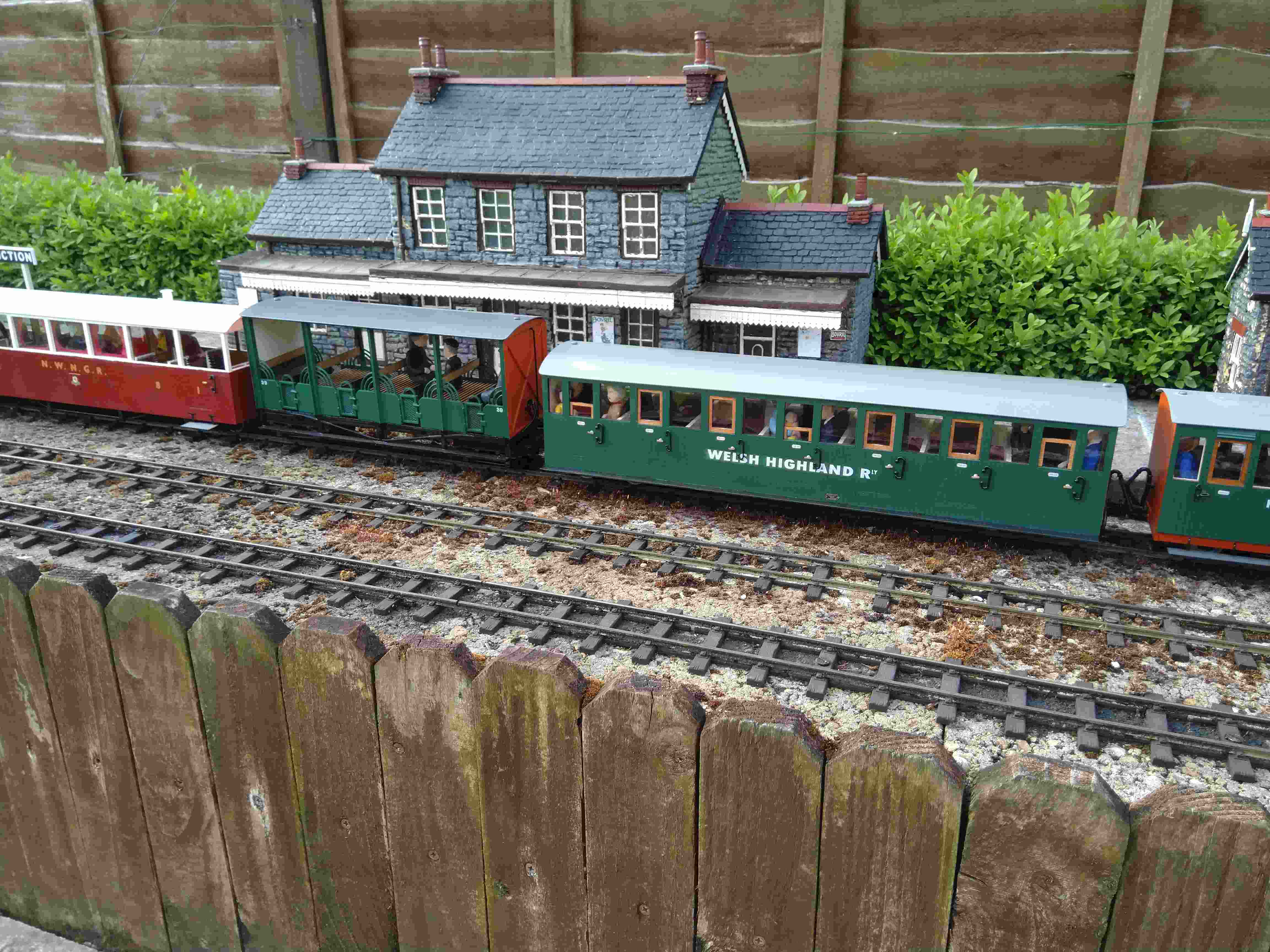

Andrew (and anyone else)
Two new additions to the WHR carriage fleet on the LVLR have been finished. Carriages 23 (summer carriage) and 39 (toast rack) are modelled after their current appearances. 39 is currently awaiting couplings.
These two carriages can also be used with some of our other F&WHR locomotives without looking odd, primarily the NGG16 (23) and the Angus Double Fairlie (39).
Currently also finishing the NWNGR brake van to go with the wagons and the two NWNGR carriages.

- Posts: 5969
The quality of the stock speaks for itself, but I love that middle picture, the oblique shot looking along the line into the distance. Beautiful!
