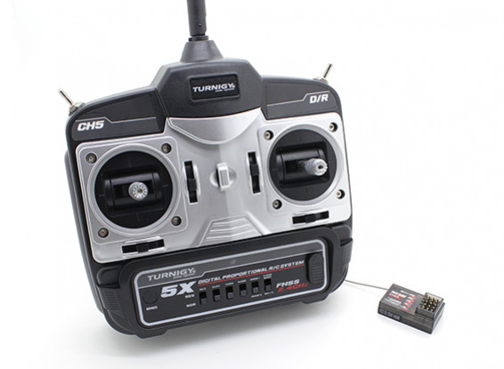

Ok - this is a pic of a similar transmitter to what I have -- I think I use the LH stick for the regulator - so if I want to extend the travel of the servo, which bit do I fiddle with?
- Busted Bricks
- Posts: 750
- Joined: Sat Jan 22, 2011 9:16 pm
- Location: Denmark
Re: Trims on Radio Control
You have the dual rate switches on the top/sides of the TX. The reduce/increase travel. The trims are next to the joysticks. All they do is adjust the center position of the servo. If you want to extend travel you need to move the pushrod out one hole in the servo arm (or fit a longer arm).
