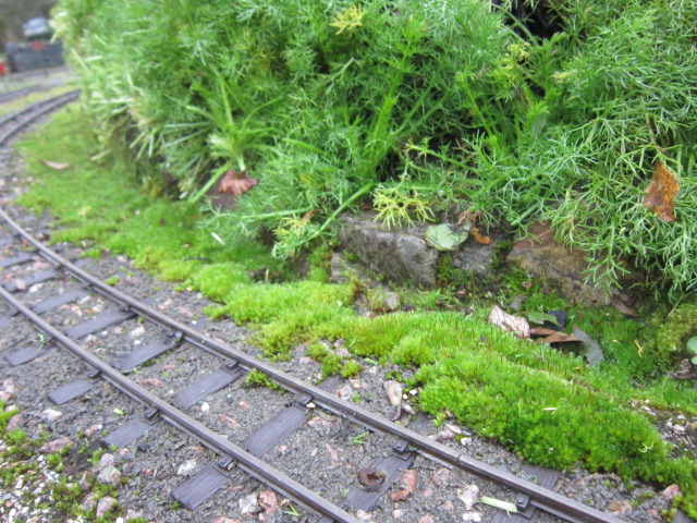

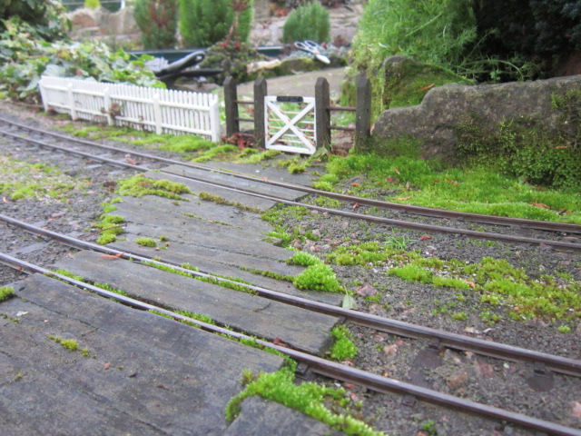

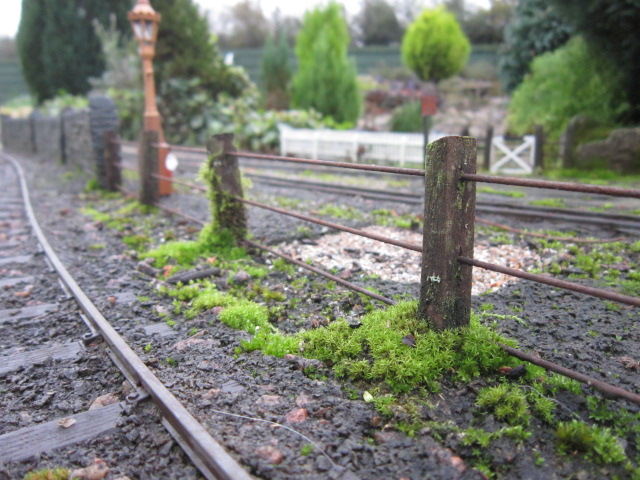

I am hoping to get a nice neglected look on the track with moss growing between the rails. I remember mention of using yoghurt to encourage moss growth, but I'm wondering if SBR would act as an inhibitor for natural growth.
Any thoughts on the subject folks?
- Posts: 6075
Re: Ballasting track
I have natural moss growth all over our garden to the point of it being a nuisance. However I do use yoghurt on newly ballasted and SBR'd track, I do sometimes sprinkle a bit of soil/compost on as well, just to get it started.
I can't say that I've noticed SBR inhibits growth, I think its just the time taken for soil and moss spores to collect in the crevices in the ballast.
- Posts: 5730
My track is laid on a treated timber base with roofing felt covering, so no contact with the ground or any soil. I have soaked all of my ballast and other ground cover with SBR but never used yoghurt, this is the result.....
Remember this is West Wales so gets plenty of rain, it is also exposed to direct sunlight though but still flourishes.
