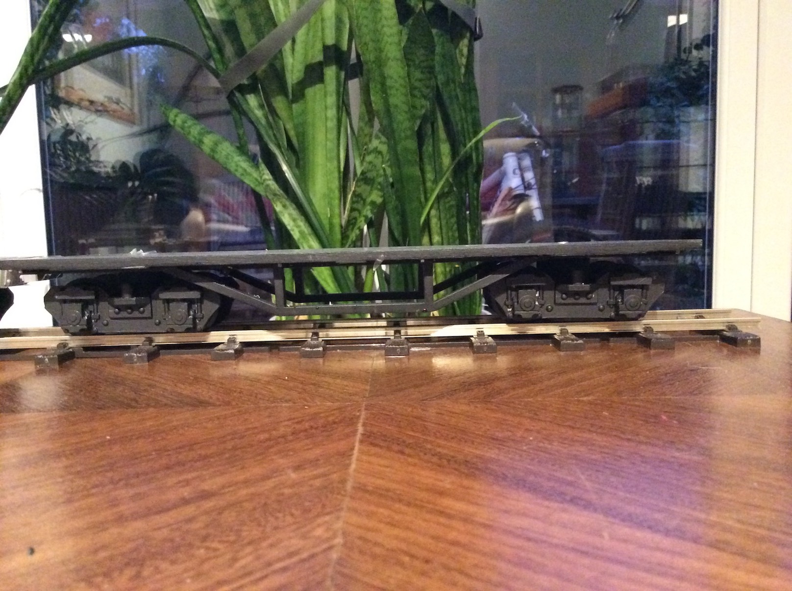

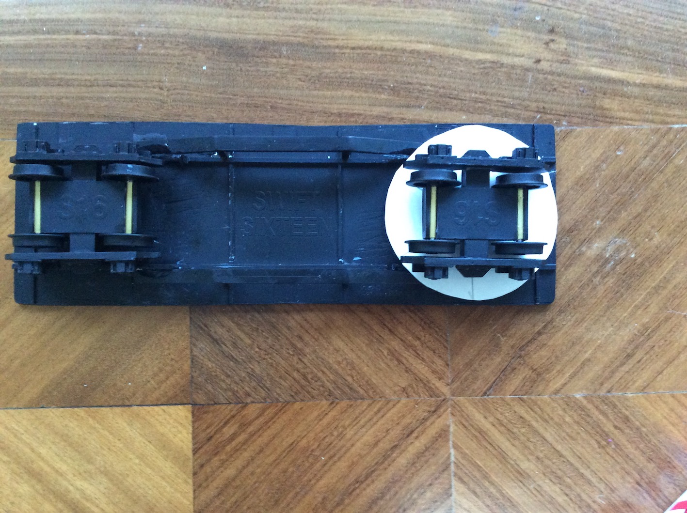

My bogies arrive last week and I've built them up today. Locating them on the standard 4 wheel chassis in the same place as is marked for the original wheel carrier will work well. I've only offered it up to check and it will be a while before I complete the job as I still need to paint the coach sides before fixing the floor/chassis in place. It is worth noting that the standard axle block and wheel set give a ride height approximately 2mm higher than the ride height sits with bogies. The floor level is determined by the lugs on the steps and so is in effect fixed. I shall probably build up the underside of the chassis/floor with a 2mm plasticard spacer before drilling and locating the bogie.

I've done a little more work on the bogies today. The difference in ride height is actually 1.7mm and so I've cut 1.5mm plasticard spacers - 26mm x 30mm and these sit in the space between the moulded guide lines (the ones meant for the SS16 axle blocks) very nicely. A couple of things that I have had to think about that are worth noting. If the intention is to drop the chassis floor into the coach as per the original design then you have to watch the overlap of the bogie as if placed too far forwards the bogie will likely foul the end panel when in a curve . (the coach end panel carries the buffer and therefore extends down past the coach sides and is therefore deeper with respect to the floor/chassis). Using the WW1 type of bogie will avoid this problem but brings its own with it - namely a likely need to chop off the bottom of the coach ends (and probably the sides too)! At the moment I'm looking at the bogie pivot point being 46mm inboard of the end of the floor/chassis.
Coming inboard so as not to foul the coach end panel brings a new problem - the bogies will now foul the chassis stiffening bars. As these are up inside the coach I've got around this by carving away the inside edge of the stiffening bar. It will not be visible once on the track.
I can see how fitting the WW1 bogies would be, as Rob says, a challenge. It would probably be easier to work on the chassis than the coach sides and ends. You'd probably need to build some boxes to then mate the bogies to. I don't have a WW1 bogie and so can't comment further on how easy this would be.

I have positioned and mounted S16 Standard Bogies onto an S16 Standard Four Wheel Chassis. I've temporarily taped on a couple of S16 Mk2 buffers and pushed it around the track using a GRS Diesel. It wasn't coupled. I can confirm that it will run around both 2'6 and 38" Peco radii (at least 180 degrees of curve). The buffers maintain front face contact with each other throughout the curve and the chassis themselves do not come into contact with each other at any point. The bogies are mounted on the chassis longitudinal centre line and are 47mm from the chassis end.
It will be a while before they see a body as I need warmer weather in order to paint them!

47mm in from chassis end. Handy to know. I'm planning the same thing.

invicta280 wrote: Sat Feb 02, 2019 7:29 pm 47mm in from chassis end. Handy to know. I'm planning the same thing.
You will need to shave the insides of the strengtheners to run 47mm back as it just fails to clear. It is only a shave of the inner surfaces though - you can't see it from the normal viewing point. Making a card template helps. The image was taken before I cut the spaces for the chassis strengtheners - once this is done the template sits flat (tish). I think that the pivot screw will need a touch of superglue to hold it fast in the bogie. The bogie tension needs to be just right and just after one circuit all mine had moved.
It's pretty easy to do - and nice to know that it works as it was very touch and go. Any further back than 47mm and the strengtheners really get in the way, and also the body of the first coach will touch the following one on overhang. 0.5mm forwards and the coach end gets in the way - so 47mm is critical.
If you are making up more than a pair of bogies then build a jig for attaching the sides. Getting them to sit square is a test of patience. I'm going to pin the next two sets that I still have to build.
