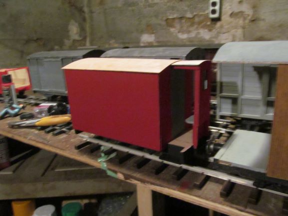

The sentry box van has now been clobbered a couple more times with the paint brush. I tend to like red ends on goods brake vans, and this one is no exception...
And just to prove I did both ends...

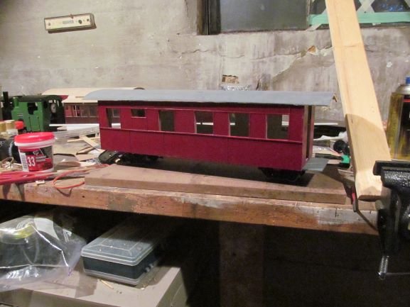

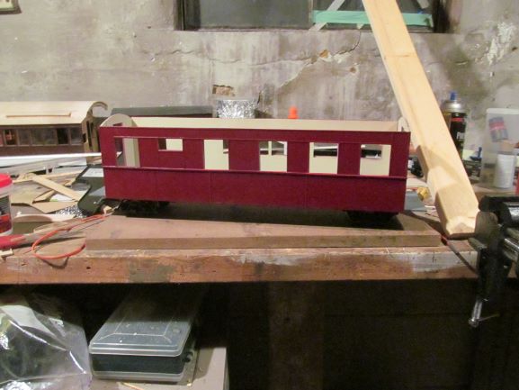

Meanwhile the South African coach is coming on. Here is the six window side with its beading, and first coach of paint. Unfortunately, the paint had been left too long. Might be a do-over in the works there. Nah - it was just undercoat anyway. I am still trying to decide between dark brown, and deep crimson lake (NER, not Midland) as the passenger livery for the CLR/NET.

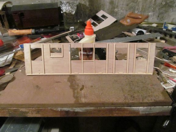

Here is the other side, showing the framing for the drop lights, which in this case includes stops as the pocket for the drop lights was a bit on the deep side. Sometimes I just make the bottom bar a bit deeper, other times I use stops. Just depends on how I am feeling. Sometimes I even save my sanity and just fake it with the droplights!

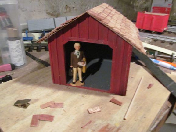

And your bonus for tonight, a little shelter that has been a little pick it up and put it down project for about three years. I am finally bored enough to finish shingling the roof!
The prototype is Norwegian - probably one of the minor halts on the Setesdalsbanen, or possibly one of the minor standard gauge branches. It is "half inch" rather than 5/8th scale, so it will end up as a bus shelter in the background, but I could also knock the bottom out and put it on some sort of masonry base to make it fit. It was built as a sort of dry run for constructing all those funny little huts that light railways seem to use.

The roof on the hut is several hundred little wooden shingles. The Missus found a bag of doll's house shingles in a charity shop and hauled them home. The only catch is they were 1/12th scale, so every one gets cut into four - often very approximately - for use on the railway. It was a slightly tedious job, but not so bad when one is not on a schedule. I would have hated to spend a couple of solid hours on it.

The last little bit of shingling on the waiting shelter was done yesterday. It needs ridge cap, barge boards, and possibly a noticeboard and a bench to complete.

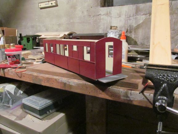

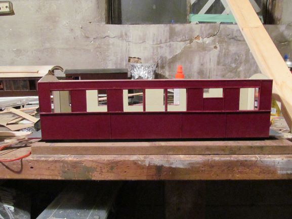

The outside sides of the Saxon carriage were painted dark crimson lake this morning. I initially tried dark brown, but I found that a bit too sombre. I will have to see it in natural light before I decide if it needs toning down a bit, it looks quite bright in the basement - almost the Midland <spit> shade. However, if it is closer to the Midland colour that might not be a bad thing as that is roughly the colour of BR non-corridor stock, which would make the CLR's time period the 50s/early preservation.
The inside sides were cut yesterday and today and glued to the framework and outside side assembly this evening. Now we leave everything to dry for twelve hours; have a look at the wood pile; and then decide what to do next. Ideally it would be the underframe, but I still have not had the chance to get some 3/8th by 3/16th, so it is debateable whether I have sufficient timber for the underframe. If I have to postpone the underframe pending a visit to Harrisonburg, then I can get on with the body.

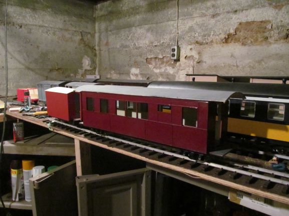

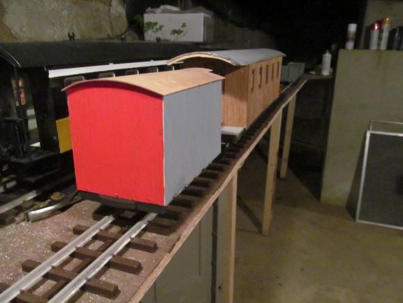

Further progress with the current projects.
I decided that the brake van ought to be even more distinctive, so it ended up barn red with vermillion ends. Sorry it is a bit blurred. The sides, ends, and floor of the Saxon coach have been assembled and painted a deep maroon, which is somewhere between BR non-corridor stock maroon and the NER colour. Close enough! I then decided to pop it up on a spare set of logging bogies... and then borrow the roof off a similarly sized vehicle to get something closer to the full effect. Then I thought to myself that it would look better on some track. And lastly, lined up with the road van. It still needs its sole bars and permanent bogies; drop lights, interior, and roof; then lastly hand rails. Like all good colonial railways I will probably be ordering from Blighty whatever I cannot scrounge or improvise locally. The interior will be fairly complex on this one as there is a small first class compartment; a lavatory compartment, and a third class saloon to fit out. Should keep me out of mischief for a while! I seem to have got into the habit of spend 30 to 90 minutes a day down there which is progressing things nicely.

That Saxon coach is going to look nice Peter, nice livery colour too. I relate to the thought process, try
it on some bogies, roof, track etc. Gives you an idea of where its all heading.

This particular SAR-SAS narrow gauge carriage was largely a saloon with benches lengthways, as each bay is only about 1250mm, which would cause knee interlock with face to face seating. The first class passengers got a little compartment of their own though. Some of the other Saxon-built 3rds and 3rd/1st composites, the ones with nine windows a side, look as though they had conventional seating bays arranged 2+1. I would guess the lavatory version would have held 22-26, and the rest 25-29. It is not uncommon on German built stock to have a pair of inward looking benches just inside the saloon doors, which helps squeeze in a few more seats.
I suspect, but I have not found photos to support this yet, some British built compartment stock was semi-corridor to give access to the centre lav. compartment(s). If I model any of those it will be using stout cardboard for the sides because cutting that many windows either messes up my wrist, or else takes an inordinate period of time. I have been meaning to experiment with the old cardboard on a wooden frame technique from the heyday of Gauge 1 for a while. I have used cardboard laminate stock in S scale - a IMR coach I built years ago - and know that with proper treatment card resists the damp.
