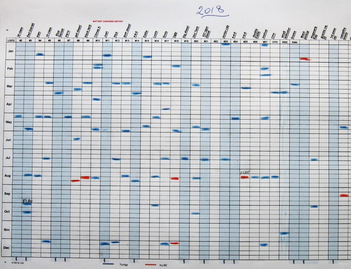

I now have about 30 locos and 6 carriages, fitted with batteries, so I thought some of you might be interested in how I keep them charged. All the batteries are charged in the vehicle and never removed.
As you can see in the pic, I made up a blank excel spreadsheet listing all my locos in the columns across the page and a simple 'calendar' down the page. The blue columns just represent LiPo batteries to remind me to use the correct charger.
I pencil in the coloured lines as I charge each battery. I use blue color when they are charged using my two, Turnigy automatic chargers, and red for my home made trickle chargers. ( I don't really know why I differentiate. )
This way I can ensure all NiMH batteries are topped up every month or so, and track if any are getting so bad that they self discharge completely in a month. And I can check how long the charge lasts on the LiPos.
Note that this method does not record how discharged the batteries were or how much a loco had run. It just shows when I decided that each one needed a recharge. (I have noted in 2 places that the battery was 'flat'.) You might notice that the in 2nd last col on the right, a passenger car lights fitted with a 2S LiPo, has not been charged this year. I just checked and it still has 80% charge. LiPos are great for shelf life where they get little use.

Useful info, Greg. My system uses a booklet with half a dozen pages for each loco in which I record not only charging but also maintenance and upgrades (eg change of batteries). Not as easy to see at a glance when locos were last charged. I now use li-ions exclusively and so find they keep their charge all year. I store fully charged locos facing out on the shelf and semi discharged locos facing in, just to keep some sort of track.

I am sure you are already aware, but just in case I shall say on here. For anyone with Li-Po's, you should never store fully charged li-po's, you should put them in store mode (about 65%) if they are being laid up for more than a few days. Failure to do so will at minimum cause your batteries to eventually puff up, at worst, well let's not go there.gregh wrote: Tue Dec 04, 2018 3:33 am
Two other things on Li-Po's:
Never charge them in your house, preferably always in a Li-Po bag and not in a loco.
Never ever charge them in the cold and then store them in the warm as the voltage increases with heat and will cause at minimum puffy batteries.
I know these things as I had a very close friend who tested Li-Po's for a living and two other good friends who one lost a shed and the other lost a garage to them. Personally, I used them for years with no ill effects, but then I guess I was lucky or they were unlucky, but either way, they have the potential to be dangerous items. I know only use Li_Io's as they are a lot more forgiving in all respects.
Just don't want anyone else having the problems my friends have had, fortunately both happened in the day time and did not affect their houses.

While the subject of LiPo charging doesn't fit with my topic heading, I feel I have to reply and offer my experiences. I see these ideas offered many times as gospel and wonder how many potential users of Li batteries are put off using them. Theory is fine, but experience counts more in my book.-steves- wrote: Tue Dec 04, 2018 8:14 pm
I know these things as I had a very close friend who tested Li-Po's for a living and two other good friends who one lost a shed and the other lost a garage to them. Personally, I used them for years with no ill effects, but then I guess I was lucky or they were unlucky, but either way, they have the potential to be dangerous items. I know only use Li_lo's as they are a lot more forgiving in all respects.
Most of these 'theoretical' statements are derived from aero modellers' usage at very high charge and currents. I just offer my comments to balance what I consider are comments largely inapplicable to our hobby.
So for my experiences...
My philosophy is "use them well below their rating and charge them well below their rating".
Fire risk.....
Like everyone, I don't take the LiPo out of my laptop when I charge it. I just make sure I use the supplied charger.
And I don't take the LiPo out of my mobile phone when I charge it either.
All my train batteries are charged in the locos, in my train room, and have been for up to 8 years. I charge both NiMH and LiPo - at 300mA which is around 1/8 of their capacity. (Most of my loco batteries are around 2200-2400 mAh.) I have never 'balanced charged' my LiPos, but have checked cell voltages very periodically and never found any unbalance.
Storage voltage...
I have been keeping records of the charging, as above, for 8 years. In that time I see I have charged LiPos 153 times - almost always to 100% charge and they mostly sit there for months. I don't know if that has reduced their life or not. Who knows what other factors are at play. But I do know I have only replaced one LiPo in that time - due to me leaving it turned on till it became fully discharged.
Similarly, my phone battery has be 'fully' charged for years. I am a very 'light' user of my phone and I doubt the battery voltage has ever fallen below the 80% level that you are 'supposed' to store at.
Everyone sets their own 'level of risk' in their life. I for one would never use a gas stove - they scare me.
But my experience with LiPo and discussions with other users convinces me I can ignore the 'experts' and use them safely in the above circumstances.

I don't have as much experience as Greg with lipos, but I have been using them for nearly 5 years. I have a couple of locos equipped with the poly bag type lipos and the rest have cylindrical li-ion cells. I have had one lipo go puffy, which I've now replaced with cylindrical li-ions and I had one of li-ion cell which went into thermal runaway when I accidentally short circuited it while soldering up a pack. The cell got very hot and vented gasses for a couple of minutes. A bit disappointing given the horror stories I'd been told.
Like Greg, I slow charge my batteries and all are protected from overcharging and discharge with protection boards and also fuses, though the latter are a last resort in case of accidental short circuit. I use a good quality intelligent charger and check cell charge levels at least once a year.
If handled with respect, I don't think lithium cell equipped locos are any more dangerous than gas filled live steam locos.

The abuse a garden railway loco puts on a LiPo battery is nothing compared to what the drone and R/C car guys do to them. I just bought a charger capable of charging on two separate channels at 15A. It's not uncommon for guys to charge 2S LiPos at up to 40A to deliberate heat the cells so as to lower their internal resistance for added oomph.
That said, I would still be mindful to store at 3.6V per cell and balance charge where possible, just to prolong the life of the battery.

I think that's the crux of the issue. The stresses the car, plane and some boat modellers put on their batteries is considerable. We railway modellers are much more considerate and gentle folk by comparison, though I've not yet reached the stage where I give my batteries names. Mind you, I have noticed some of them have distinct personalities.big-ted wrote: Tue Dec 11, 2018 5:24 pm The abuse a garden railway loco puts on a LiPo battery is nothing compared to what the drone and R/C car guys do to them. I just bought a charger capable of charging on two separate channels at 15A. It's not uncommon for guys to charge 2S LiPos at up to 40A to deliberate heat the cells so as to lower their internal resistance for added oomph.
