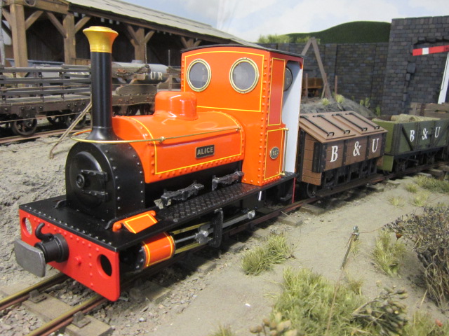

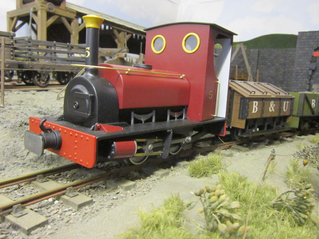

Hi Mark, good to see this thread revived, I had forgotten about it until now. As mentioned early in the thread, the PDF 'Alice Class' kit, bought by 'Just Julie', is now built and running ( I volunteered!) and I was so impressed with the kit that I bought a 'Port Class' for myself.....
In both kits a 12v motor was supplied and I have managed to fit eight 2600 mAh (AA size) batteries and Deltang receiver in the boilers of each. They run well and make a welcome addition to the loco fleet.

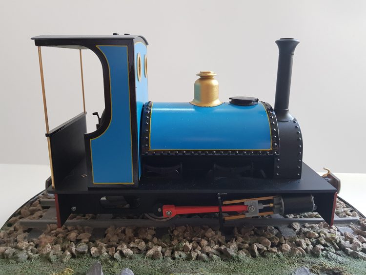

The Leanne is very nice, or in my case 'Katherine'..
Mine runs on a small Li-Po battery as they designed the back to have space underneath to hold it. Runs quite nicely but my Hunslet certainly has more power.
