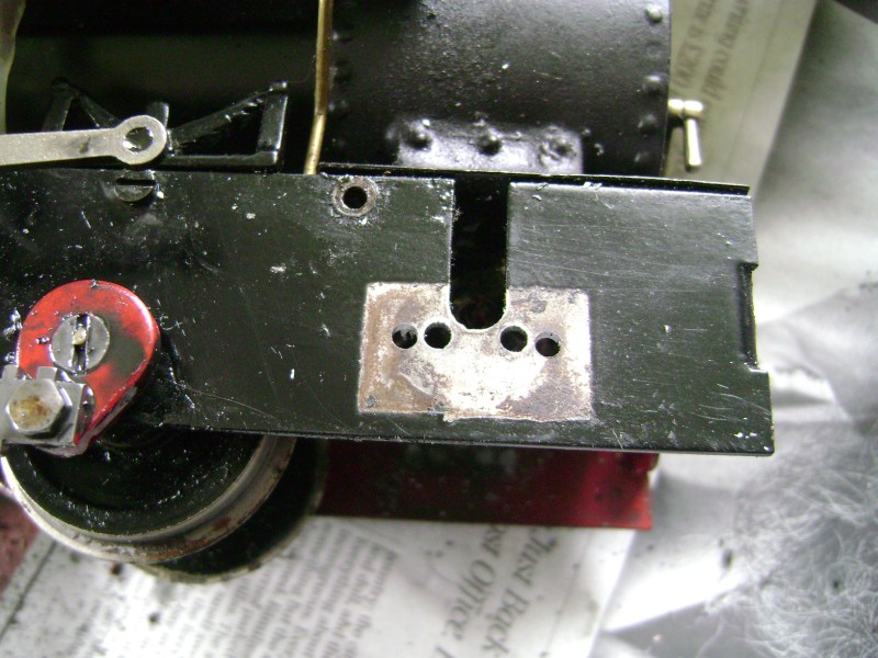

Post by TonyW » Mon Apr 16, 2018 7:23 pm
GTB wrote: Mon Apr 16, 2018 3:41 pmI take it that both types of cylinder assemblies are physically interchangeable then?
They are, but the mounting screws/holes are in different places, see picture attached.
