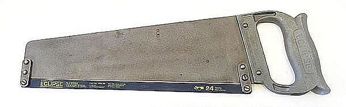

An Eclipse No. 55 sheet metal saw uses a hacksaw blade and can cut any length of straight cut, but they are now out of production and there are no chinese or indian copies. Used ones turn up on Ebay etc. from time to time.

An Eclipse No. 55 sheet metal saw in case anyone is interested.
Eclipse No. 55 Saw.jpg (28.47 KiB) Viewed 15346 times
I think you could make one fairly easily.
PS hijacked the thread, sorry.

I saw the very same image on that UK site! It took me right back to my childhood, when my mates Dad had one in his workshop.
It would only be good for cutting the exterior of the foot plate. The long faces of the internal cut-out was done with my adjustable hacksaw set over 90 deg. But before that five adjoining 3mm holes were drilled for each of the four internal cuts, and then needle-filed out enough to pass the saw blade through. A labour of love, which gives the engine inbuilt good karma ;)

Thank you Graeme, I snapped up a fine example of an Eclipse 55 locally. It fits in nicely on the workshop wall :)
