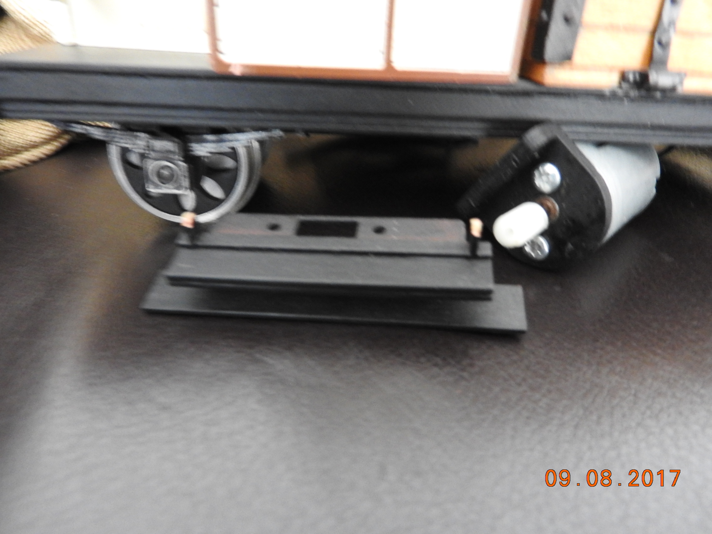

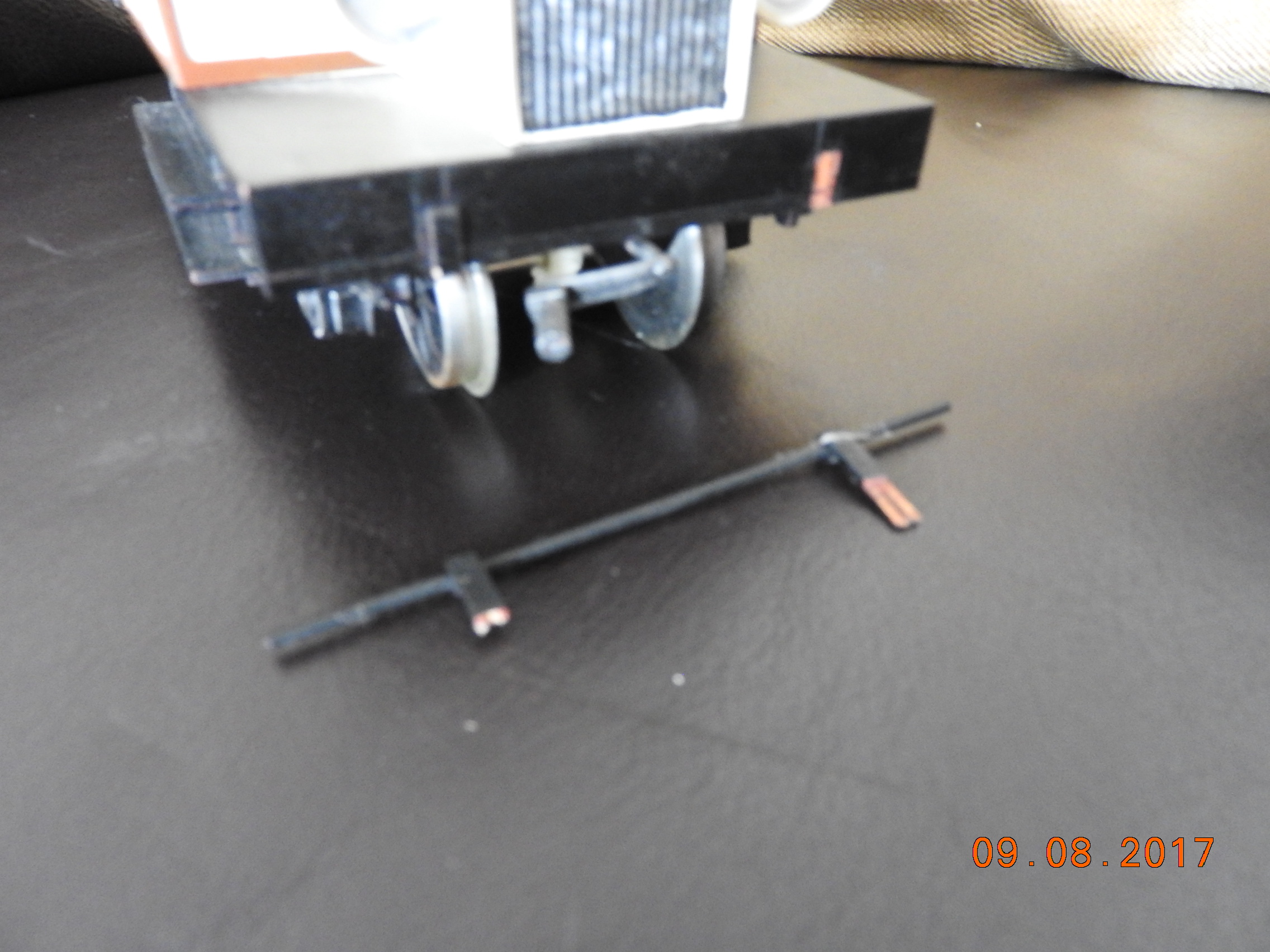

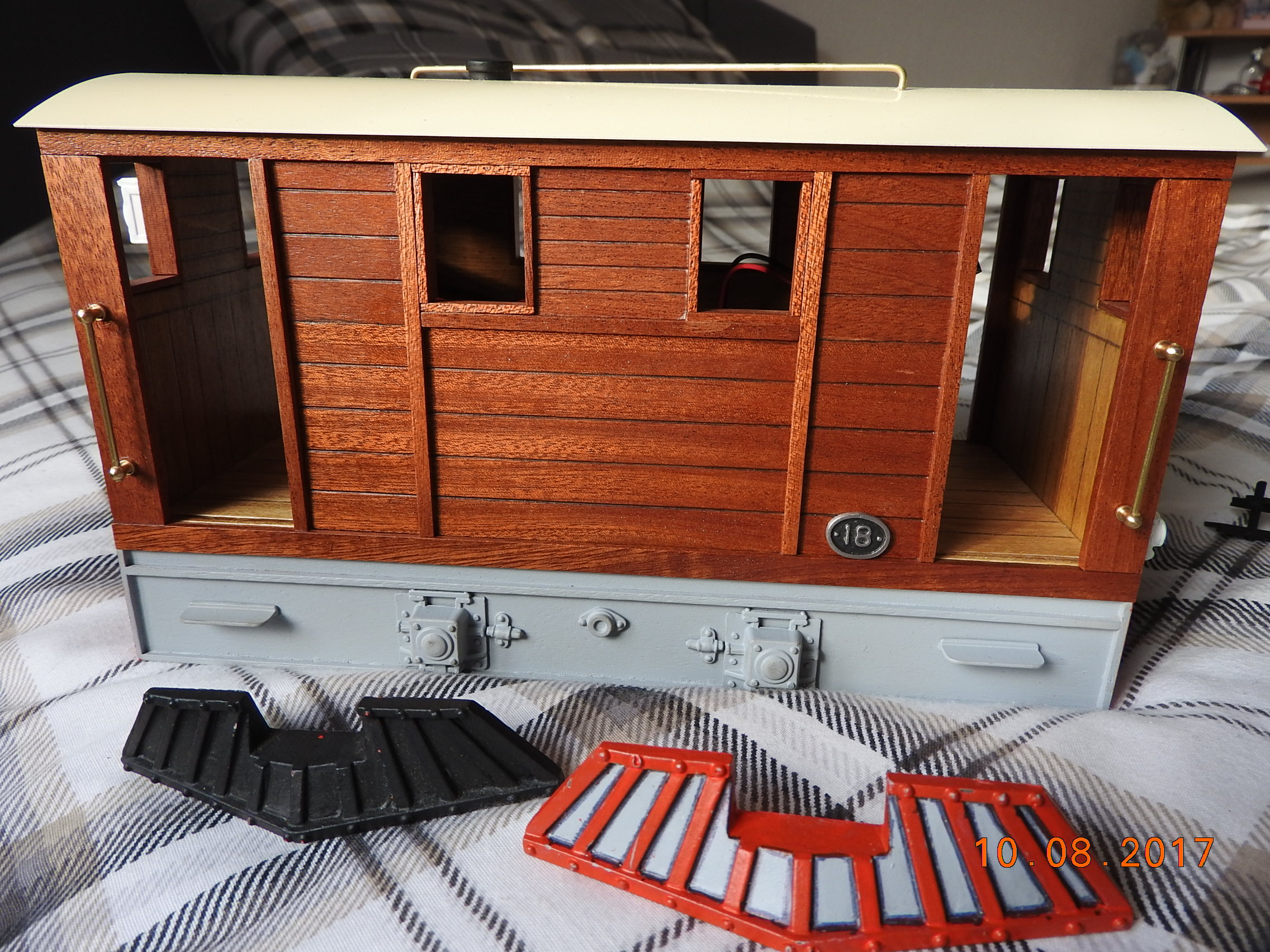

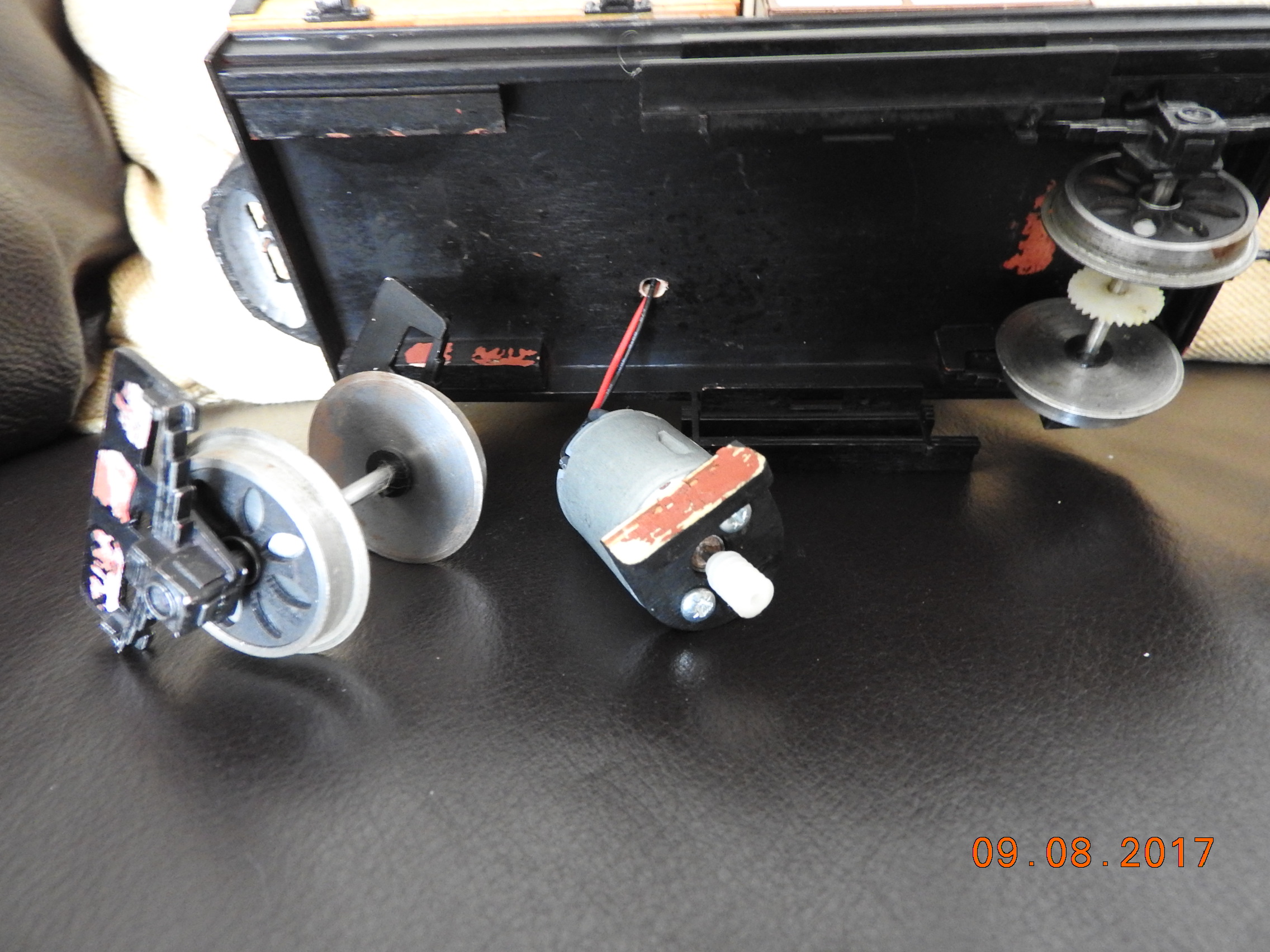

Well i have made a start with the BCATRR and i received my new purchase’s, although i am happy with both of them, i really love the Pick Up and the Tram is growing on me, disaster when i opened the box although it was well wrapped (not in original box) some of the parts have broken off, although it will be an easy fix hopefully, it will be for you more experienced members, it was really disappointing to find them broken off. I got back in touch with the person who sold them to me had was told they would send me some Fox glue, i don’t know if i have to pay for this clue, but not knowing a lot about glue’s and stuff for outdoors is this ok, i suspect it is and where would i get some from, i do have some Aliphatic Glue and some Gorilla Glue, would these be ok.
Couple of photo’s of them,
1st the Tram,
2nd the PickUp Truck
I will get better at loading and posting honest, has for the paint, what type would be used for the black or any colour that i would use for my modelling.
1st the Tram,

That tram body looks very nice, hope you got it at a good price.
The mechanism looks rather more suspect however. Personally I wouldn't be happy with a small motor mounted like that on a block of wood, for the obvious reason that the joint is quite likely to give way! I would get piece of aluminium angle and make a new motor mount, rather than trying to repair whats there with the associated problem of meshing the gears at the same time.
I've never heard of FoxGlue myself, but a quick search comes up with it apparently being a Ukrainian product and it seems to be some sort of contact adhesive.
If you really want to repair the wood-wood joints, I'd clean them back to bare wood ( both surfaces) and then use Evostick Weatherproof, or similar, PVA. At the same time glue a small reinforcing strip on the inside of the joint.
What are the axleboxes and other detached bits made of? For plastic to plastic joints, my favoured adhesive is Plasticweld, which will stick most common plastics. It will also stick plastic to wood but I wouldn't trust it for a structural joint of that type.
Hope this helps a little.

The tram looks great, is it an IP Engineering model?
Wood glue is not going to work well on the white metal parts so you want to be using an industrial super glue (do not buy standard household super glue).
Paint wise, for the touch up work you want to do on the truck use Humbrol or Revell enamel.

That tram looks a lovely job, nice build and good paintwork.

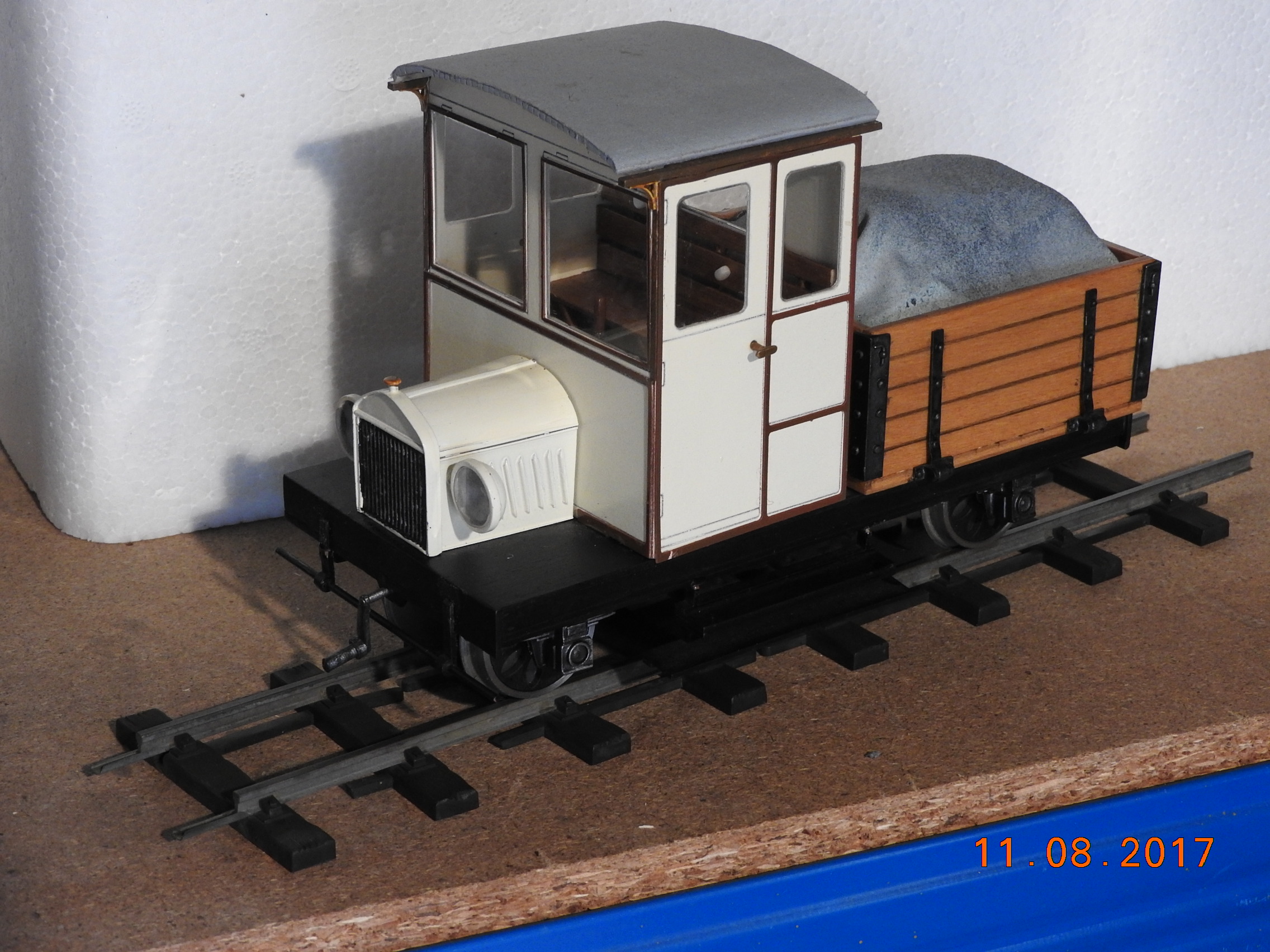

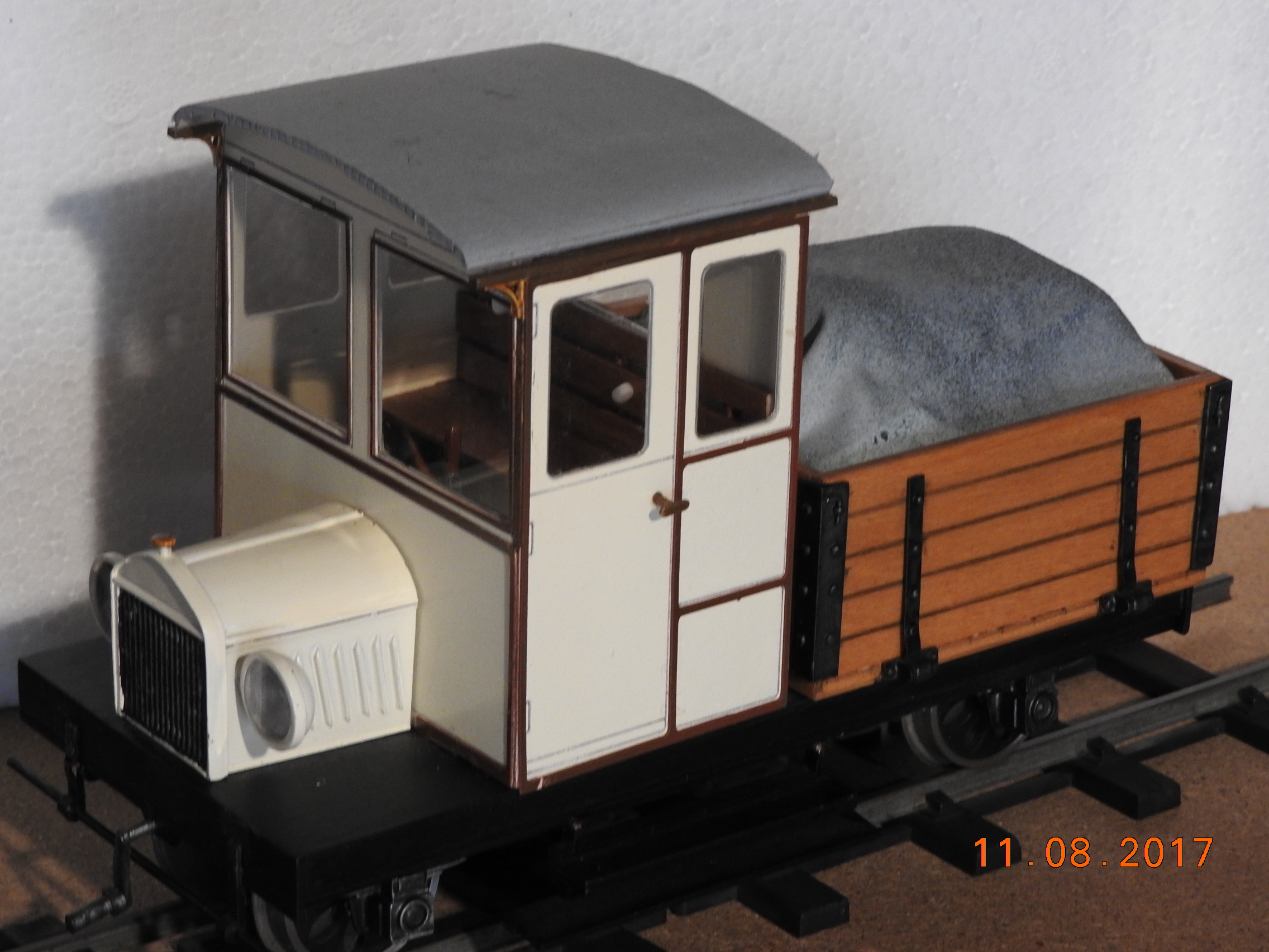

I have now repaired the Pick Up and it looks a lot better,
Would any of these be ok also has a glue for future models i may build, which hopefully i will.
http://www.cornwallmodelboats.co.uk/aca ... #aP5524806
And i will now have to start buying enamel paint now has well as my acrylic that i have for my N Gauge stuff, oh well it is getting to be a real passion for me, has is all and everything about railways, except for the more modern stuff which doesn’t seem to do anything for me.

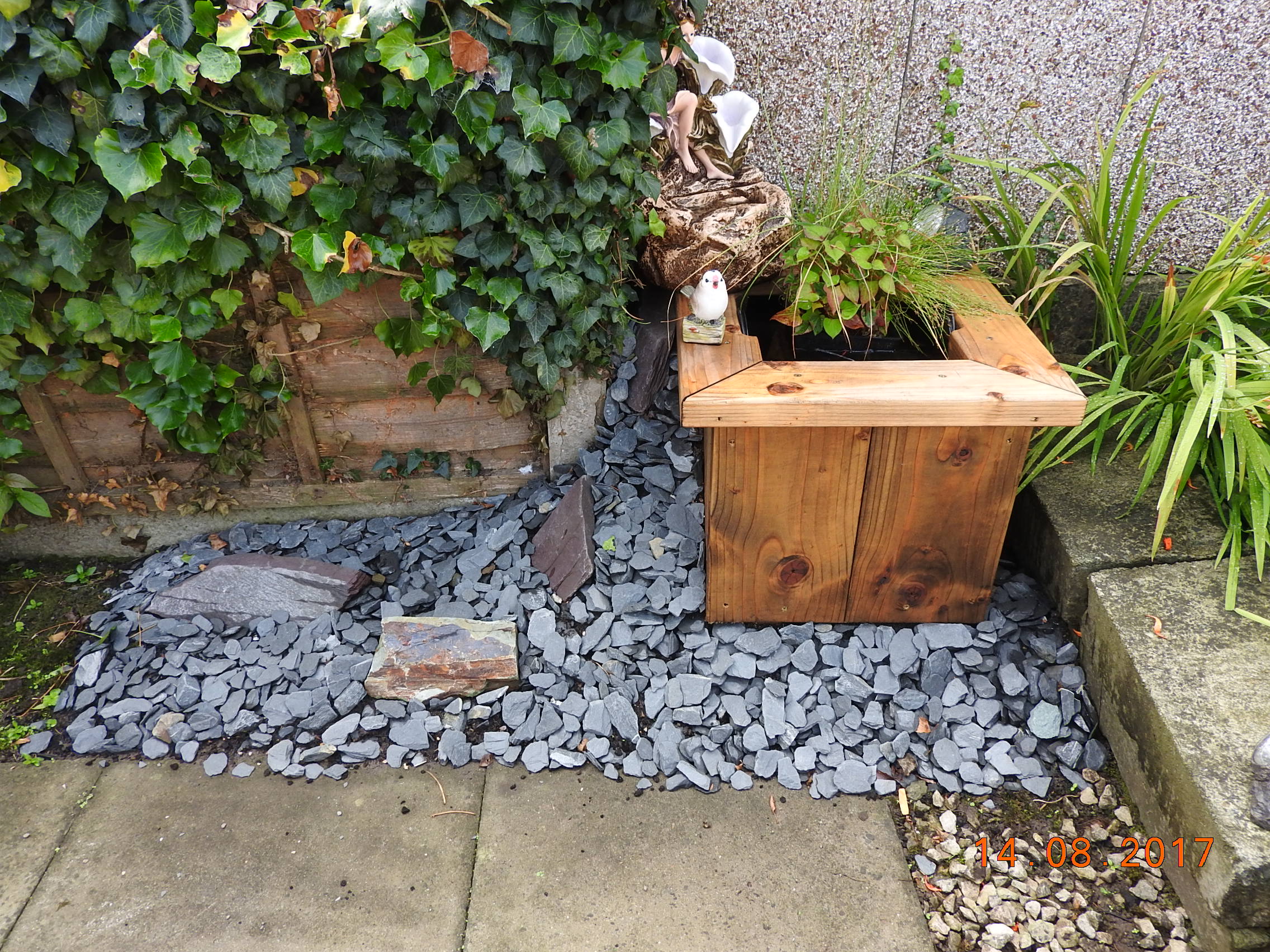

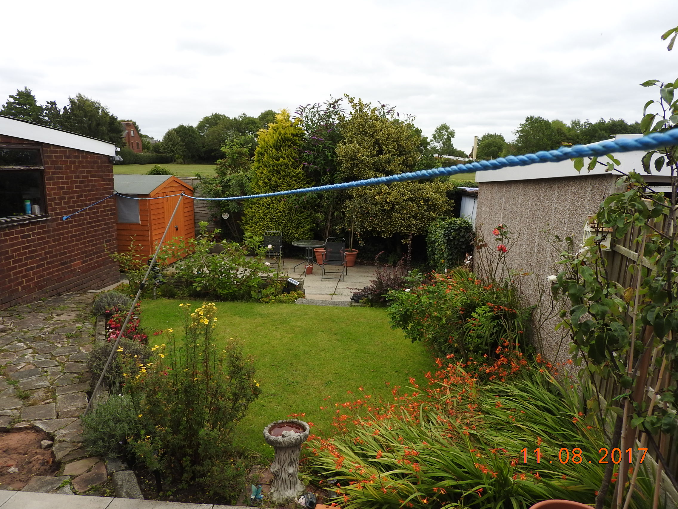

Here are a few photo’s of the garden.
I did have in mind to do an out and back with 2 loops, one by the patio by the Bungalow and the other at the bottom patio area, with either, a single or double track running down the side of next doors garage, i don’t know if that will work or just let it flow and see how it works.
Lots to think about and do,but i will keep updates coming and i hope to do a small video, but i have yet to work out how to post it.

Thanks for your advice philipy, but i have repaired it with Deluxe Materials Asphaltic glue, it seems to be ok.
Hi tom_tom_go, the Tram is a Perfect World Woodpecker Tram, the Pick Up is an IP Engineering model, they are good.tom_tom_go wrote: ↑Thu Aug 10, 2017 9:49 am The tram looks great, is it an IP Engineering model?

Congratulations on fixing the pick-up, it looks to be a very nice model. Your garden shows great potential for a railway. Your options about track height above the ground are interesting from an age and health point of view, bending becomes less appealing at our age and might restrict its use after your efforts.

Your garden has great potential. Being a slightly younger steamer even at my age I can recommend you get your track as high as possible to avoid bending down. If you must run at ground level then try to have one part of the garden that is lower than the track or dig at pit so you access locos and stock at a comfortable height.
Usual advice for track laying. Put in the largest radius you can and get the track as level as possible. You won't regret all the hard work you put in later on particularly when you run live steamers...
A decent rail bender is a must, do not try and pin flexi-track down without bending it first.

Thanks Peter, If a could use all the garden it would be fantastic, but alas i have been told by the “CEO” that all i can use is the bit along the garage next door.Peter Butler wrote: ↑Fri Aug 11, 2017 4:57 pm Congratulations on fixing the pick-up, it looks to be a very nice model. Your garden shows great potential for a railway. Your options about track height above the ground are interesting from an age and health point of view, bending becomes less appealing at our age and might restrict its use after your efforts.
Still better than nothing i suppose. We have had a fair bit if rain here over the last few days, so it has stopped me doing anything at all in the garden. i am going to visit West Lancs LightRailway on Saturday morning, depending on the weather, i think they have 32mm track, or at least a mobile layout will be attending.

I like the water feature as there something about the sight and sounds of trickling water in the garden.
Re: (MY BCATRR) Fairy Wood Light Railway (FWLR)
Thanks Tom, my partner Anne did this, that’s why my layout will now be called FWLR (Fairy Wood Light Railway), she has the CEO given permission to build the layout although in a limited area, until maybe i can apply for planning permission to extend, but hey, allowed to build in the 1st place is a start.
How did i win her over i hear to say, well i took her took an open day at a local event near us at Hesketh Bank, West Lancs Light Railway and showed her what my locos i have bought would look similar to if i could have a track in our garden, well needless to say, she was astounded at how well they looked, i think she was more impressed with the building that was on the layout, unfortunately i took photos of it and videos on my iPad and the files are to big to upload on the forum, which is a shame, because i saw a great model of a car, it was a sweet or biscuit tin that one of the members of the Southport Engineering Society had made in to a working model, it is brilliant. Well that was it what won her over i think, she knows i have ago at making things, though not always successful, lol, i do have a very vivid imagination, not always the best thing to have by the way, but since being young has a small boy i have made things that work to some degree or other.

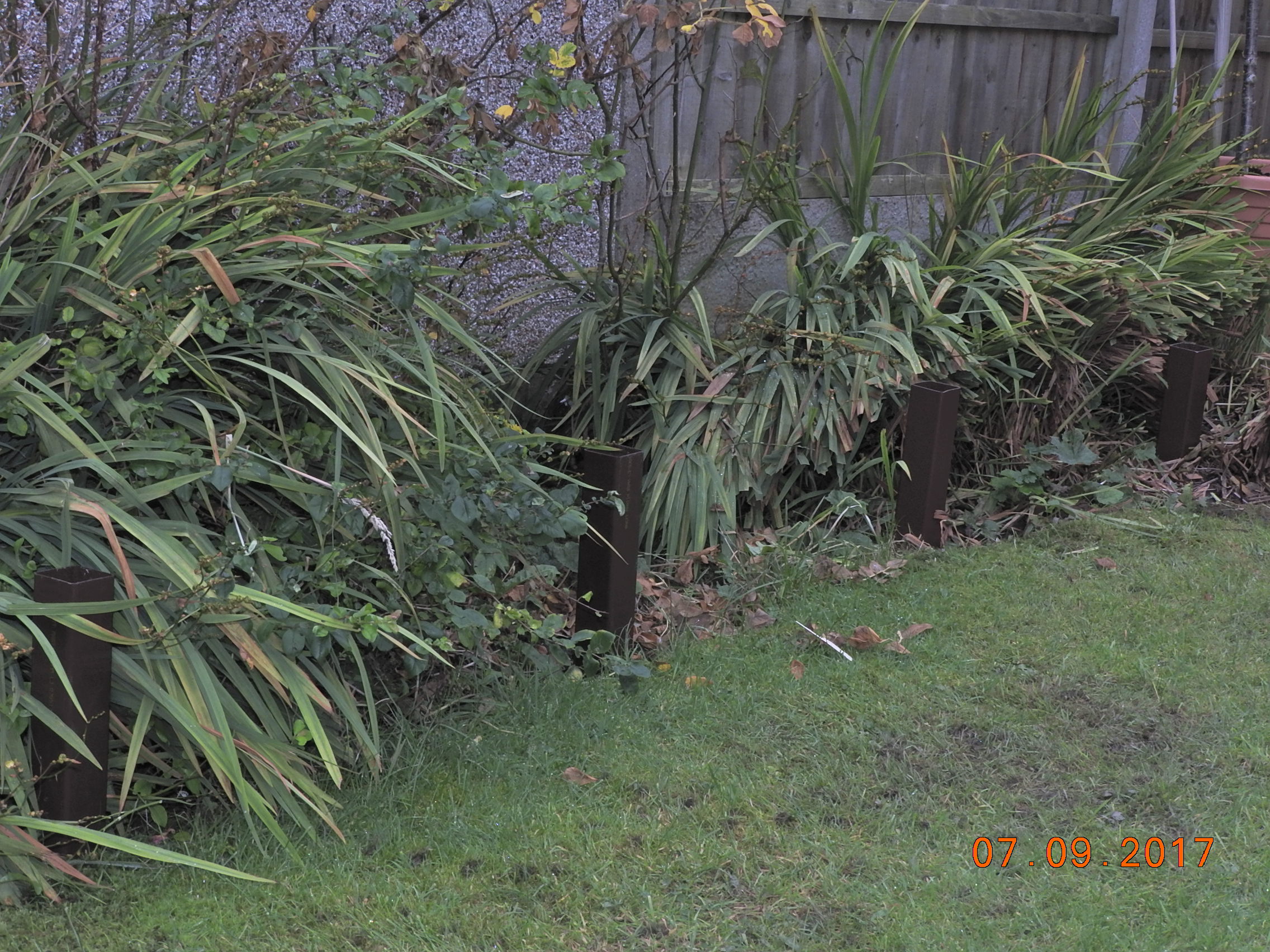

Well after some rubbish weather and me not feeling 100%, I have made a start on putting the posts in for it. I have used 65mm square guttering pipes and I have drove them into the clay soil about 18” to 2’, I can tell you that didn’t help my health one bit, but hey I am still here just..
I need to put one more in by the 1st post by the Holly Tree, i have had to lower them from the original height because Anne thought they were to high and i must say i have had to agree with her, also so i can get to put some more posts in around the rest of the borders haha. The reason being is i had put some wooden blocks inside the posts ready for the decking board i will be using, but when i was hitting the post, with a block of wood held on the top, it flipping split the pipe, words were spoken....i was too knackered to put one in yesterday after lowering them and another reason was one of the youngest Granddaughters arrived, so she took priority.
You can tell how much water has been dropped from the clouds, the lawn is not usually has bad as that, it’s not the best anyway, but round that side of the lawn it is now water logged.
Just waiting now for the boards to arrive on Monday hopefully, even though they are pressure treated i will be putting some wood preserver on them has well. Then lay some track and have a run with my battery locos, i am hopefully buying a live Roundhouse within the next week, so i will post an update then.
Happy Running.
Happy Running.

Congratulations on cutting the first sod Rod. I hope you enjoy the build once the really hard work is done. Keep us posted on progress.
