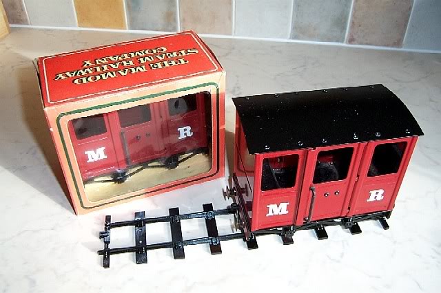

I run a 45mm gauge track as at least one of my other locos is 45mm only. So I am in the process of re-gauging the Mamod and fitting a silver soldered boiler whilst I am at it.
I acquired a tender which was obviously designed to be re-gaugeable by just unclipping two little rubber bands holding the bearings in place and changing the spacers about on the axles. The Mamod website says that the carriages can easily be re-gauged but I suspect they now have the same system as the tender.
My carriages on the other hand look as if I will have to drill lots of rivets out just to free the wheelsets and then buy or make new wheel sets. That is unless there is an easier way.

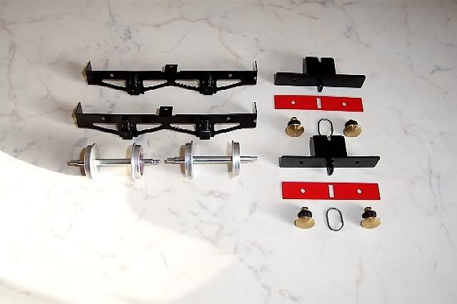

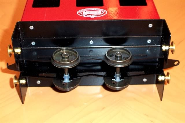

Your tender is from the 2nd Generation of the Mamod Steam Railway Company (the current Terry family run Mamod) whereas your coach sounds like it is from the 1st Generation (1980s) or an MSS built one - the RW5.
The 1st Generation rolling stock used a common chassis for all 6 wagons, and if you are careful you should not need to drill out any rivets to change the wheelsets over.
The chassis side frames on the factory built version are riveted to the floor panel in the centre, and the end plates are held into the drag beam (same as used on the rear of the SL locos) by the buffers. The drag beam is also riveted to the floor panel and this is the possible weak point as the rivet tail has little to grip on in that slot.
Remove the buffers and carefully pull out the chassis side frames to remove the wheelsets (do one axle at a time). Fit the 45mm wheelsets and replace the buffers. I find that the wheelset axle ends can be quite rough (thus jamming in the axleboxes) so run a file around them to chamfer their ends.
