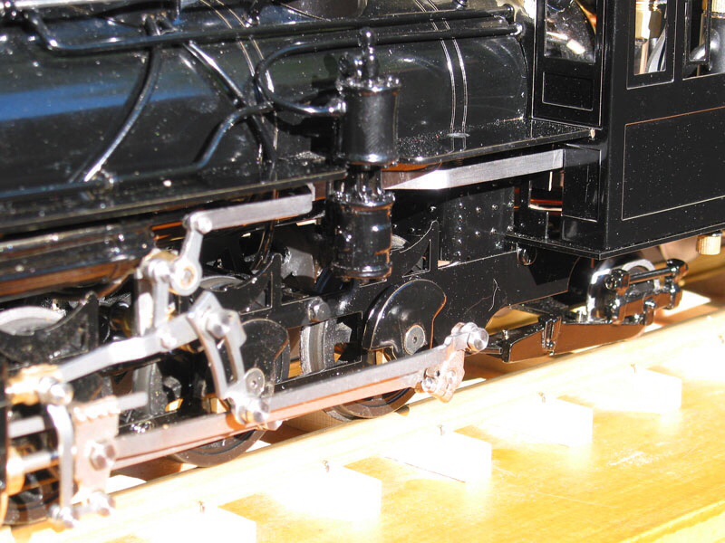

What boltd did you buy to replace the CSK screws used for the cranks? Doesn't the conrod rub against a raised hex bolt?
Posts: 1711
Re: SVLR new loco - ERYRI
Post by GTB » Sat Jun 17, 2017 10:13 am
tom_tom_go wrote: Fri Jun 16, 2017 5:24 pm What boltd did you buy to replace the CSK screws used for the cranks? Doesn't the conrod rub against a raised hex bolt?
I use 4BA countersunk socket cap screws on all my outside framed Roundhouse locos. The shortest I can get are 3/8" long, so the threaded part needs to be shortened by a couple of mm, or the screw will bottom out and leave the crank loose.
I get mine from BA-Bolts, but there will be other suppliers in the UK model engineering trade.
http://www.ba-bolts.co.uk/otherbolts.html
The hex key used for these screws is only 1/16" across flats, so the socket looks like the centre hole in a prototype axle from any distance. The attached pic shows them fitted to my RH #24.

The hex bolts look nice, the problem with them is that if you need to get them replaced, you easily slip the key in the hole, making it round. The smaller the easier this happens. At my work we often replace hex bolts and screws with torx heads, since they don't give way so easy when undoing.
You could also fill the slot in the original bolts with laquer and paint them, then it will look like a normal axle. When you need to undo the cranks, simply scrape the laquer out of the slots.
Post by tom_tom_go » Sat Jun 17, 2017 3:33 pm
Thanks Graeme for the post. Those CSK screws are something I have always wanted to change on my locos.
