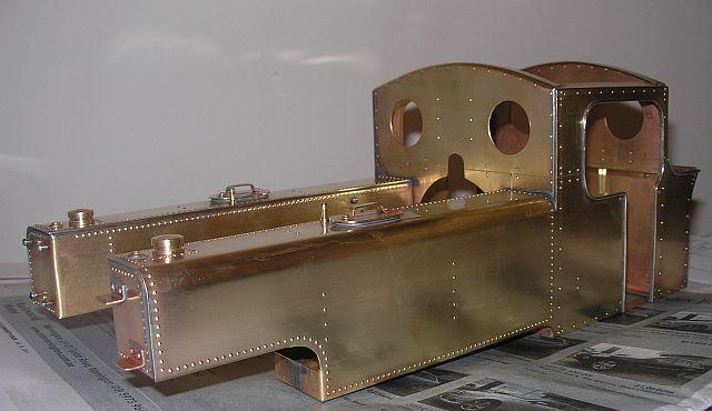

Don't know if this is the right place for this, but as Graeme mentioned riveting and the question of how to is raised many times, I thought I would explain my method. You will note the very expensive and engineering like equipment I have built!
Firstly riveting requires bringing a tool and die together in the right place and this is easily achieved in a bench drill. Mine is old and quite substantial, but I would think most should be capable of the job using brass. My set up is seen below.
The timber is bolted to the table, and a fence provides guidance. The fence can be short to get into a tight corner, or spaced some distance to put rivets in the centre of a panel.

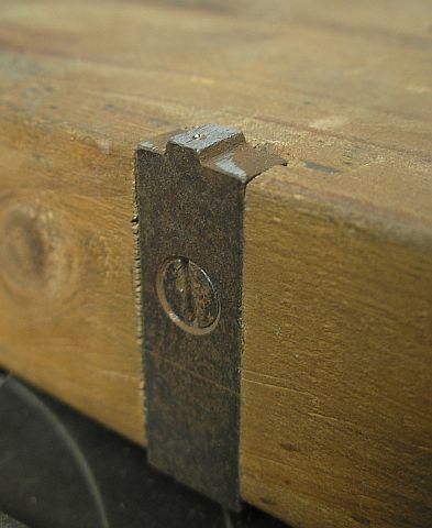

Next is some close ups of the die and how it sits in a slot cut in the timber. It is just mild steel, you could harden it but not really worth while. Easier to just make another. The working face sits about 1/16th. clear of the timber surface and the distance to the edges from the die hole determines rivet spacing.
The punch is made from the shank of a broken end mill, a drill shank would probably work although they tend to be a little softer. Ground to the shape you see and with enough relief to get up close to the fence guide when required. Varied punch and die sizes are held for different jobs.
A point here that Graeme raised, a water tank in order to be waterproof requires rivet pitch in the order of 1-1/4" to 1-1/2" depending on plate thickness. Cab and other plating generally has pitches somewhere about 4"-6" and showing this difference on a model adds that extra touch. The final product is seen below, note different spacing of tank baffles and cab rivets, compared with the main tank structure.
Some times it's a shame to paint things!

Post by pandsrowe » Sun Mar 20, 2016 10:43 am
I just love the look of all that riveting on your loco body, a real work of art.
Two questions though, what did you use to form the hollow in the female part of the die and how did you keep the spacing around the curved part of the water tanks at the bottom?
Really something for a mere mortal like me to aspire to.

Post by LNR » Sun Mar 20, 2016 11:10 am
Thank you Phil.
  The hole is simply done with the appropriate sized drill, diameter of the rivet die plus thickness of metal times two plus a smidgeon (ancient engineering term). Your really only using the top corner of the hole to restrict and form a crisp outline of the rivet head, and of course keeping the depth consistent. It actually pays to run some scrap through the die first to just polish any sharpness off the top edges of the hole. The one shown has done many rivets which is why it probably no longer looks like a drilled hole.
  Regarding the rivets at the bottom, I clamped a piece of round bar that matched the radius, to the edge of the timber and very carefully swung the entire piece using the bar as the pivot. It seems there is always a place that needs rivets but is difficult to get a fixed setup into, so it must be versatile to cope.
