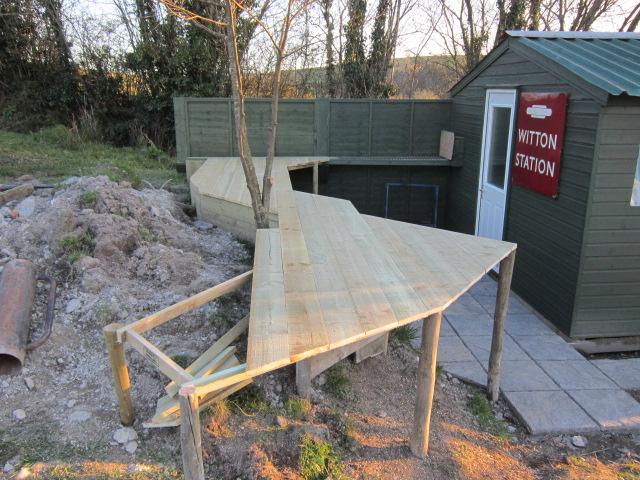

I used 1" thick pressure treated fencing boards for mine - http://riksrailway.blogspot.co.uk/2008/ ... nsion.html - I was wary of using plywood as my experiences with so-called exterior and even marine ply have not been encouraging. I have known people who have used decking planks.
- Posts: 5714

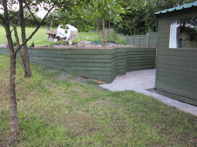

I used the same material as Rik.... 1" thick, pressure treated boards attached to round fence posts rammed into the ground. The top of my boards has been covered in felt to make sure ballast doesn't drop between them if they dry out and contract (not likely here in West Wales!) The front of my raised section has been covered with feather edge boards but the rest is landscaped into the surrounding terrain.
