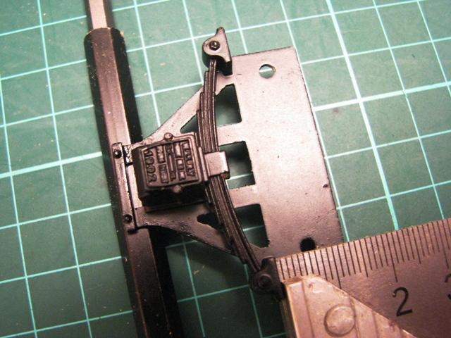

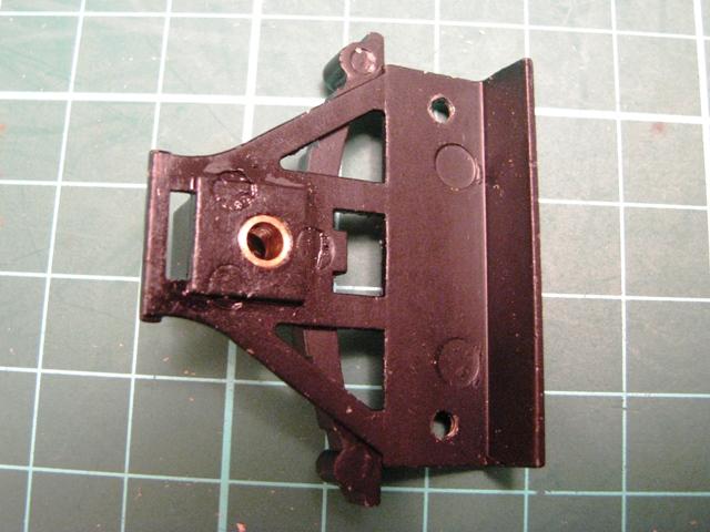

I notice that Accucraft axleboxes are available as separate items from suppliers such as Track Shack. I just wondered whether anybody had any experience of using these in scratch building projects?
The reason I ask is because I'm considering using a set of the W&L axleboxes for my sheep wagon project. However, I asked a friend to measure up one of his Accucraft W&L opens for me, and it transpires that the depth of the solebars is 13mm, which is overscale. I was intending to use 9.5mm solebars on my model, which is closer to scale, but presumably this means that the Accucraft axleboxes won't fit. If I fit deeper solebars, the floor height of the completed wagon will be too high.
So I was wondering how easy it might be to cut down or reshape the top section of the axleboxes, that tucks in behind the solebars?
Any advice gratefully recieved :)

The Accucraft axleboxes are much sharper cast than some white metal ones I've seen elsewhere.
As you say they are 12.5mm deep below the sole bar, but trimming them to 9.5mm should still allow the original mounting holes to be used. You should be able to trim them to size using a hacksaw & hand file.

At least some W&L solebars seem to have been 9 1/2" x 4" which scales out at 12.5mm in 16mm scale. I use the Accucraft W&L castings for my 3' gauge 4wheel wagons and use 1/2" x 1/4" wood for the solebars.
Best to get your wheelsets first, but I make my own and space the solebars at 61mm, which leaves about 0.5mm sideplay on the axles.

The axlebox castings are diecast zinc alloy with a brass or bronze bearing insert and the bearing is sized for a 3mm journal on the axle.
1/2" x1/4" scales out at the right size for a W&L solebar in SM45 and is also about right for Irish 3' gauge wagons in 15mm/ft scale, where it scales out at 10".
