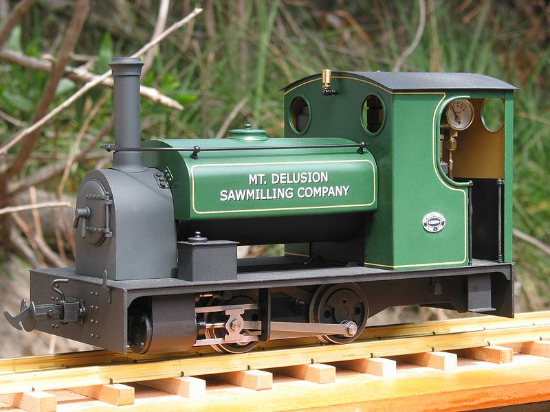

ps. this loco was lined in Humbrol with a bow pen, using a 6" plastic ruler for the straight bits, an OOO brush for the corners and a bow pen in a compass for the large radius curves.

GTB:105421 wrote: ps. this loco was lined in Humbrol with a bow pen, using a 6" plastic ruler for the straight bits, an OOO brush for the corners and a bow pen in a compass for the large radius curves.
Beautifully executed. I must have a go myself. I've used Trimline tape until now but never been entirely pleased with the results.
Is the lettering a transfer?

ge_rik:105451 wrote: I've used Trimline tape until now but never been entirely pleased with the results.
Tape always looks like tape. Like vinyl lettering, it has a visible edge that doesn't look right to me. I tried it once many, many years ago (Chartpak I think it was called), but wasn't happy with the results.
Yes, The lettering is a waterslide transfer, as is the builders plate.
I bought an ALPS printer just before they went out of production and print my own waterslide transfers. I've also used it to print lining panels, but only in HO.
