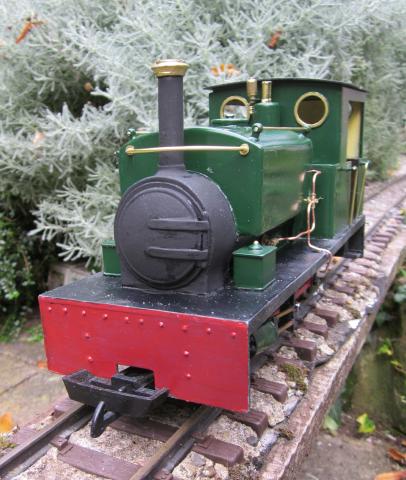

Recently put the finishing (is a project ever really finished??) touches to my latest loco build. Based (loosely) on the Manning Wardle 0-6-0 saddle tanks which operated on the Davington Light Railway, she's based on the Piko 0-6-0 motor block. Plasticard body, brass motion (with copper pipe fittings for the cylinders), powered by three 18650 lithium-ion batteries and controlled by a Deltang rx65 receiver controller.
While my Aussie friend was here we decided to give her a hauling test. I must admit I was quite amazed by her hauling ability given that I had very little room left to add weight after installing the batteries etc.
https://www.youtube.com/watch?v=rQs0dmT--1A
There's a blow-by-blow account of how I built her on my blog
http://riksrailway.blogspot.co.uk/2014/ ... 0-6-0.html
I'm afraid I'm more of a bodgeller than a modeller and I've included some of my more drastic mistakes in the hope that others will learn from them - I certainly have! One thing I've learned is that saddle tanks are not the easiest locos to build - side tank locos are a heck of a lot easier.
PS - Just noticed the roof is not fixed down properly - I still need to add a driver and a few more cab details - I also will be adding a sound card and tend to fix the speaker inside the cab roof before fixing that in place with clear Bostik (so it can be removed again if needed) - what did I say about a project never being finished??

What a nice smooth runner and very powerful by the looks of it.
I like the look of your rolling stock as well, more pics please :)

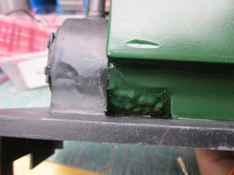

I don't think it's talent, I think it's more persistence. I maybe keep going when others may want to give up. On this build for example, when the tank, smokebox and bunker all started melting because of my over-enthusiastic use of Evostik to hold the lead weights in place I was quite philosophical.
It took me a week to fill, sand, fill, sand, etc but in the end it looked OK(ish). A perfectionist may shudder at the result and would probably have given up and started again (or maybe not). I just think of it as adding to experience.
