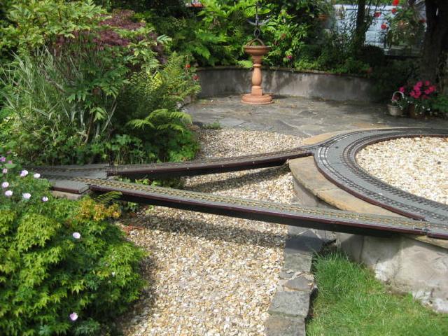

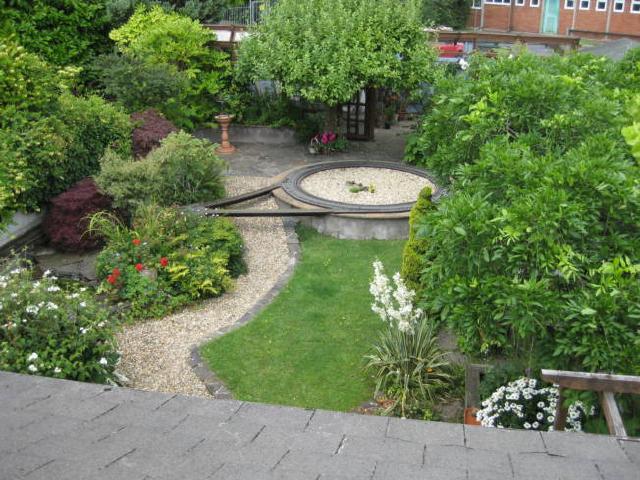

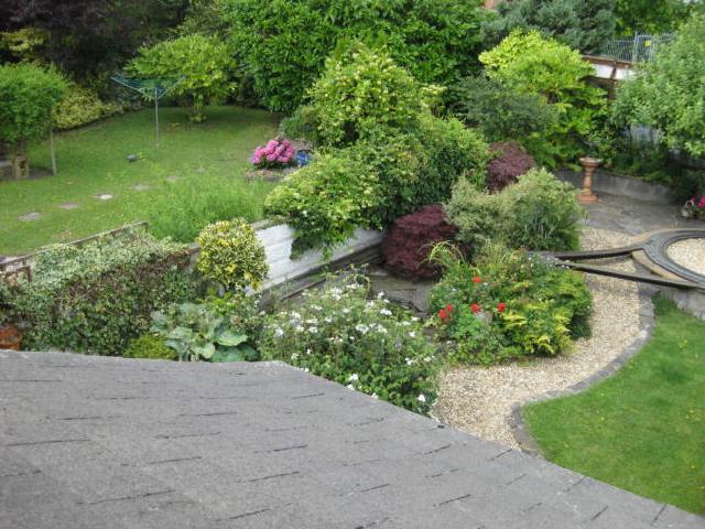

Two bridges made for the Rhydypenau Garden railway!
The end of the lines more boards needed to be made to make a return loop.
Regards tony.

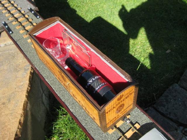

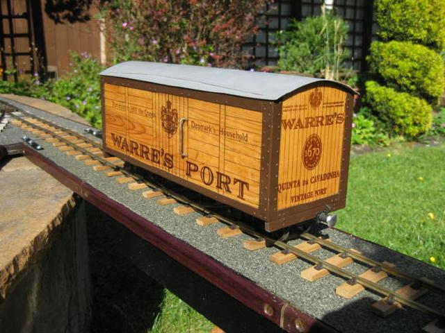

Post by Andrew » Mon Jul 28, 2014 10:21 am
Apologies for the late reply, but thanks for the Port wagon picture, absolutely fantastic. I'm guessing the sides and ends came from a box containing a bottle of the stuff? I may have to keep an eye out for something suitable to pinch your idea. The Port would be a nice bonus of course, mmmmm...

Post by Tony Bird » Mon Jul 28, 2014 3:07 pm
Hi Andrew,
Yes it is a Port wine box. The one end is made from the lid the other end is plain. both sides are the same.
I have two of these wagons the other is made from a Ernest & Julio Gallo wine box alas the lid was plastic so both ends are plain.
If you do make one some notes on how I did it might help? The boxes I worked on were held together with nails and the wood used in them was not very good and very porous. The boxes were taken apart very lightly sanded and were given a coat of dilute PVA glue (5:1) when dry another coat was applied. The second coat dry the parts of the box were lightly sanded and it was reassembled using glue and pins. The box was then painted with varnish, after a couple of days when the varnished was well dried the plank lines were added using a fine permanent marker pen when the maker ink was well dry another coat of varnish was applied. The PVA sealant, varnish and marker pen had previously been tried on part of the box that wasn't to be used. The corner irons which cover the boxes joints are folded card from a file folder glued on with track pins to simulate rivets added. The rest is pretty straight forward, just bogies and a removable roof.
