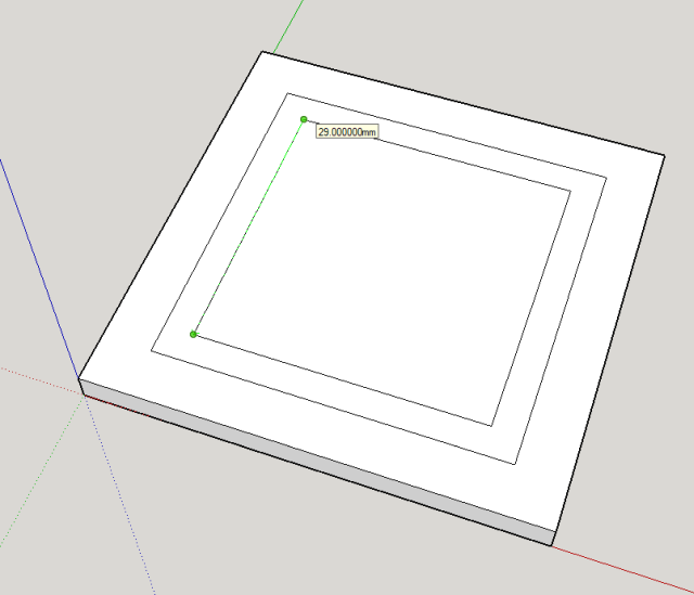

For comparison with Rik's Tinkercad Blog, I'll start by drawing roughly the same window frame.
First use the Orbit button to arrange the axes with the origin towards the LH side of your screen and the solid blue axis vertical and solid red axis running from L to R.
Next select the Shapes button to a draw a rectangle: position the Pencil on the origin, click and hold the Left mouse button and draw a shape to the right, then let go, the size doesn't matter because in the "Dimensions" box, now type "45,45" ( the comma is important ) and hit Enter. The shape you drew will change to a square 45 x 45.
Hit the "Zoom Extents" button and it will zoom in to fill the screen. Now use the Orbit tool to angle the square more towards you so that you have a reasonable view of the square.
Use the Select arrow button to select the top square by clicking on it anywhere and it will change to a speckled blu-ish colour, now use the PushPull tool to pull it up. Enter 3 into the box and hit enter. You now have a solid slab 45x45x3mm
NOTE: SketchUp can sometimes give unexpected results if you try to do several things on a 2-dimensional surface and then extrude them one at a time.
Select the top face of the square then click on the Offset tool, click on the edge of the square and a small red dot will appear, drag the cursor towards the centre and let go, type 5 into the Distance box and hit Enter. The new square will move to be a symetrical 5mm inside the outer border. Pick the Select tool and click anywhere outside the block to deselect everything.
OK, so now we have the outer frame of the window marked out and we need to start on the actual glazing frames, using the Offset tool as before. Start by selecting the inner square, then use the Offset tool to click on the border and drag inwards, release mouse, enter 3 into the box and Enter. A new square appears, 3mm inside the previous one.
Using the Tape Measure tool, click on one corner of the inner square, let go and move along an adjacent edge to the next corner, it should say 29.0000mm.
Now we need to add the central dividing frames, which should be 3mm wide to match the outer. So 29 -3=26mm, divided by 2 gives us two panes each 13mm wide. Using the Tape Measure tool, click on one corner of the inner square and drag along one edge, type 13 in the length box, hit Enter, and a small mark will appear on the edge at 13mm from the corner. Go to the corner at the other end and repeat. You should now have two Guide marks on the edge, 3mm apart. Repeat this for one of the other sides.
Select the Line tool ( pencil), place it on one of the guidemarks and drag it towards the opposite side. As long as you go in an apporoximately perpendicular direction it will maintain the line until you get to the opposite side and will draw an indicator line in the coour of the axis. ie. L-R it will be red, F-B it will be green. When the pencil gets to the opposite side a small box will pop up saying on "On edge", so let go and a black line will be drawn.
Repeat this for all four Guide points.
OK, nearly there! Using the Eraser tool, click on each of the lines that are closing off the ends of the inner frames.
Select the outer frame face, then use the Push Pull tool to pull it UP, 2mm.
Now, one at a time, Select the individual panes and using the PushPull push them DOWN by 3mm, the infill should disappear leaving the frame with 4 openings.
Now click the Solid Inspector (looks like a globe at the RH end of the toolbar) and it should say "No errors - All is shiny"!
Save your drawing and then part way down the File menu you should see Export STL.
Select that and export the file, then run it through your slicer...
Job done.
