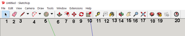

First though, a quick explanation of the buttons at the top of the screen. Hover your mouse over the icon at any time and a tooltip appears, but for reference this is the list:
Screenshot 2020-08-15 07.04.06.png (23.02 KiB) Viewed 137019 times
1) Select
2) Eraser
3) Lines - the adjacent down arrowhead allows for drawing either straight lines or freehand.
4) The Arc button has several variants accessed by clicking the down arrowhead to the side.
5) The circle or square Shapes draws that shape and also has a couple of other options under it's arrow.
6) PushPull -The rectangle with the up arrow on top is one that we'll use a lot and drags a face up, down or sideways to create or alter a 3-D shape.
7) The two arcs with a red arrow is the Off-set tool and we'll come back to that.
8 ) The 4-headed arrow is the Move tool and slides selected items around without affecting everything else.
9) The two arc shaped arrows Rotate a selected object. (This is a horrible tool to try to use and I avoid it as much as possible!).
10) The solid grey square inside a red square is the Scale button and is very useful at times.
11) Tape Measure has several functions, from simply measuring a distance on the drawing to setting guide points and lines, to actually resizing the object.
12 & 13) The next 2 buttons we don't need at this point.
14) The red and green swirl Orbit button is very useful and allows you to spin the entire drawing in any direction.
15) The hand Pans the drawing in any direction,
16) The magnifying glass Zooms in and out.
17) Extents - The magnifying glass with three arrows, automatically zooms the drawing to fit the window.
18) SketchUp 3-D Warehouse - not much use for our purposes.
19) SketchUp Extension Warehouse.
20) Solid Inspector2. This is not part of the default tool set but needs to be downloaded from the Extension Warehouse. It is not infallible but is a useful tool for looking for errors in the drawing. Download and install it and this new icon appears on the toolbar. Then at any point in a project just click the icon and a window will pop up indicating errors. Download from: https://extensions.sketchup.com/search/ ... 0inspector

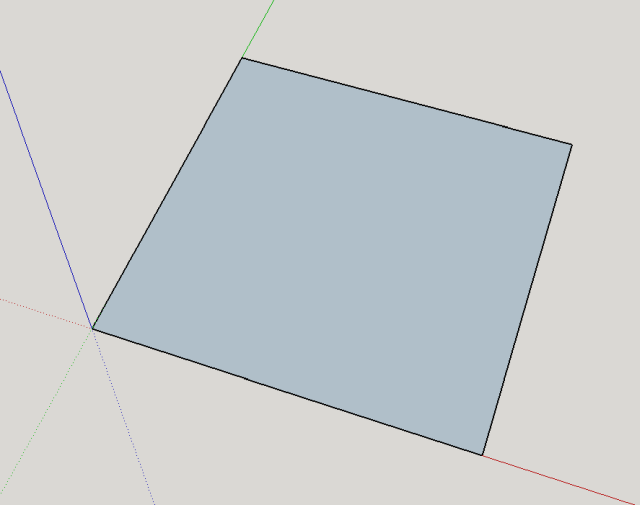

Next select the Shapes button to a draw a rectangle: position the Pencil on the origin, click and hold the Left mouse button and draw a shape to the right, then let go, the size doesn't matter because in the "Dimensions" box, now type "45,45" ( the comma is important ) and hit Enter. The shape you drew will change to a square 45 x 45.
Screenshot 2020-08-14 16.30.11.png (2.23 KiB) Viewed 136993 times

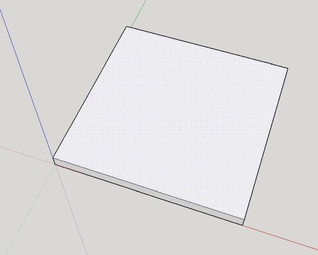

Use the Select arrow button to select the top square by clicking on it anywhere and it will change to a speckled blu-ish colour, now use the PushPull tool to pull it up. Enter 3 into the box and hit enter. You now have a solid slab 45x45x3mm
NOTE: SketchUp can sometimes give unexpected results if you try to do several things on a 2-dimensional surface and then extrude them one at a time.
Screenshot 2020-08-15 14.03.25.png (86.49 KiB) Viewed 136993 times

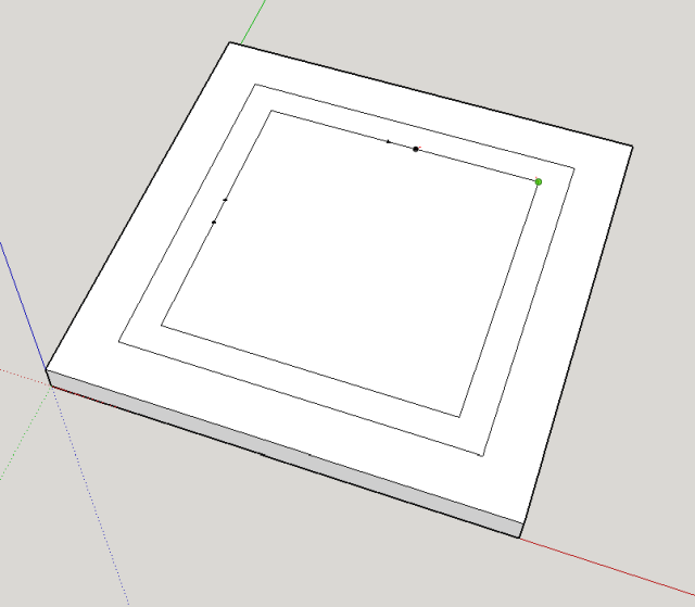

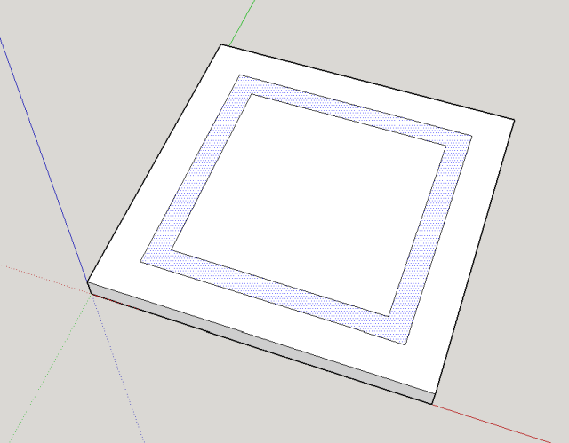

Select the top face of the square then click on the Offset tool, click on the edge of the square and a small red dot will appear, drag the cursor towards the centre and let go, type 5 into the Distance box and hit Enter. The new square will move to be a symetrical 5mm inside the outer border. Pick the Select tool and click anywhere outside the block to deselect everything.
Screenshot 2020-08-15 14.09.20.png (100.07 KiB) Viewed 136993 times

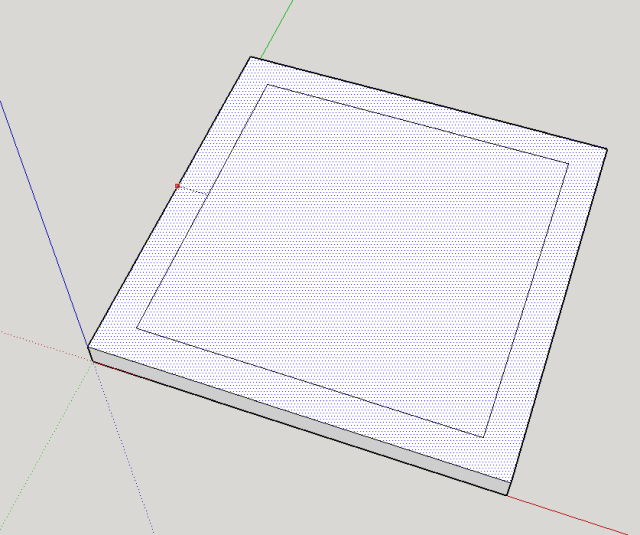

OK, so now we have the outer frame of the window marked out and we need to start on the actual glazing frames, using the Offset tool as before. Start by selecting the inner square, then use the Offset tool to click on the border and drag inwards, release mouse, enter 3 into the box and Enter. A new square appears, 3mm inside the previous one.
Screenshot 2020-08-15 14.15.14.png (61.9 KiB) Viewed 136993 times

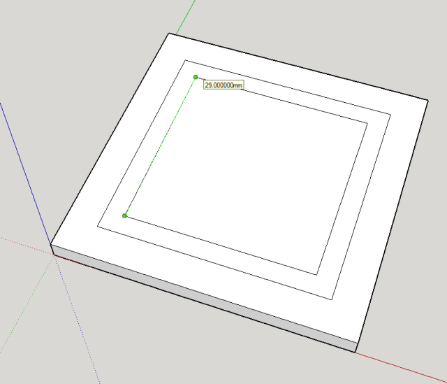

Using the Tape Measure tool, click on one corner of the inner square, let go and move along an adjacent edge to the next corner, it should say 29.0000mm.
Screenshot 2020-08-15 14.17.23.png (47.05 KiB) Viewed 136993 times

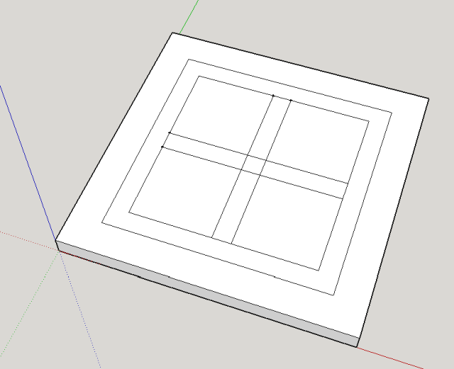

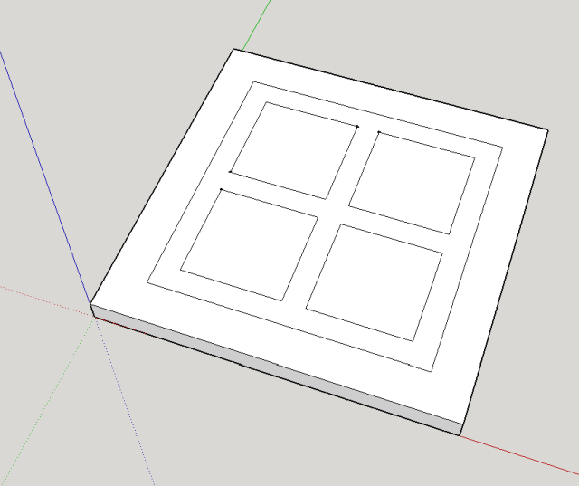

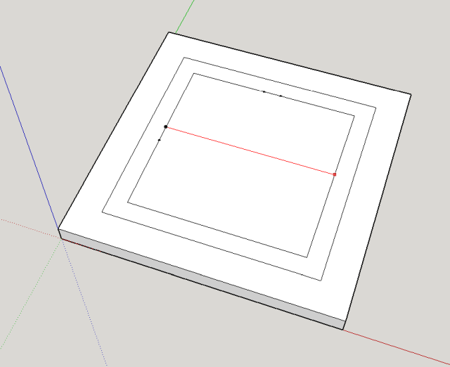

Select the Line tool ( pencil), place it on one of the guidemarks and drag it towards the opposite side. As long as you go in an apporoximately perpendicular direction it will maintain the line until you get to the opposite side and will draw an indicator line in the coour of the axis. ie. L-R it will be red, F-B it will be green. When the pencil gets to the opposite side a small box will pop up saying on "On edge", so let go and a black line will be drawn.
Screenshot 2020-08-15 14.24.42.png (45.29 KiB) Viewed 136993 times
Repeat this for all four Guide points.
Screenshot 2020-08-15 14.28.08.png (51.43 KiB) Viewed 136993 times

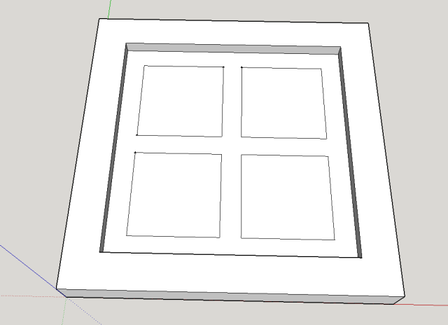

OK, nearly there! Using the Eraser tool, click on each of the lines that are closing off the ends of the inner frames.
Screenshot 2020-08-15 14.30.55.png (50.18 KiB) Viewed 136993 times

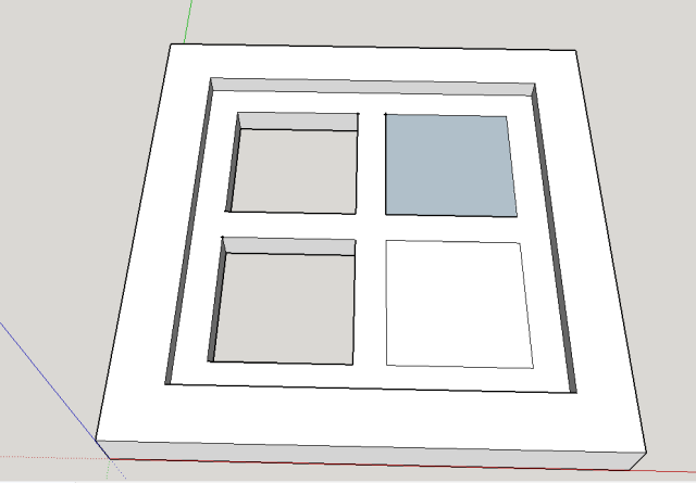

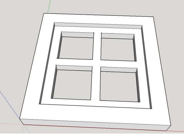

Now, one at a time, Select the individual panes and using the PushPull push them DOWN by 3mm, the infill should disappear leaving the frame with 4 openings.
Screenshot 2020-08-14 18.21.31.png (21.41 KiB) Viewed 136993 times
Screenshot 2020-08-14 18.22.17.png (26.63 KiB) Viewed 136993 times

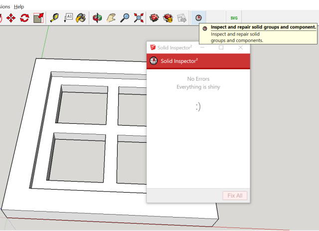

Now click the Solid Inspector (looks like a globe at the RH end of the toolbar) and it should say "No errors - All is shiny"!
Screenshot 2020-08-14 18.42.47.png (45.6 KiB) Viewed 136993 times

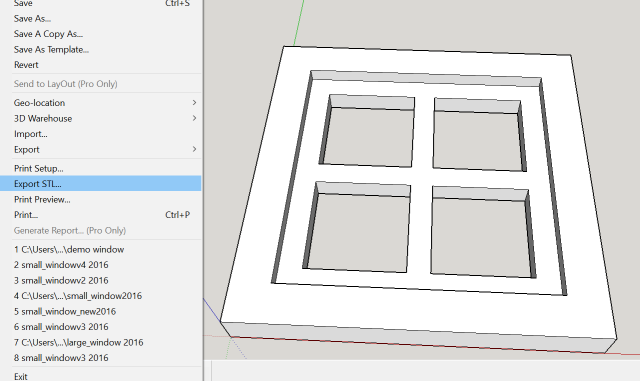

Save your drawing and then part way down the File menu you should see Export STL.
Screenshot 2020-08-14 18.54.56.png (42.1 KiB) Viewed 136993 times

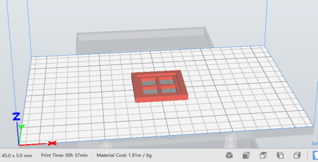

Select that and export the file, then run it through your slicer...
Screenshot 2020-08-15 14.42.33.png (71.35 KiB) Viewed 136993 times
