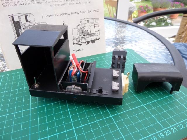

Recently I purchased a box labled 16mm narrow gauge from a collegue at
my local model railway club. It wasn't a completely blind purchase as I had spotted at least seven Big Big Trains tipper wagons in their boxes. After the purchase I had the chance for a good rummage and found a partially completed Saltford Models kit of a Simplex loco. It looked as if it could be set up to work on radio control using the space that the kit instruction said to use for 4 AA batteries. I already had a spare Deltang receiver and purchased a Zippy 350mah 7.2 volt LiPo battery which fitted the space nicely. The attached video shows it first outing on the OVLR and climbing the 1:40 incline that is part of this years extention programme. It wasn't the first loco onto the new level but it certainly was the first train.

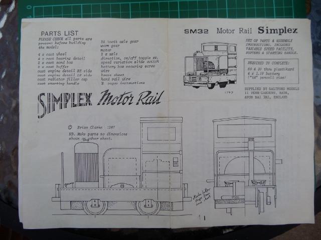

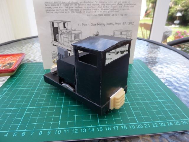

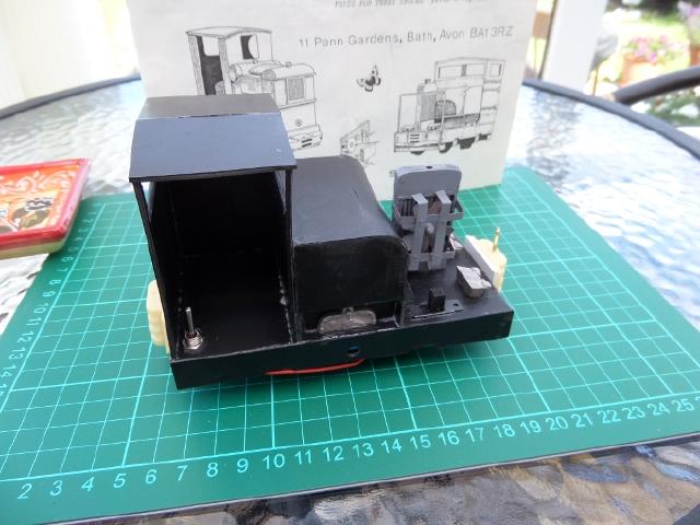

Still a work in progress at some time I must change the 7mm scale wheels he used.
Saltford Models drawings
The model is built of 60 thou and 30 thou styrene sheet.
