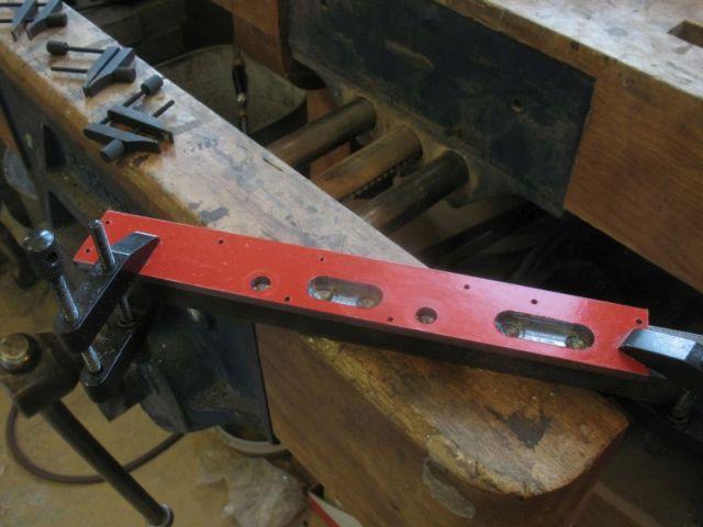

Well taking the plunge on following Dave's drawings I did not have any steel of the stated thickness as raw stock.
I did however have a pair of old Ikea shelf brackets that were close enough thickness wise, so I cut them up to make a start.
The spacer blocks are from some 1/4 inch black anodized aluminum that I had laying around.
The hex bolts are 1x72 made out of some 1/8th brass hex stock I have a fair bit of.
The copper pipe is 1 1/2 inches in diameter.
Mike

Progress has slowed down a little now that Sailing season is in full wind (we have a very short season here end of May to end of September, before the lake freezes)
Click to see full size image
I might redo the wheels I made the flanges a bit shy of the dimensions in the drawings.
Mike
