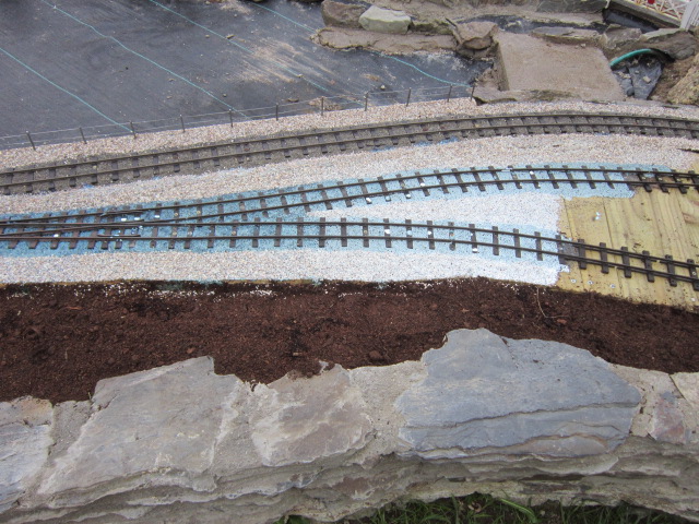

It has been two years since my addition to this thread told of my use of horticultural grit bonded in place with SBR. Since then I have explained elsewhere that it didn't work out as well as expected and has now been removed and replaced with another material. I found that the grit was too large to be held in place as any material has to be completely coated with the SBR to hold position.
My current preference is a fine grit available from builders merchants, although I can't offer a name as it was gifted to me and I have no idea what it is called. However, it is a medium grey colour and is graded from 1.5mm (approx) to dust and is perfect for both adhesion and appearance.
It is important to cover the ballast once in place to allow it to set. I try to protect against rain for a minimum of 5 days, even so it will show discolouration if it gets wet but stays in place.
This shows my latest area of ballast which, as you can see, is soaked in neat SBR and is currently under tarpaulin to set.
